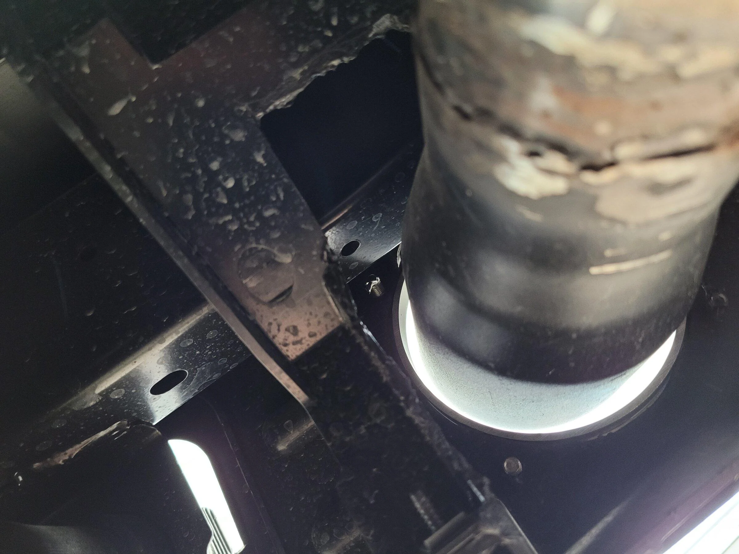

It's really hard to tell what this picture is, but I was trying to show the bracket. I saved the side closest to the middle of the bumper and trimmed away clearance around the tip. I orginally saved both sides but one was so thin I cut it off. Now it is second cat delete with resonator and then muffler and tip.

Show a pic of your cat delete?
