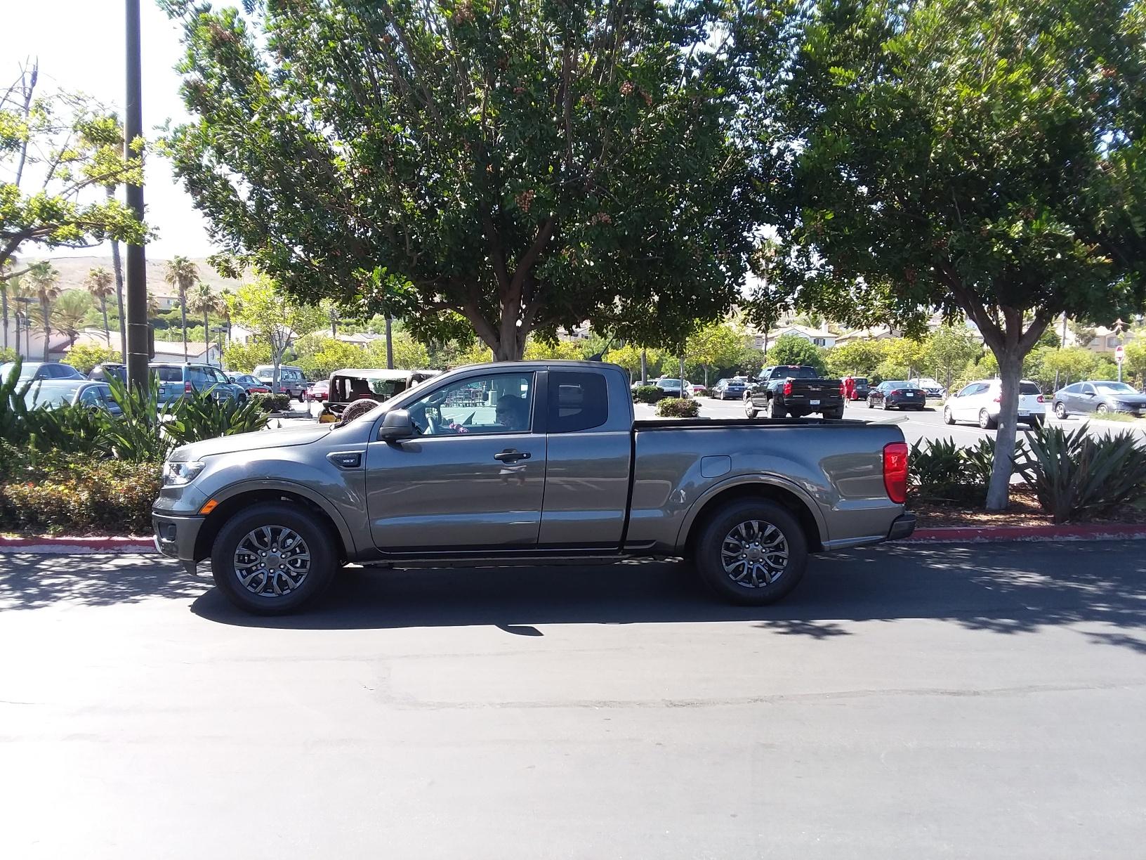

Looks great! Hopefully the spring manufactures will see your truck for inspiration.
Ford Maverick H&R Lowering Springs Installed From Escape w/ Part Number & New Pics Resized_20200709_153001_3522
