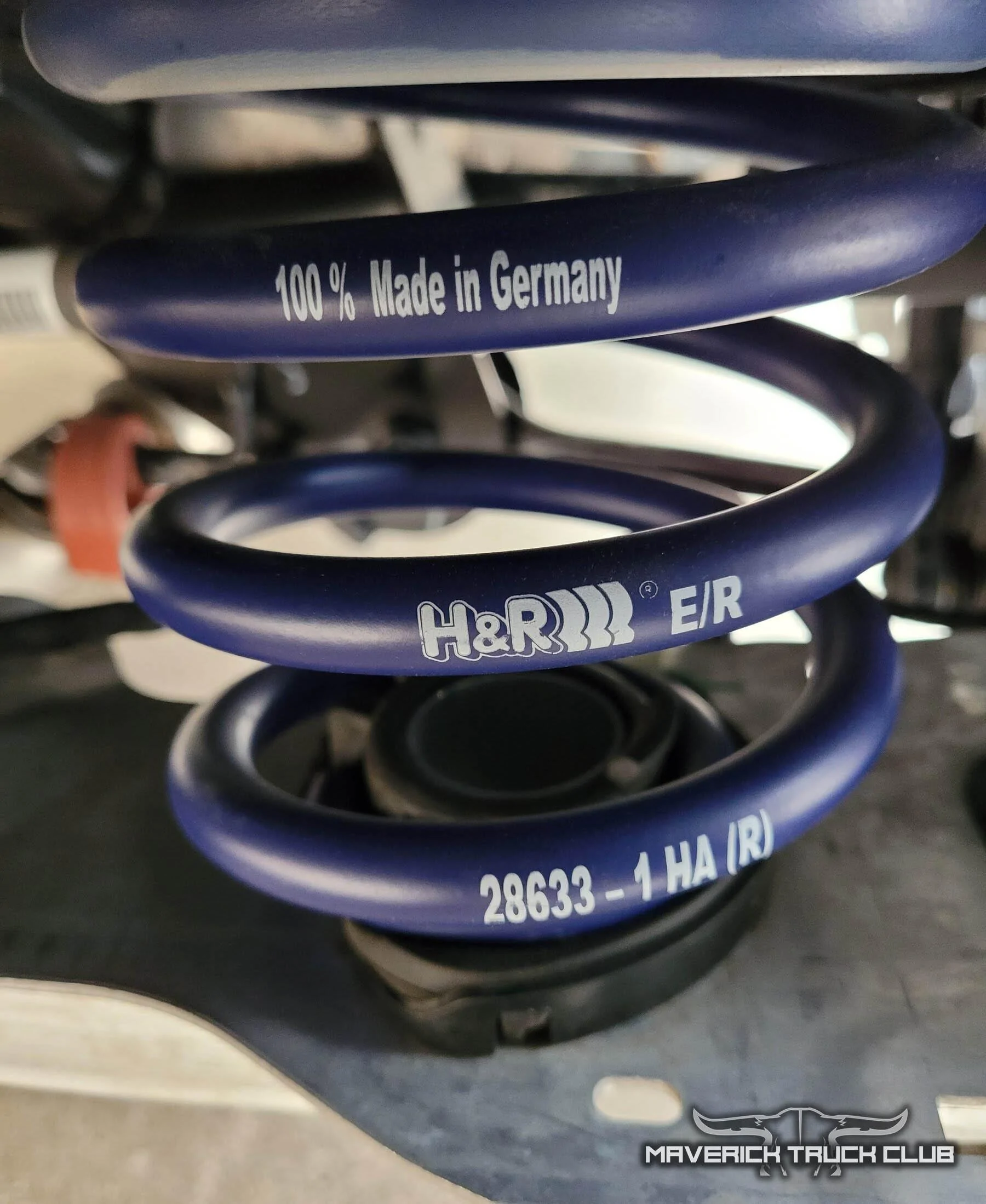

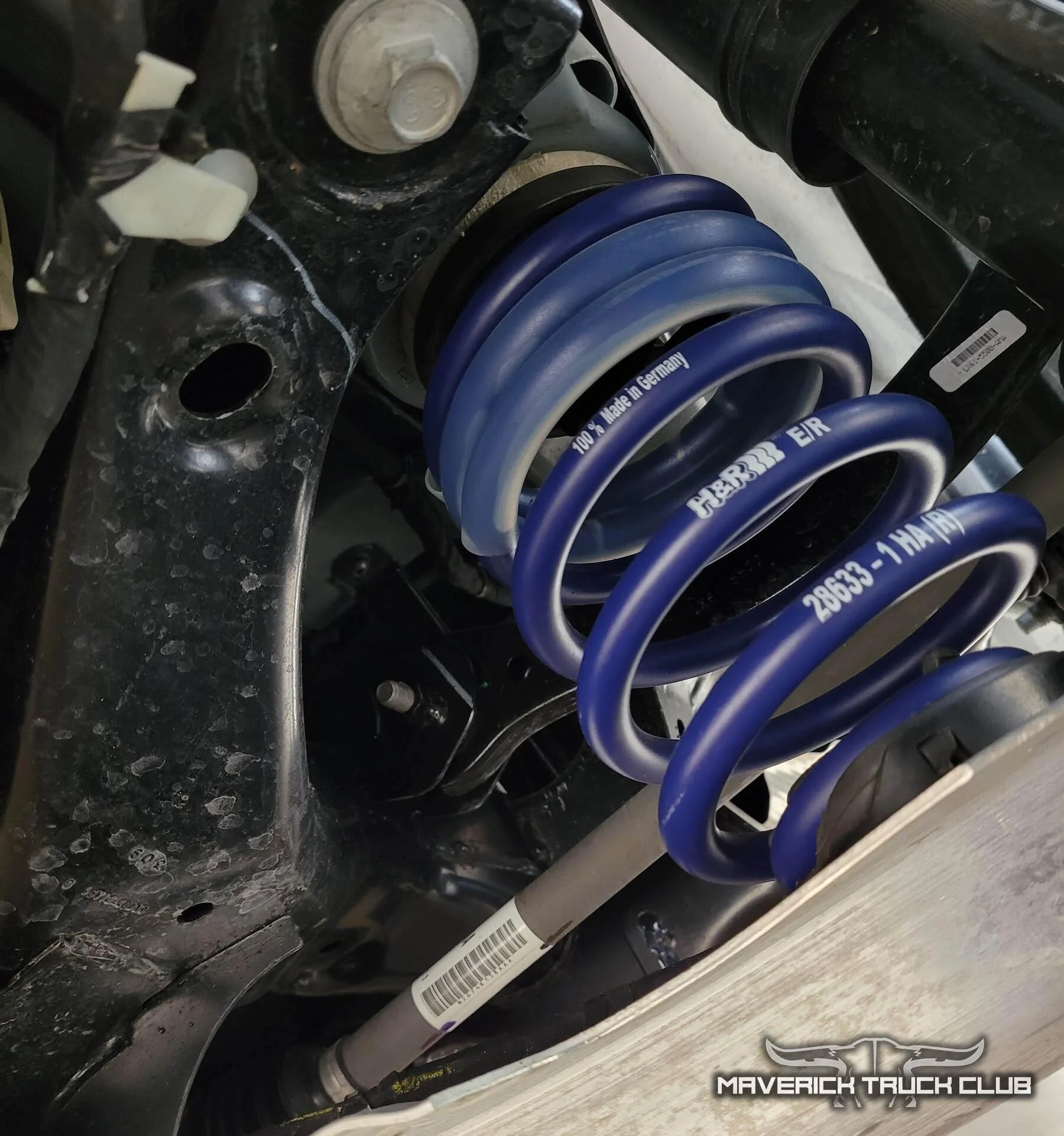

Just finished installing some Escape lowering springs. They lowered about 2 and 2.5. I'll get some daytime pics this weekend. BTW the Escape 14mm camber bolts are also a go.
Update w/ more info and Q&A:
Part description and #:
Escape springs '20 to '22, AWD. Part # 28633-1
The ride is only slightly more firm than stock. The wheels are 20x8.5 et45 with 255/50. They did not rub before and so far I don't think they are rubbing now. I did have to add a 1/2 spacer above the rear spring seat to get the stance the way I wanted it. The springs the way they came made it perfectly level. 32" ground to fender on all four. So now it's 32 on the front and 32 1/2 in the back.
I took my stock steel wheels off at 38 miles and sold 3 as spares to members here, so I don't know what stock ride is like. The small amount of extra firmness is relative to the springs only. It's not annoying, but in hyper check out mode I noticed it.
Not on the bottom of the spring, on the top. The bottom (plastic & rubber) perch has a pin to prevent rotation around the raised metal part of the spring perch. The top metal perch is a bit longer than an inch and only has a rubber isolator. I had an old nylon cutting board I cut using the rubber isolator as a pattern and snapped it over the bulge on the upper metal spring perch. The stock springs are wound in opposite directions. The H&R springs are wound in the same direction. The upper isolators are symmetrical. So the drivers side went right in and the top of the passenger side, but I had to modify the passenger rubber isolator. I used a small grinding bit in a drill to remove a hump and shape the isolator for a spring wound opposite. I could have just bought a driver side lower perch but the pin would have been in the wrong place.
frame
nylon spacer
rubber isolator
spring
rubber isolator
plastic perch
lower control arm
Escape springs '20 to '22, AWD 28633-1

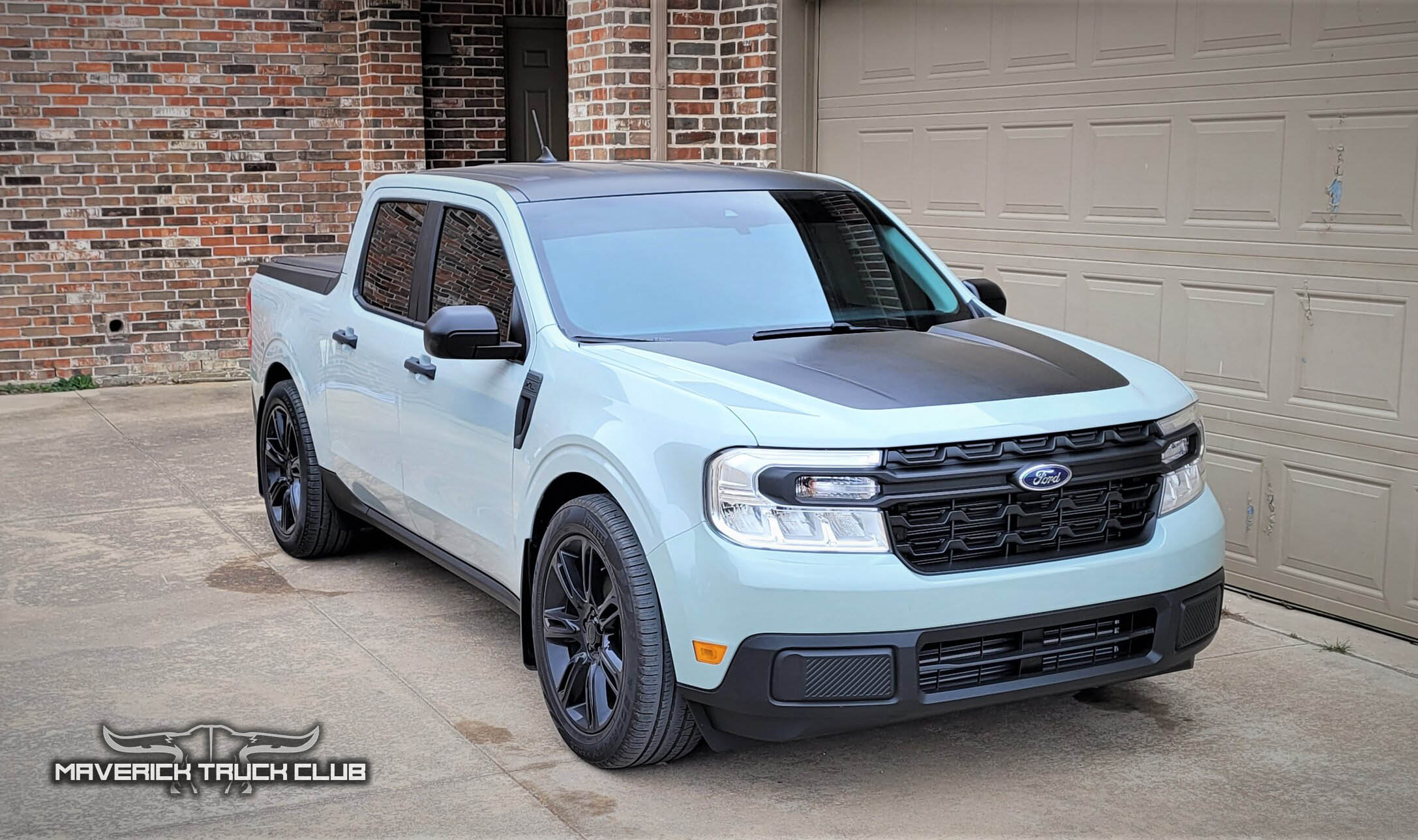

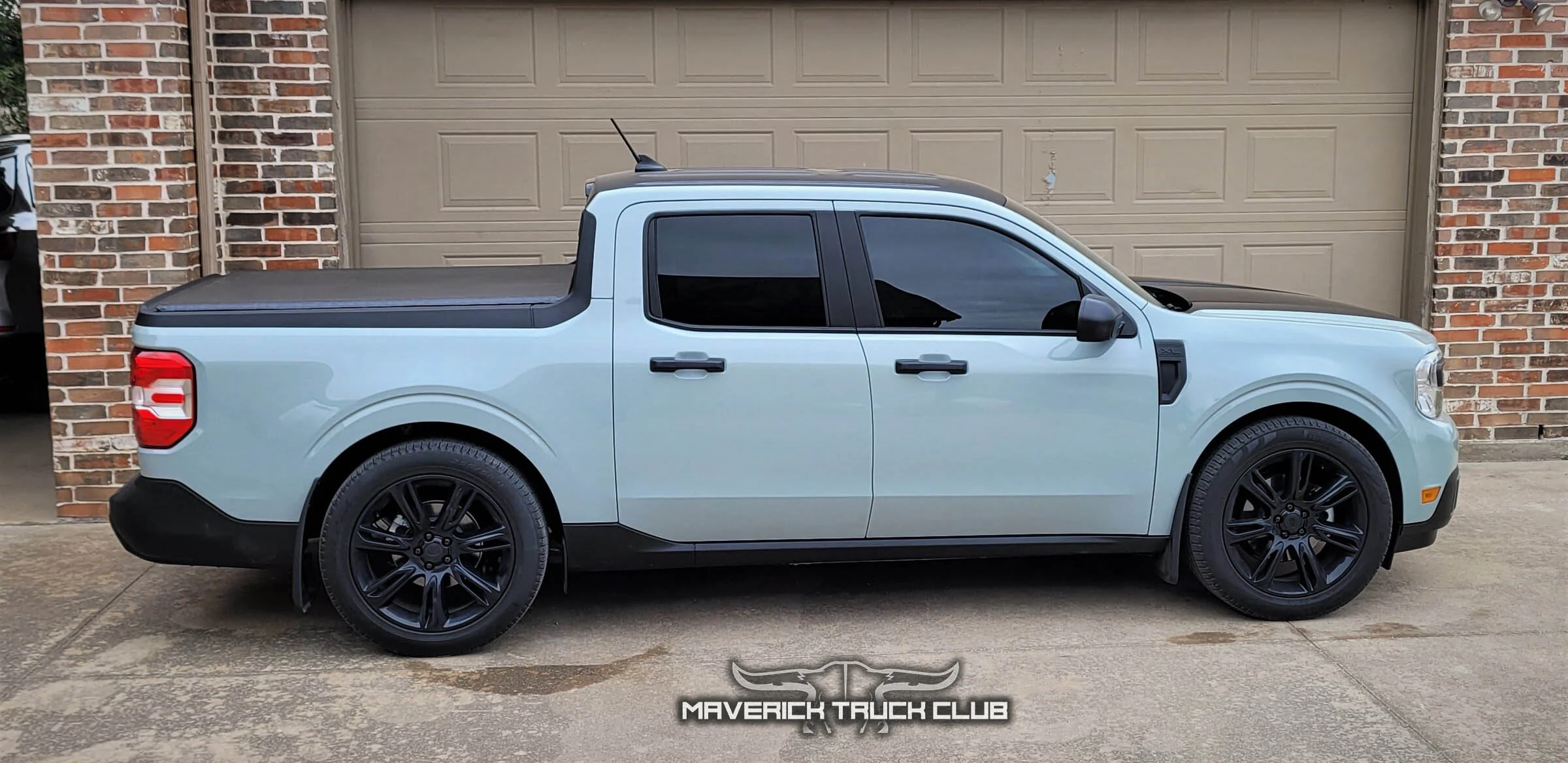

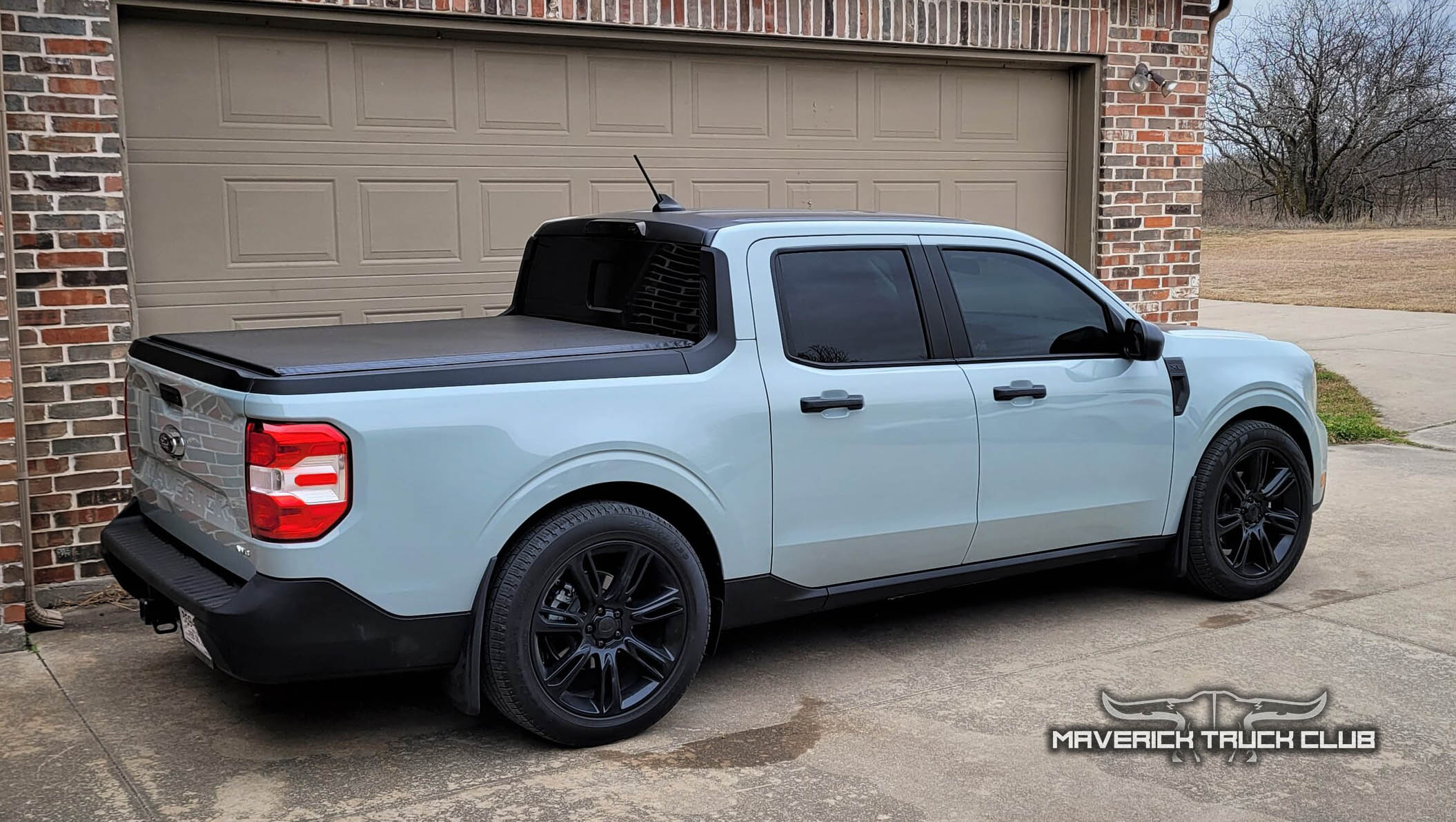

Yes, I had it all together and drove it a couple of miles and decided to come up with a plan to make the rear just slightly higher. The track width of the front and rear of the maverick are different and the rear looks lower when it's exactly the same height.
I usually do my own alignment. The lowering didn't really affect anything, but I didn't measure it before I started adjusting. I set the front camber -1, rear camber -.8, rear toe 1/8" in, front toe 1/8" out and left the caster alone. I will drive it a while and see how I like it. Make any adjustments. Then take it to a shop and have it confirmed and equal it out if there are any differences side to side.
3m flat black vinyl
I just used photo editor to lighten the picture because "puts black wheels on and takes picture at night"
I'll get some daytime pictures.

Ok, I got some quick pics. Spring pics are on passenger side.
My Maverick is AWD 4K XL 360.
What "I think" I know about the AWD springs. Installing springs the way I did, the 28633-1 will be the lowest, then the 28633-2 will be a little less low, then the stock Escape springs will probably be very little lower. My lowering was a risky experiment that happened to work out and I'm thrilled it did. I've always been a do-it-yourselfer. If the top spring mount in the rear is the same on the 2WD and the lower plastic and rubber perch is the same, I don't see any reason the same springs would not work.
The fronts are probably as low as one can go with the stock struts. There is very little preload on the H&R springs with stock struts.
I'm happy to answer any questions.
Thanks for all the positive feedback!

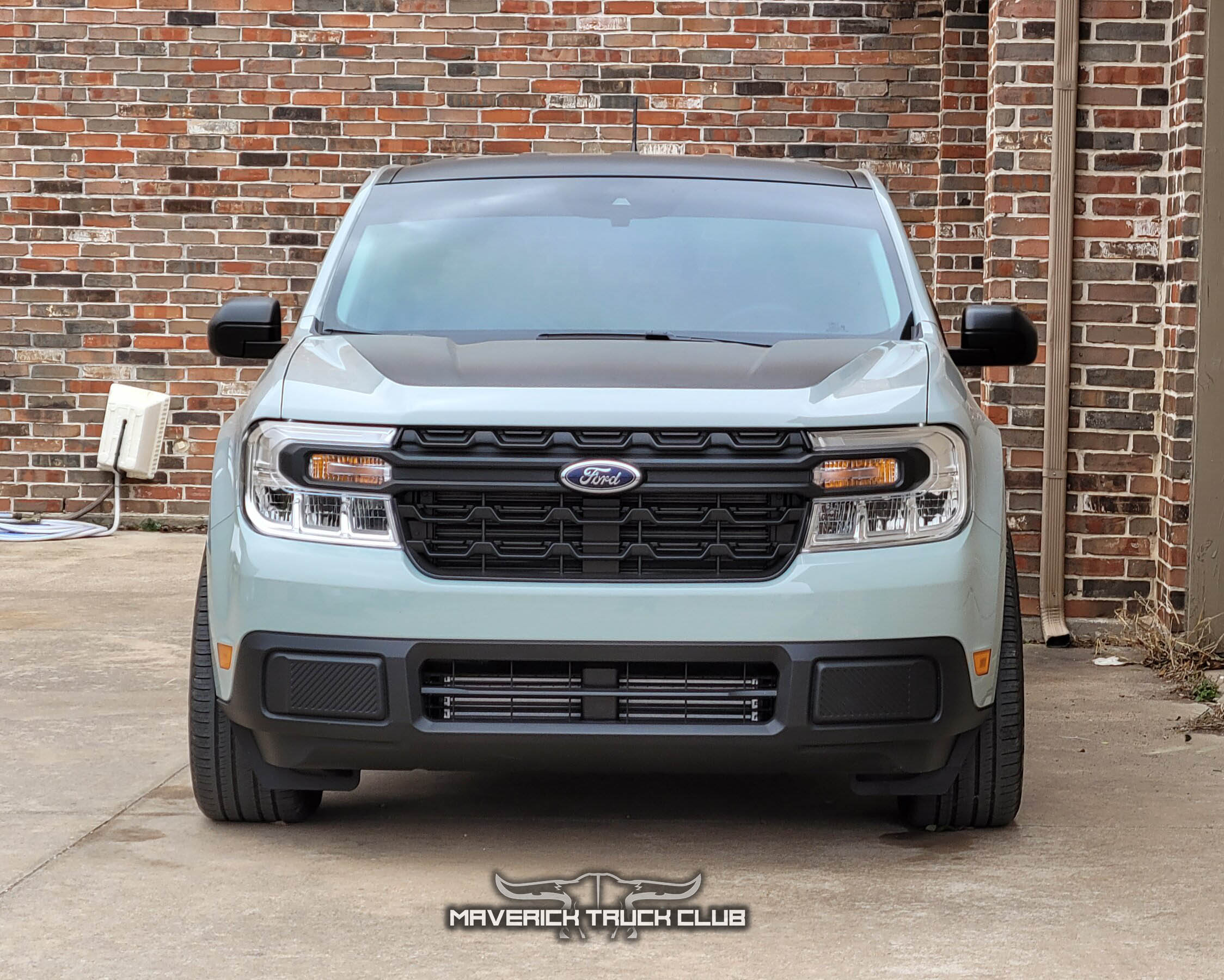

Thanks! While I imagine the handling is going to rock, I'm a little concerned with tire life with that much negative camber. Is it just the picture, or has an alignment shop measured that yet?
I did this alignment in the garage after the install. I usually refine the alignment as I prefer sporty turn in and some ability to induce oversteer, then once I like it I'll take it to a shop and have them measure it on a machine and equalize side to side and make some minor adjustments. Now (manual method) it's supposed to be -1 degree. The photo does look like about 1.4 so it could be a bit much.
