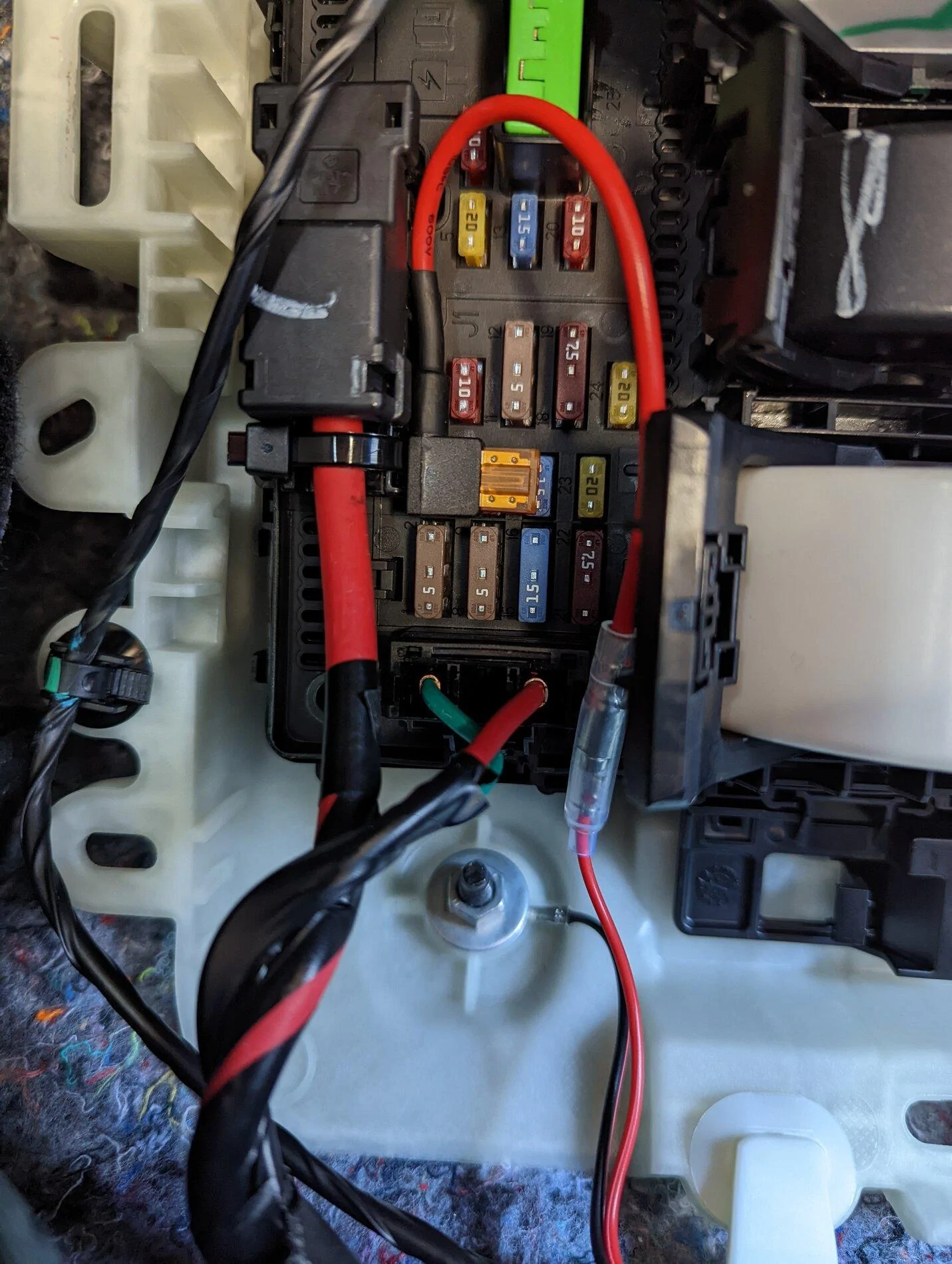

If you’re looking for an always on fuse, #5 or #24 appear to be available based on discussions above in this thread. I haven’t tried either yet.
Hoping someone who used them or tested can say which way the tap needs to be oriented in either of those slots as I haven’t gotten around to testing them.

Do you know which orientation the fuse tap needs to go for #24? Thinking about using it for my dashcam but haven’t gotten to testing it yet.
#24 technically bottom leg is the line, but you cannot fit the orientation the “correct” way for that — BUT, it actually doesn’t matter for #24 since the system does not use any power on that fuse, so there won’t be multiple loads going across the original 20amp fuse.
In other words, my dashcam power (when in parking mode) runs across both the original 20amp fuse, and also my added 5 amp fuse. It’s redundant, but no problem. There is no additional system load going across the 20 amp fuse.

Correct, these are ignition-only from when I tested:
1-2 (micro3)
8-9 (micro3)

Dropping back in to confirm #3 and #24 worked for my BlackVue 590X with parking mode! Thanks for the help!

@clavicus is the GOAT. I hardwired my A129 Pro today using all of the information he provided. I’m using 1-2 (micro3) and 24 (micro2) Thank you so much.
