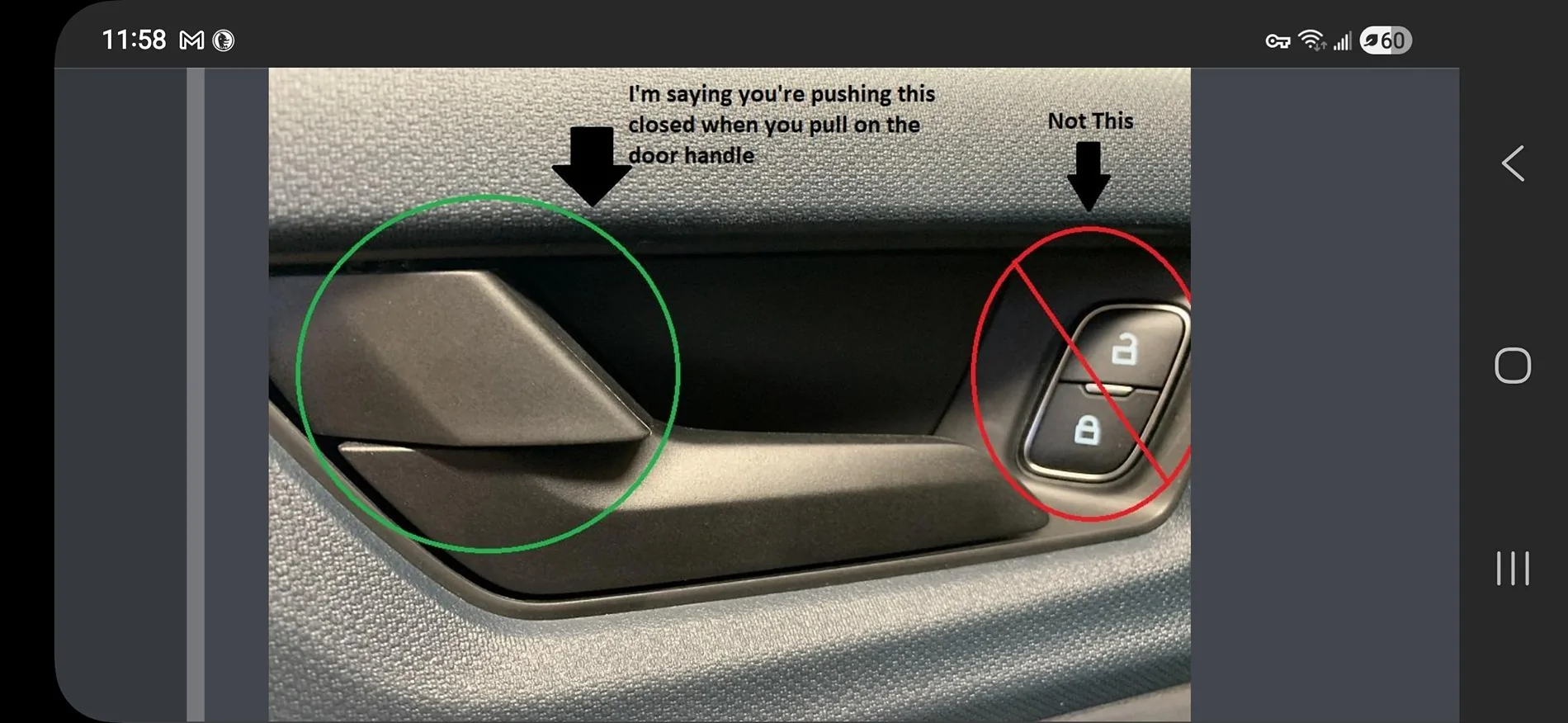

Interestingly, I have found mine locks the driver door if I walk away with the fob left inside, but not the back doors?

Welcome to the forum. The truck does not have the ability to electronically lock just one door. You are hitting the manual lock lever as part of either opening the door with the latch or pushing the door open. @Glen Baker LLC should be along with a helpful image shortly. :wink:

Aha, that explains it. Didn't even realize that manual lever was there?! lol

Glen is busy it seems, so this one pic works for anyone else that has the driver door only is locked suddenly.
