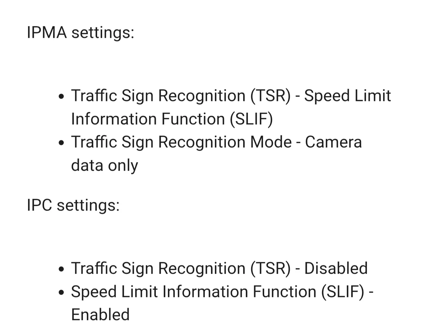

do you have the settings you used to get the traffic signs to work with your lane assist ? I put a king ranch cluster in and I can't get them to work together for the life of me, I tried the "easy mode" as well as "As is" I think it's 720-03-02 ? can you send me your settings, please
I'm getting ready to trade my truck in, so I took that cluster out. But I did it through the easy menu and I think these are the instructions I followed. I had it enabled on the stock cluster and just copied that as built data to the explorer cluster and I don't remember having to change anything with the traffic sign recognition stuff.
Ford Maverick Gear display in the instrument cluster Screenshot_20260531_185001_Samsung Browser
BriBout
Brian
Nov 10, 2023
Jamestown, TN
2024 XLT AWD EB FX4 4K
