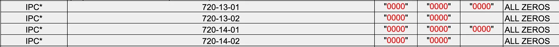

The point of this thread is that Forscan has nothing to say about the two IPC sizes, Livinitup, has nothing and your valuable spreadsheet does not comment on it. I am just trying to better understand what the options are really doing. Like what is the difference between a Minder and a Monitor. I also scrolled through all the BCM options and I could not find the 6.5/4.2 distinction either. Why are there 3 1s in Alternate #2; 3rd row seating? Driver, Passenger, Back? I am not sure.
The only thing I have broken so far is that I no longer have the Seatbelt idiot light. Not even during the idiot light test at RUN position. I am not quite sure why.
EDIT (23 May): Figured it out with lots of paper and cross checking various user on here including @mar.neumann @GotMojo @Mabcim and @Livnitup. Makes no logical sense but the 3 1s represent changing the configuration of the 3 back seats from MONITOR to MINDER. Still don't what distinguishes a MONITOR from a MINDER, nor why the back seat configures = the front seats behavior. Got the idiot light back which is fine. Not sure why it disappeared as I have only changed the Market stuff. Idiot ligh might have something to do with my failed guess to change the 2 fronts MINDER to match back MONITOR.
Research Only, no change or confirmation about what it does. Only change so far is to change the Seatbelt Warning Market from USA to Europe. It has the desired effect of delaying the chime until about 12 MPH but no effect on IPC screens. It may have an unexpected side effect in that on my singular test, the Back seat triggered nothing. No warnings on screen/no chime at any speed. No change to the the actual 720-13,14 codes. SWM manipulates 720-01-02 only; 0=USA 2=Europe.
