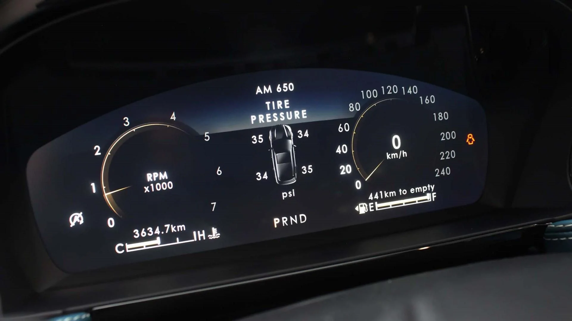

And there's always the Lincoln Corsair cluster option. We often forget about the other member of the Escape/Maverick family.
Ford Maverick Full digital gauge cluster from Ford Escape swap into Maverick 11ab04f1ee517a4ed7664157fafa2c3994a09f87

Ordered a 2020 Escape Titanium full digital gauge cluster and plugged it into my maverick, and it worked instantly. No need to do any programming to get it working, however, I'm getting a ton of fault codes from not having a lot of things that the top model Escape has vs my XL Maverick.
I will keep this as updated as I can, but at this moment the biggest issue I've ran into, is the gas gauge is only capable of showing half tank. I had quarter tank when I put the cluster in, and the new cluster was showing an 8th tank. When I filled the truck up, it was showing half tank, and I know it was full.
I just did some research, it looks like the corsair uses a different plug. Unfortunately.
There goes my afternoon plans to hunt one down. Thanks for looking into it so quickly! +1
