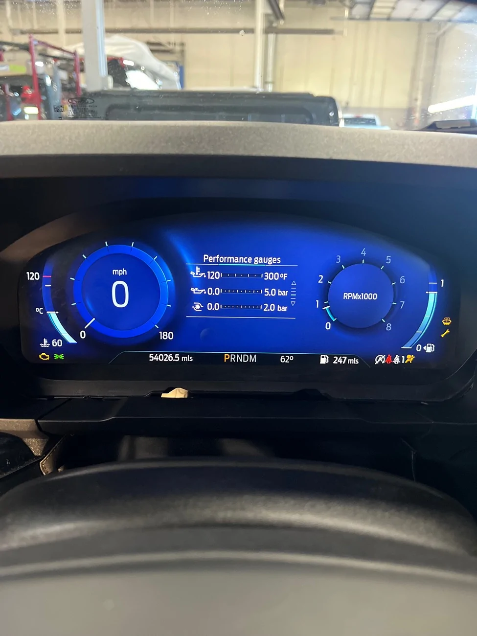

How do I get pass the security key? I bought a 2022 focus st digital cluster… bolts in okay the alignment pegs line up with the bolt hole so the bolt are on the outside and only trimming was on the surround plastic and little bit of a dash brace.
