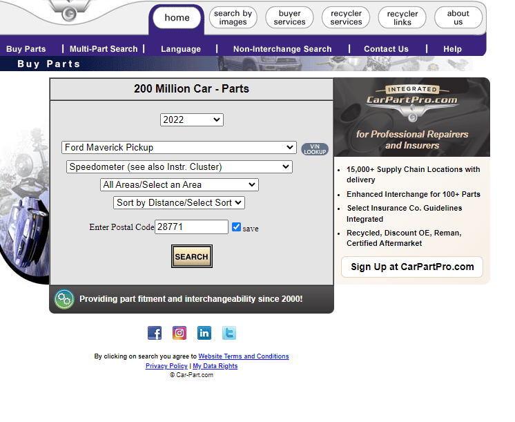

I had the same issue and eventually using "Speeedometer" in the part dropdown was the answer. Try using these search settings.

Yeah they do. Seach like this:
Ford Maverick Swap XLT/XL Guage Cluster for Lariat Digital Cluster 1710135459333

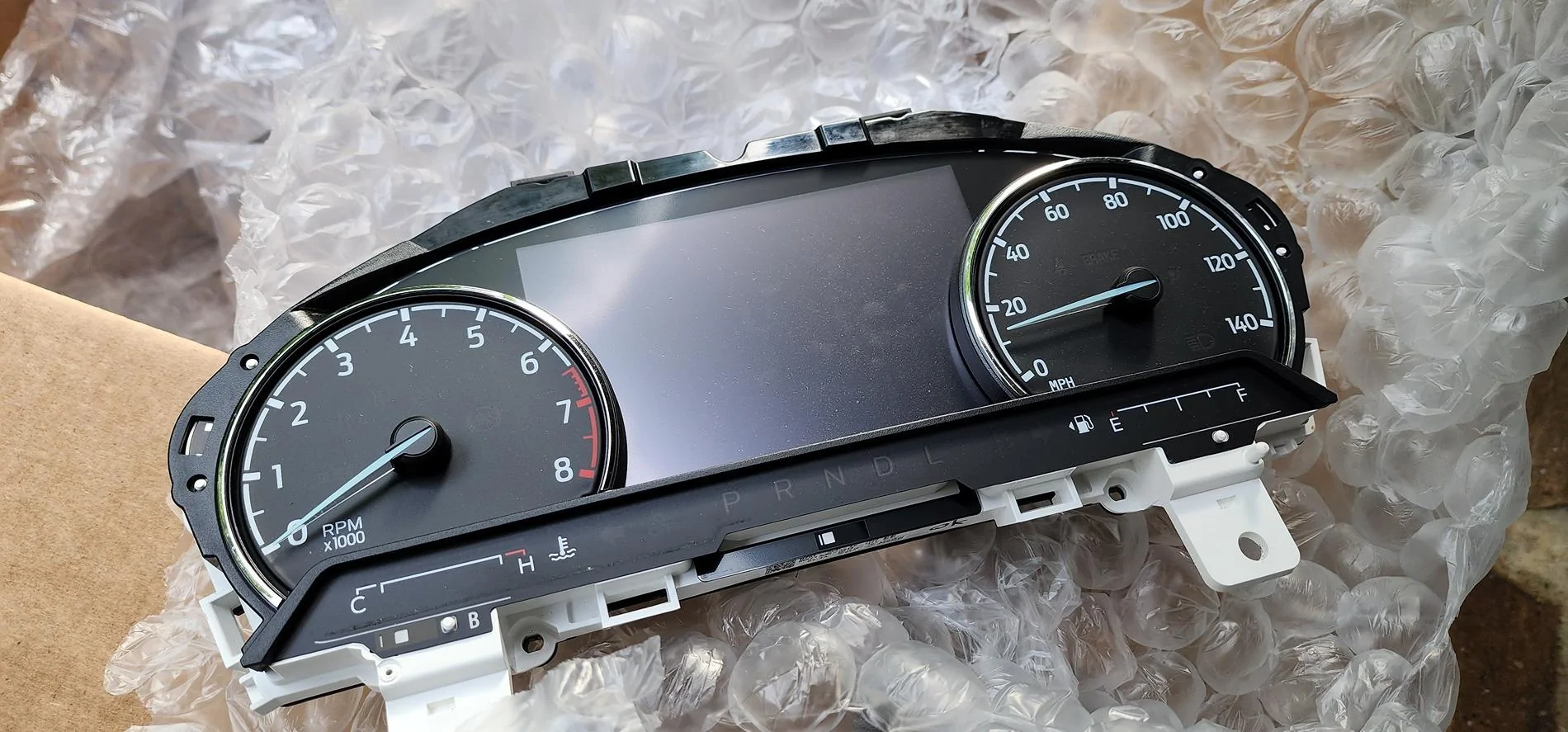

Fresh from the junkyard, I finally found a cluster very close to my trucks mileage.
What can I use to clean the junkyard dust from this thing? I expected it to come with the clear plastic shield but no dice.
