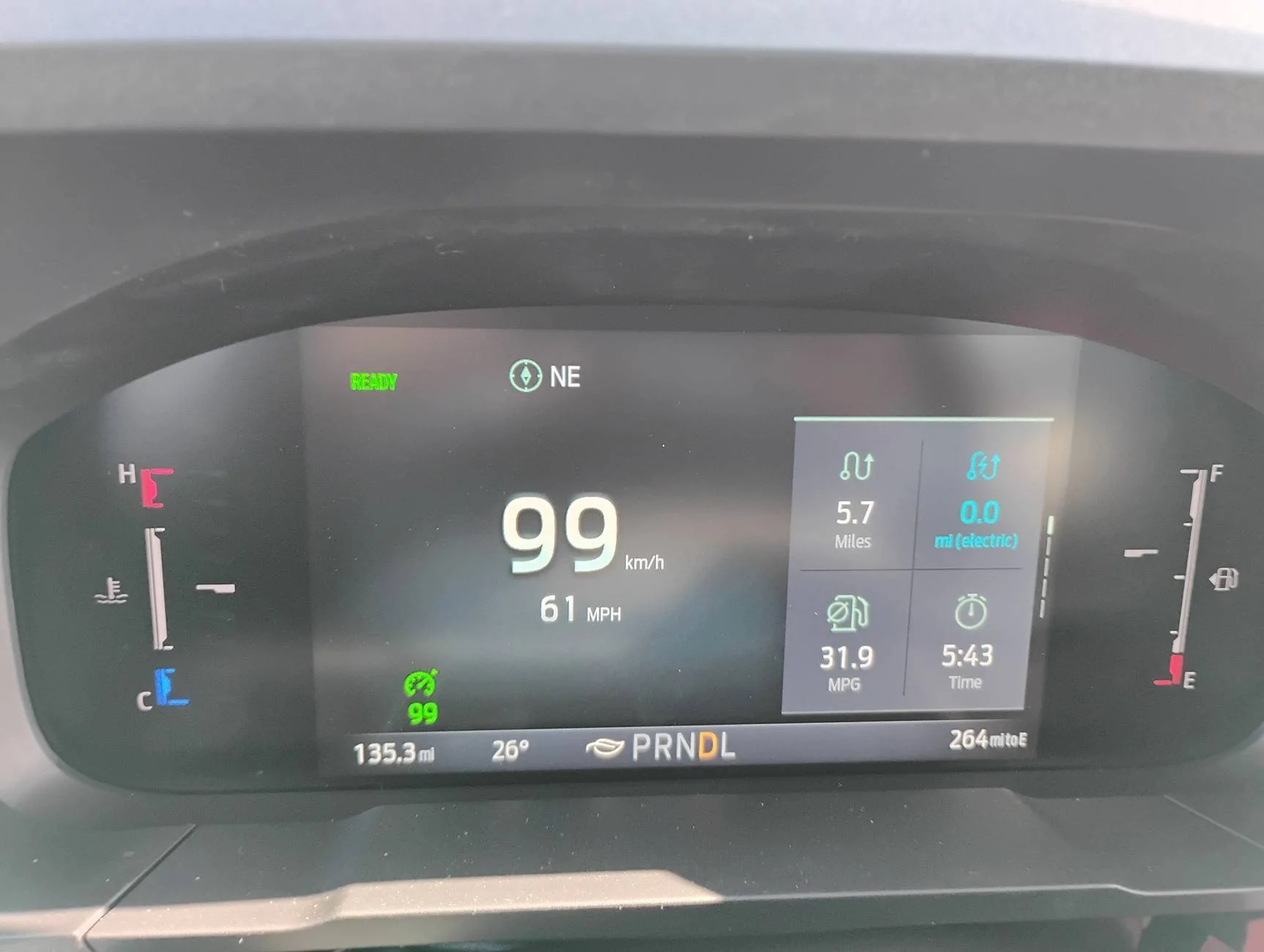

I was getting a bit worried since I've only had my hybrid for a week, but haven't seen better than 28mpg yet. It's been below freezing the whole time,so I'm assuming that's the main reason
Maybe it isn't broken in yet, mine, at 147 miles, getting less mpg than my ecoboost did on the 22'. If it doesn't get better, I will be disappointed big time. I have no miles on the battery, and drove about 15 miles.
I did get the battery to register .7 after I hit the brake to slow down to turn on my street. If the key is to hit the brake to charge the battery, I won't get very far.
Well over a quarter tank of gas to go 135 miles. That must be about a bit more than 3 gallons. Seems like a lot with a battery operated vehicle. Maybe I am just nuts.

Any engine, hybrid or otherwise, is going to see mpg drop in cold weather. That’s been a fact of life since the first internal combustion engine

Don’t worry. You’ll see a big increase in mpg once the temp reaches 60 degrees or more. I see the temp on your display is 26 degrees. Yea, don’t listen to the naysayers or those who make you feel bad by saying ā€œI get 65 mpgā€. It’s BS. Just don’t focus too much on the variances in your mpg from day to day or season to season. It can feel like a rollercoaster if you do. I promise that you’ll see an increase when it warms up. And guaranteed over the long-run you’ll get at least the 38 mpg combined average listed by Ford.
