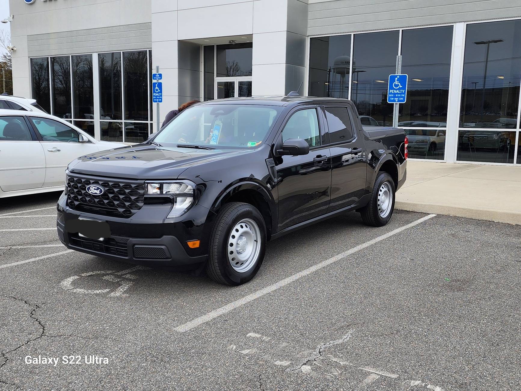

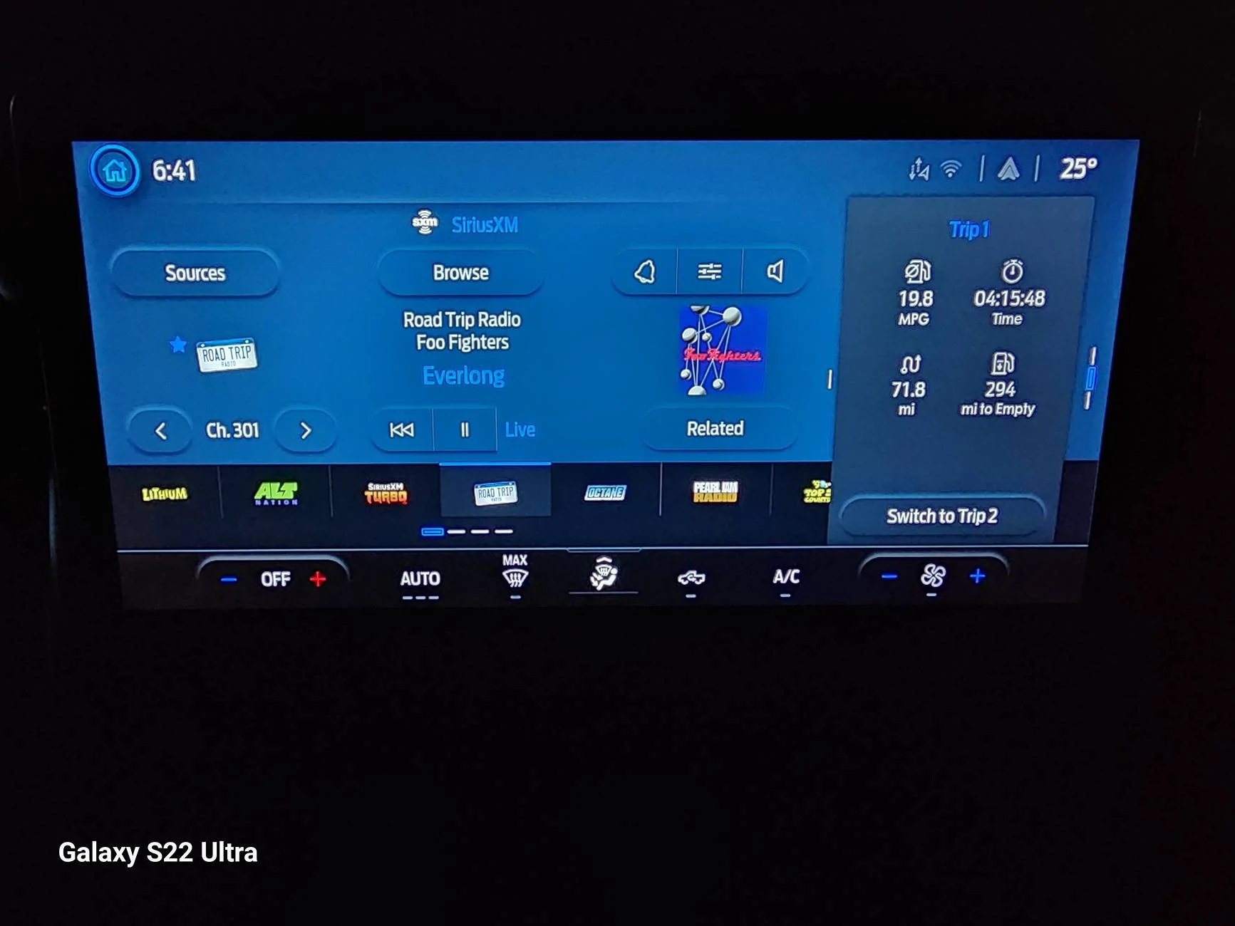

I have driven it very easily during this period and at the 100 mile mark it was at 15.3 mpg. At the 200 mile mark it was at 16.4 mpg. It now has 237 miles and at 19.8 mpg. Since delivery the temperature has ranged from the low 20's at night, (only driven it for about 1 hour at night), and around 40's to 50's during the day. My dealer used 87 octane for the 1st fill up but I will be using 93 moving forward. *side note: my wife borrowed it and put 93 in it the 1st time it got to half a tank. Wish I could have jotted down the mileage at that point and wish she would have waited until almost empty.
