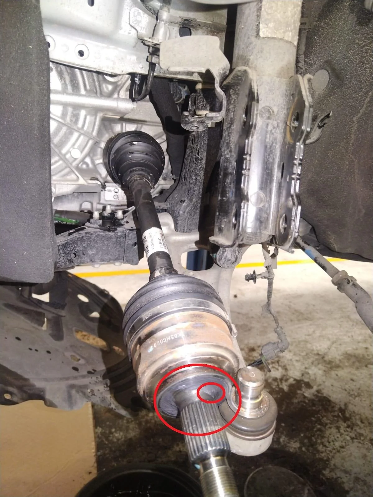

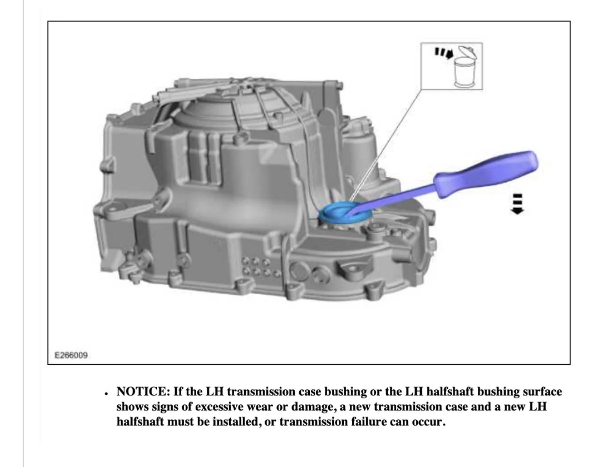

If you still have the same issue after the replacement, have them check the case bushing. I still haven’t replaced mine because I’m trying to get Ford to look at it/document it. I have an appointment soon and will provide an update.

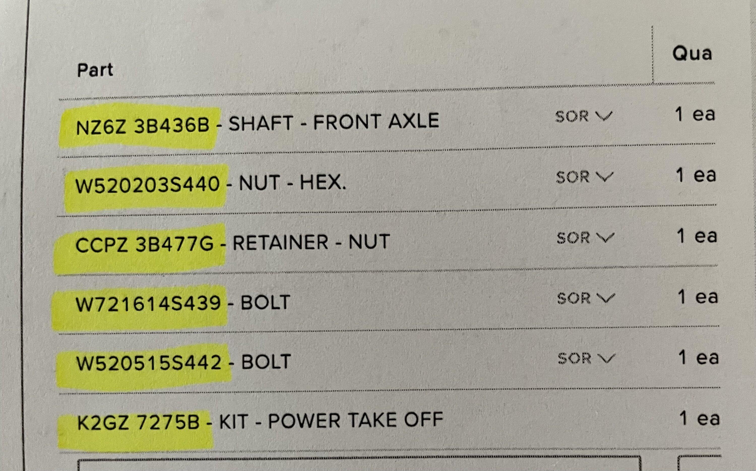

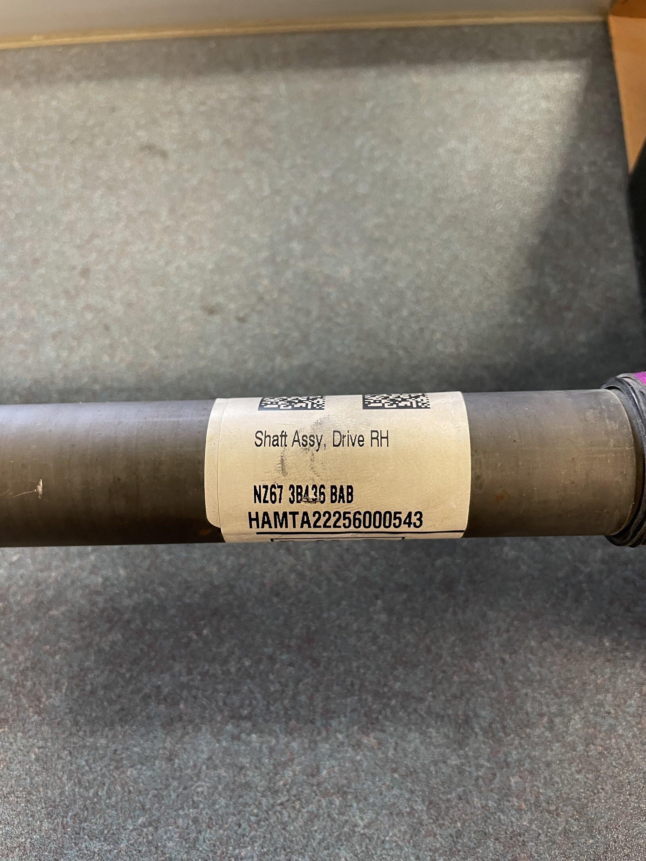

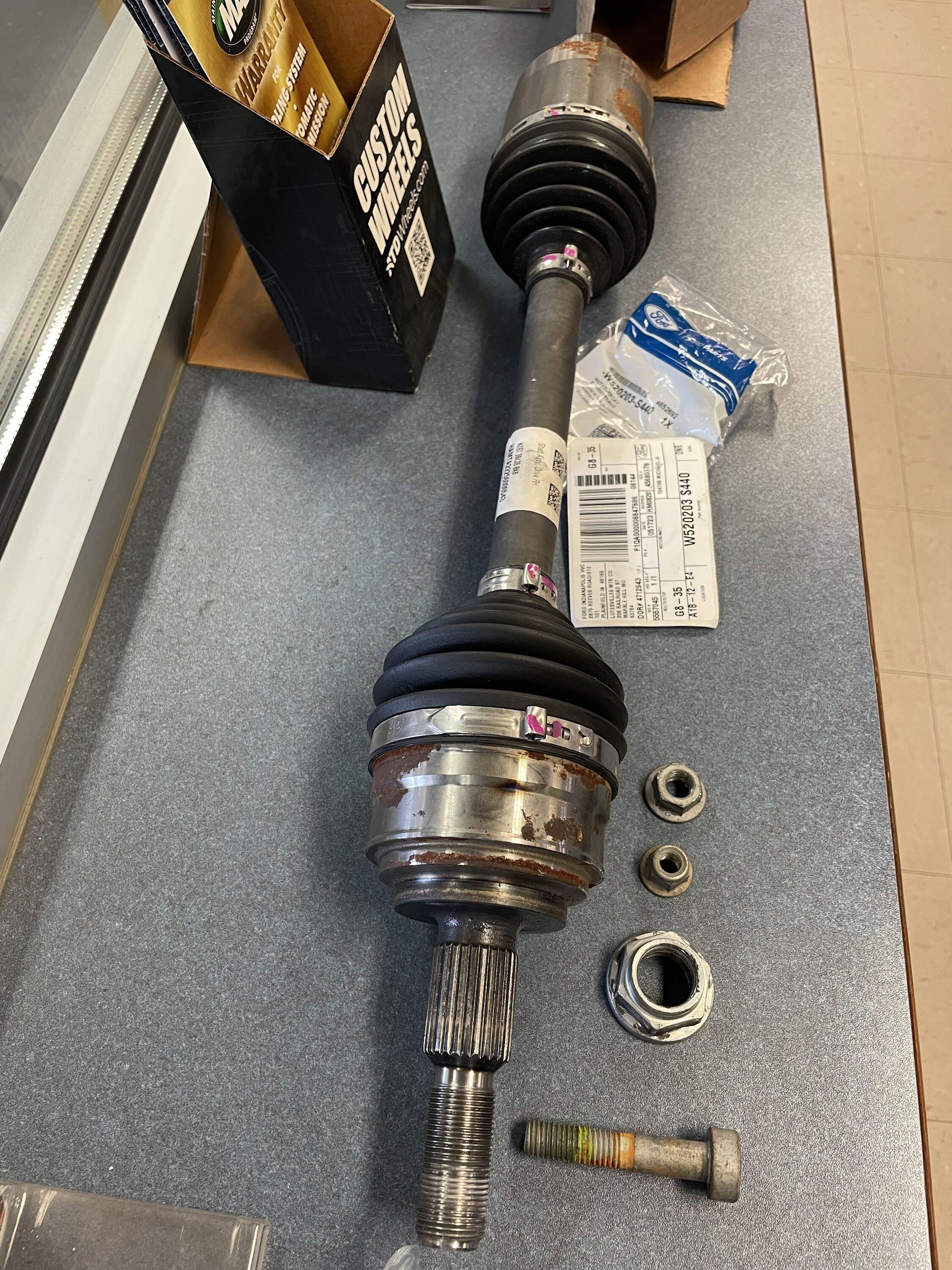

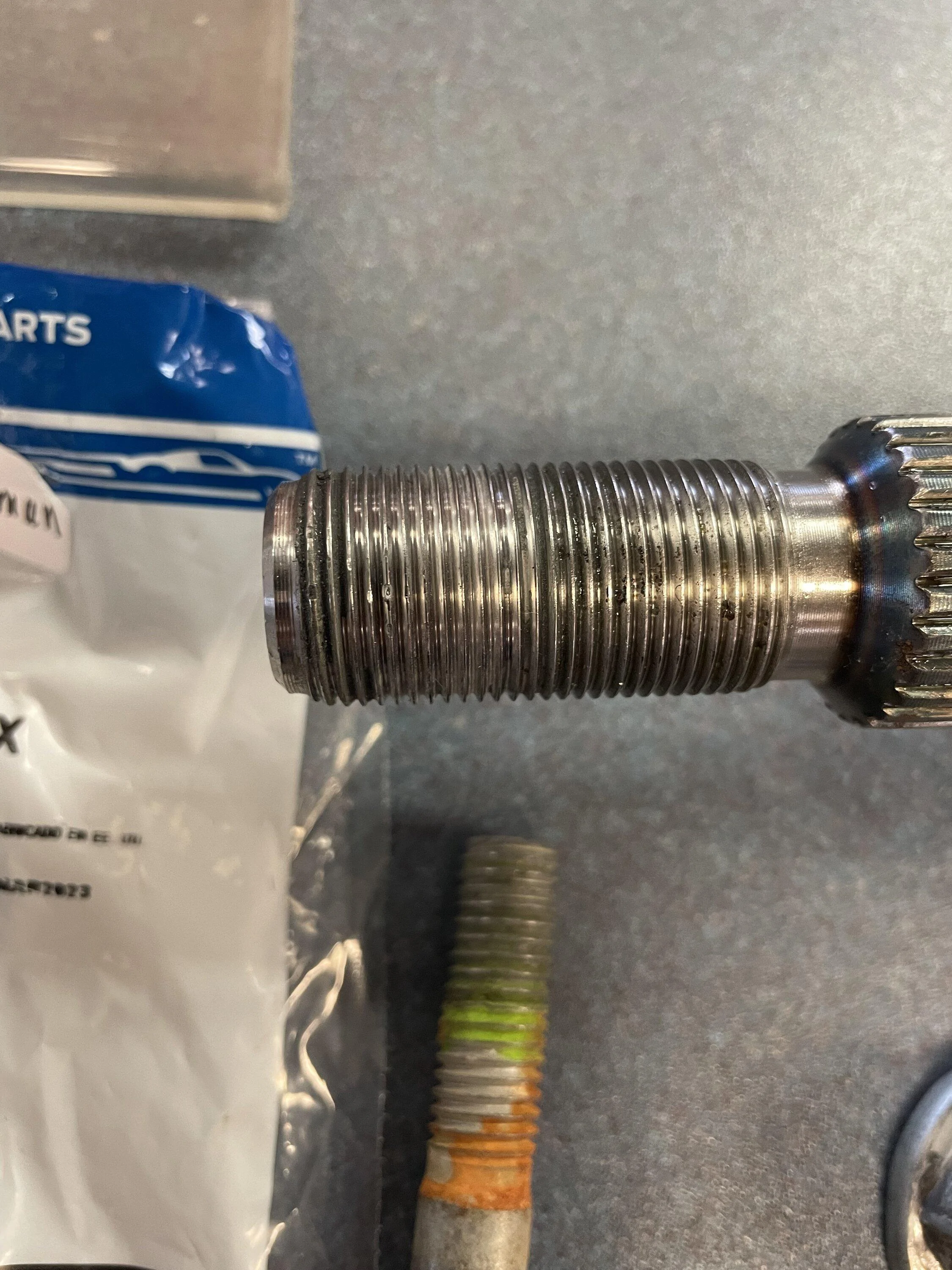

UPDATE: I picked up my Maverick yesterday and all seems to be fixed. I’ve attached pictures of the parts that were replaced. I hope this helps someone.
Ford Maverick Shimmy/Wobble IMG_1550
Ford Maverick Shimmy/Wobble IMG_1543
Ford Maverick Shimmy/Wobble IMG_1549
Ford Maverick Shimmy/Wobble IMG_1548

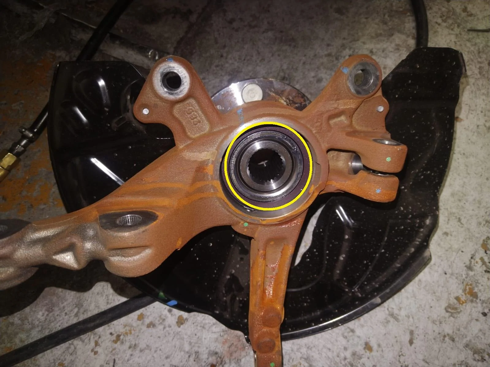

First CV Axle issue started at 3000 Km and the dealer detected the issue at 4000 Km. The dealer changed of the driver side the cv axle, the bearing and all the piece the piece that houses it .
Did they over torque the axle nut or cross thread it on there
Jeez
