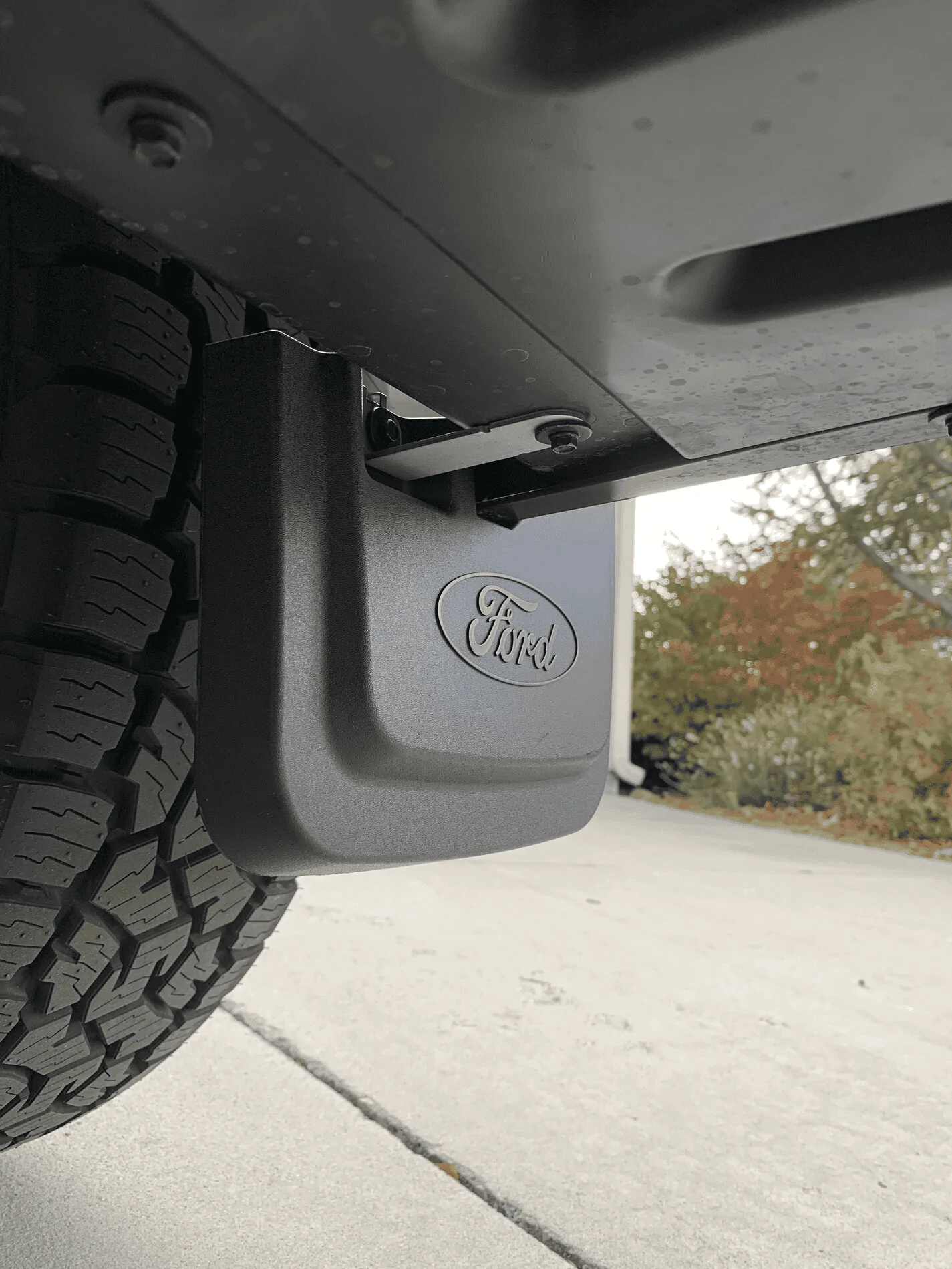

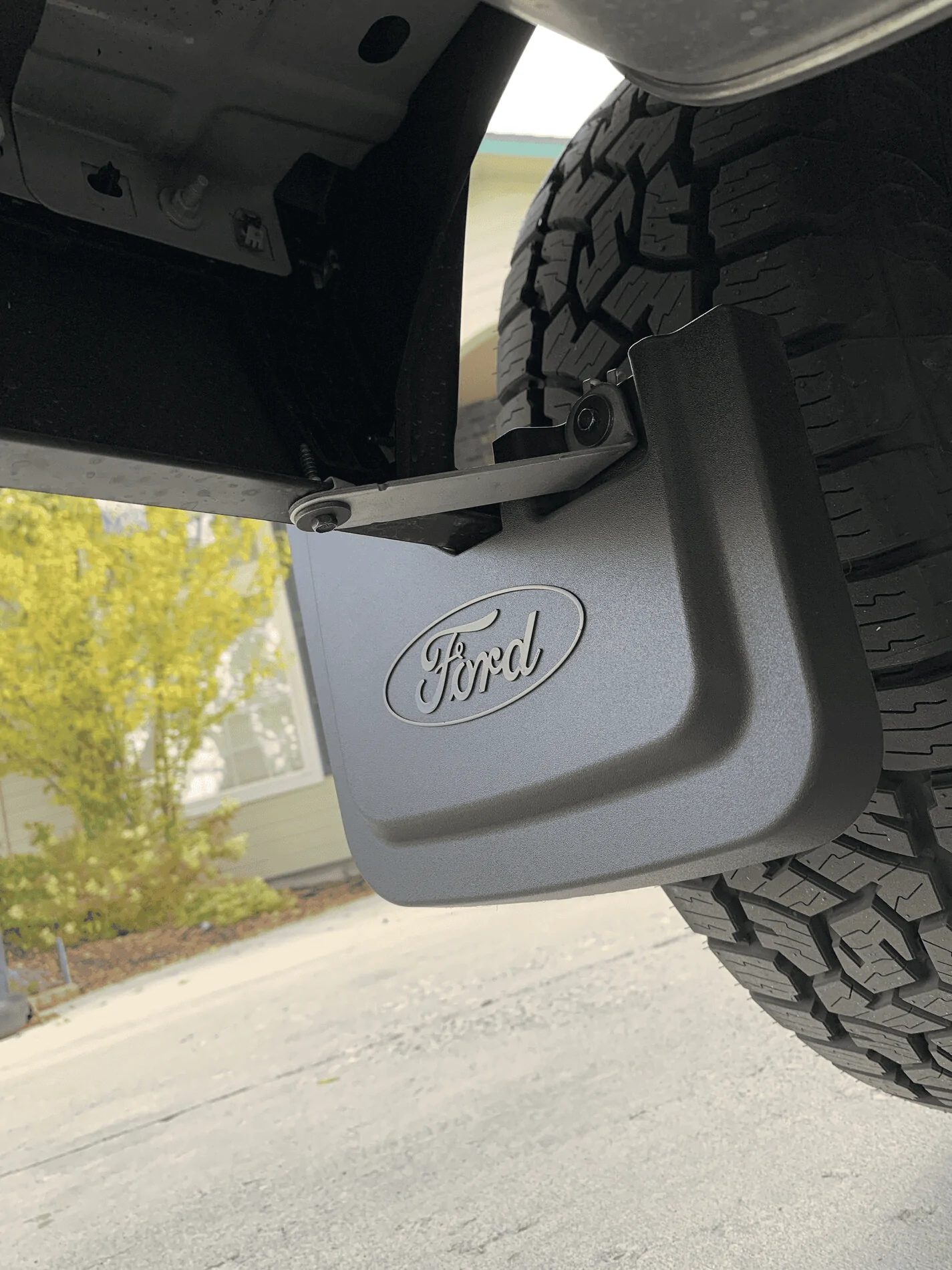

Yep! Took about 45 min totalDid you do it yourself ?

They are different in regards to....the number of mounting holes, placement of said holes and the overall length is 2" different.I just have to comment.
Despite your dealer saying they sold you front and rear sets, they look exactly like the same part. This might explain the inexplicable gap that shouldn't be present in the rear. The profile on the rear mounted is the same as the front. Have you seen if they swap front to back and still fit? The only difference I see is a left and a right.
Appreciate the info! Thank you!They are different in regards to....the number of mounting holes, placement of said holes and the overall length is 2" different.
drivers side rear needs one 7mm hole tapped in the underside of the black part of the bumper. Everything else uses pre existing mount points.Did you have to drill any holes in the body?
