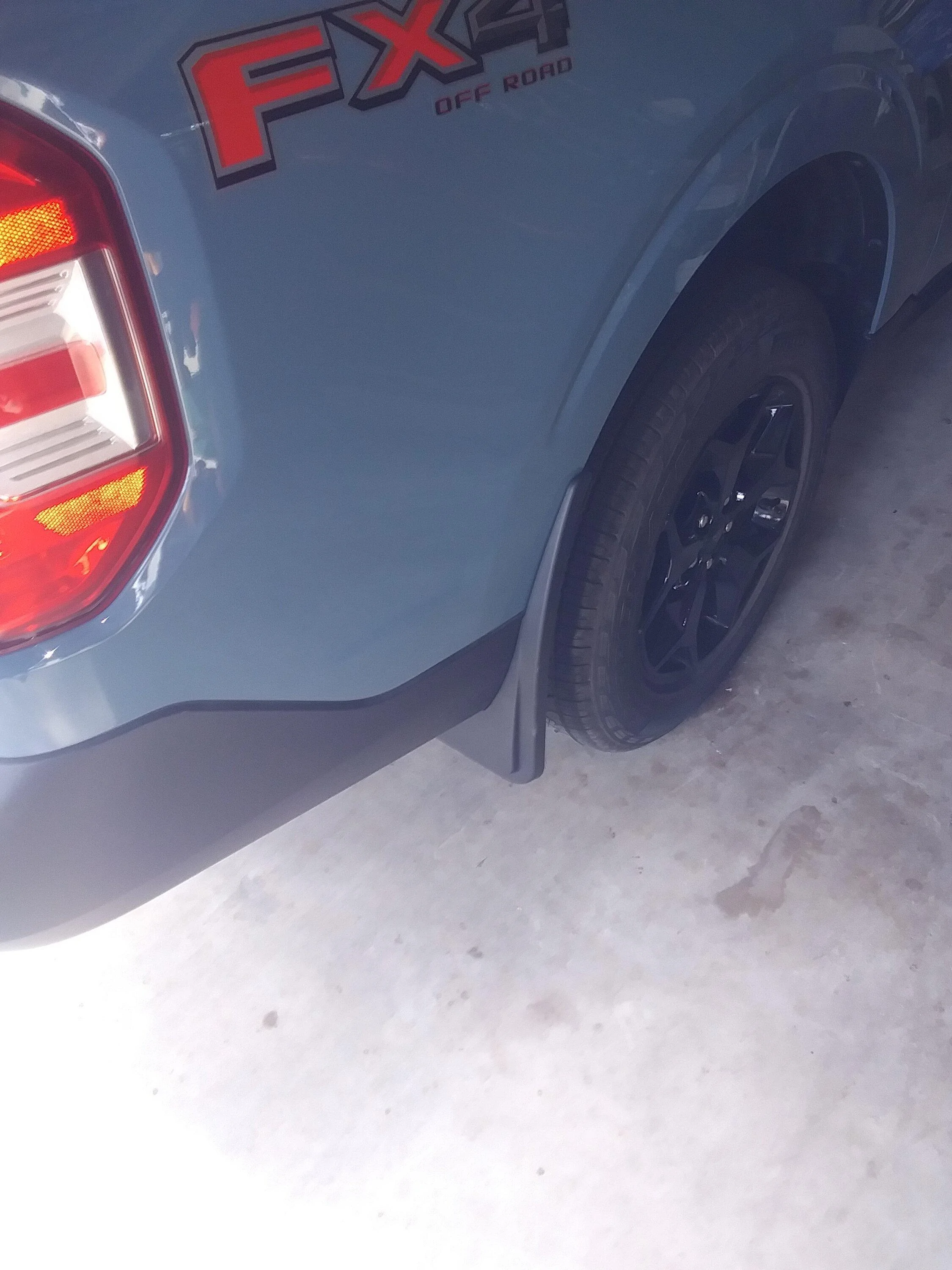

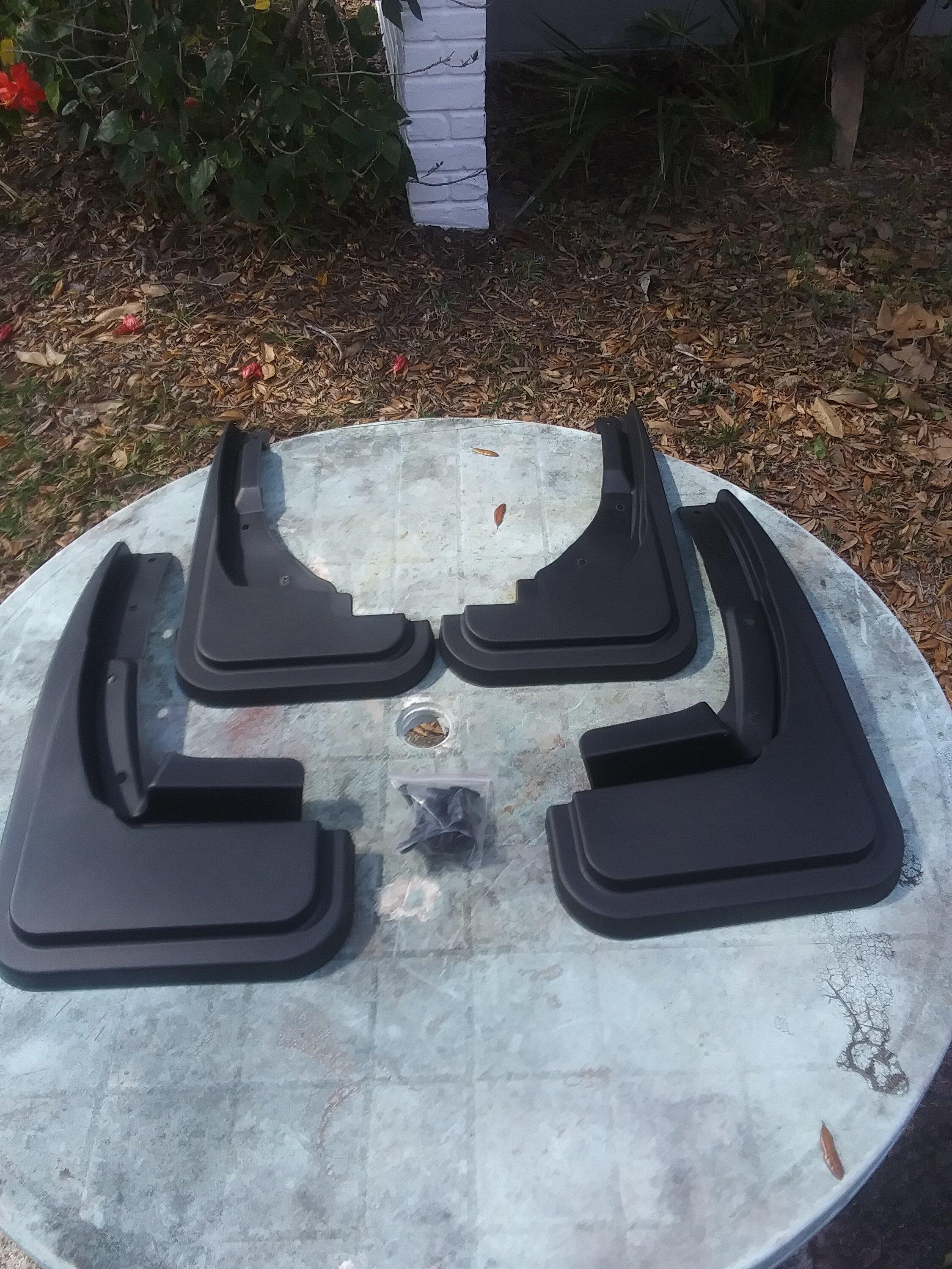

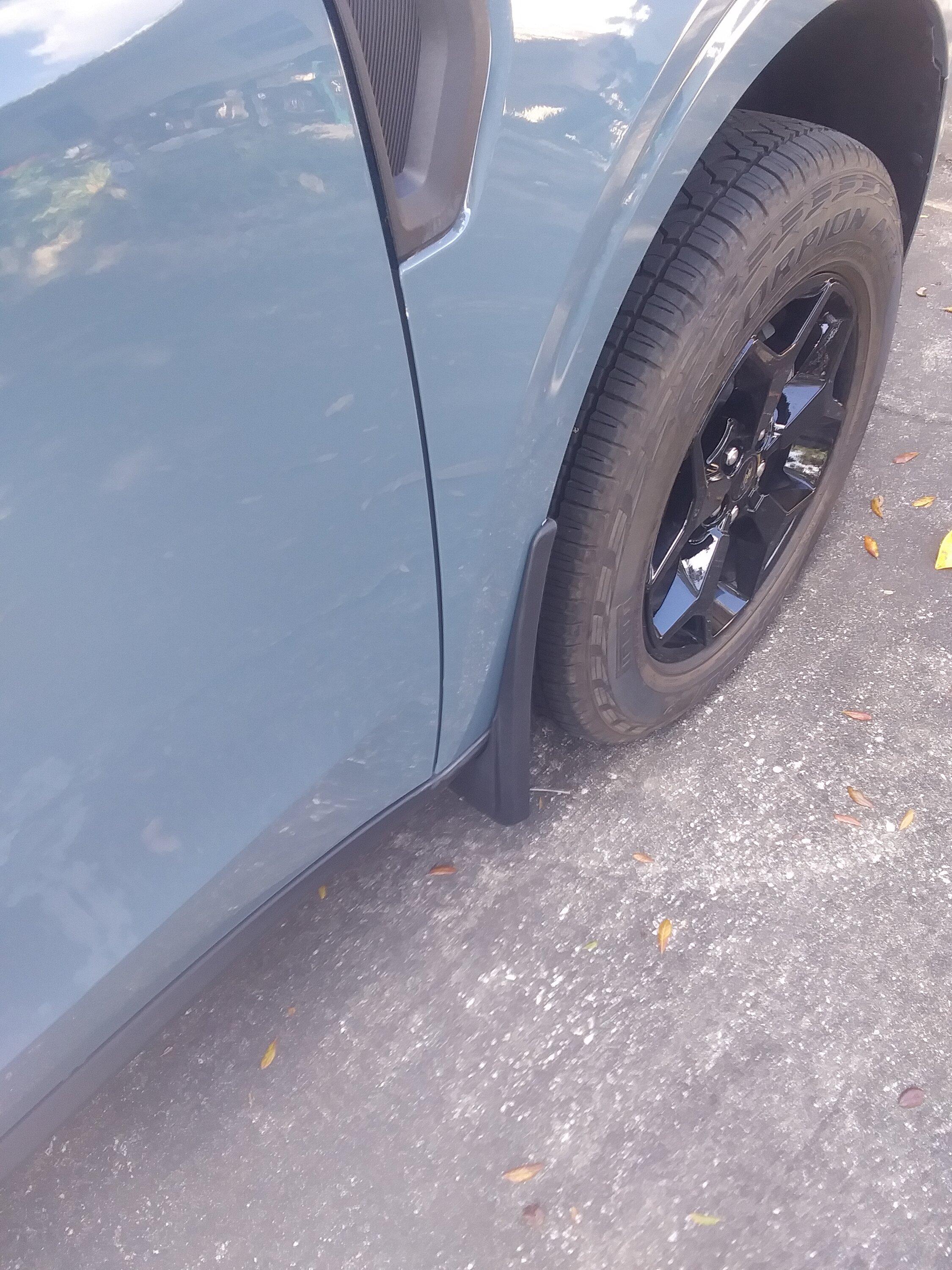

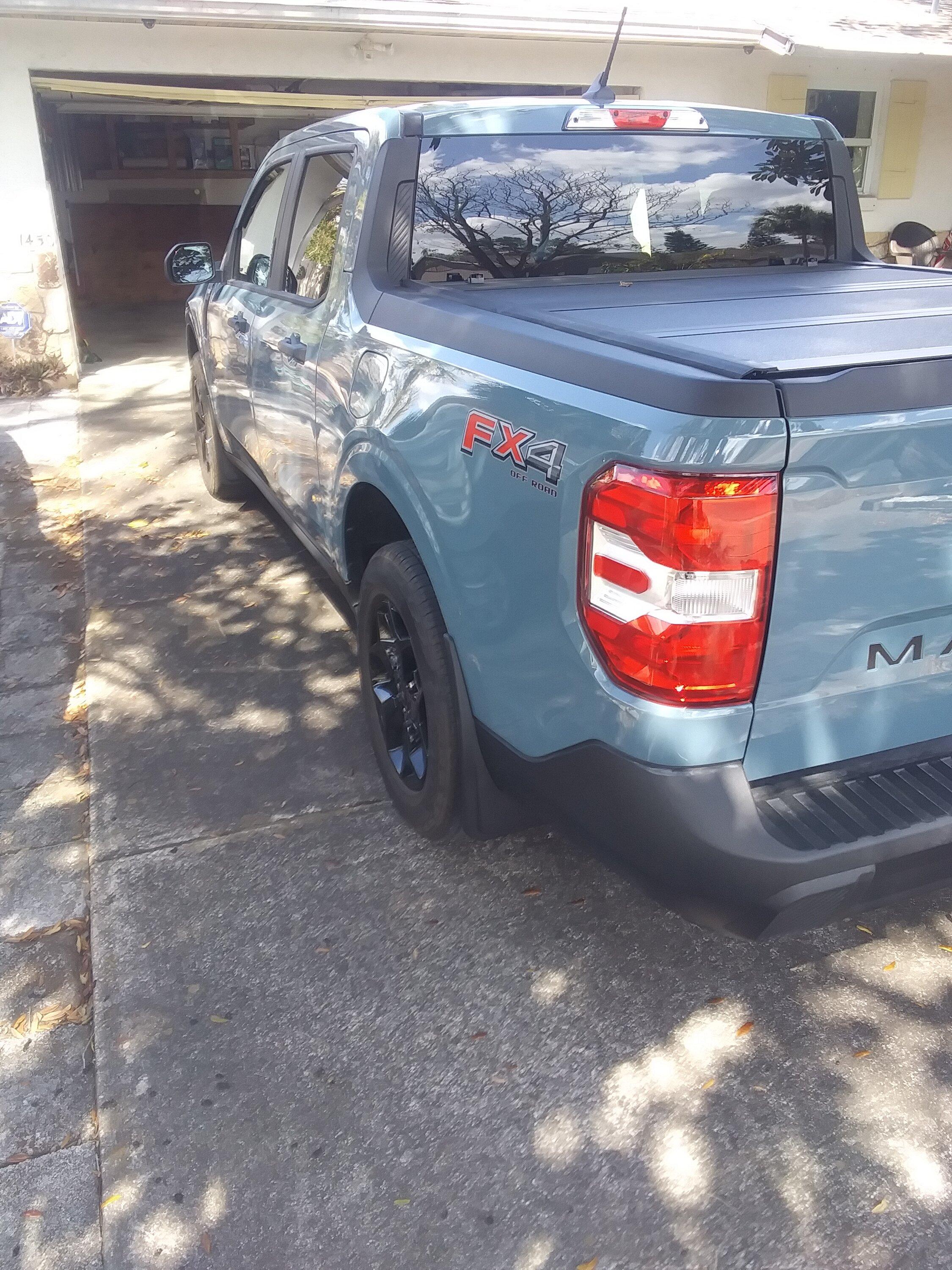

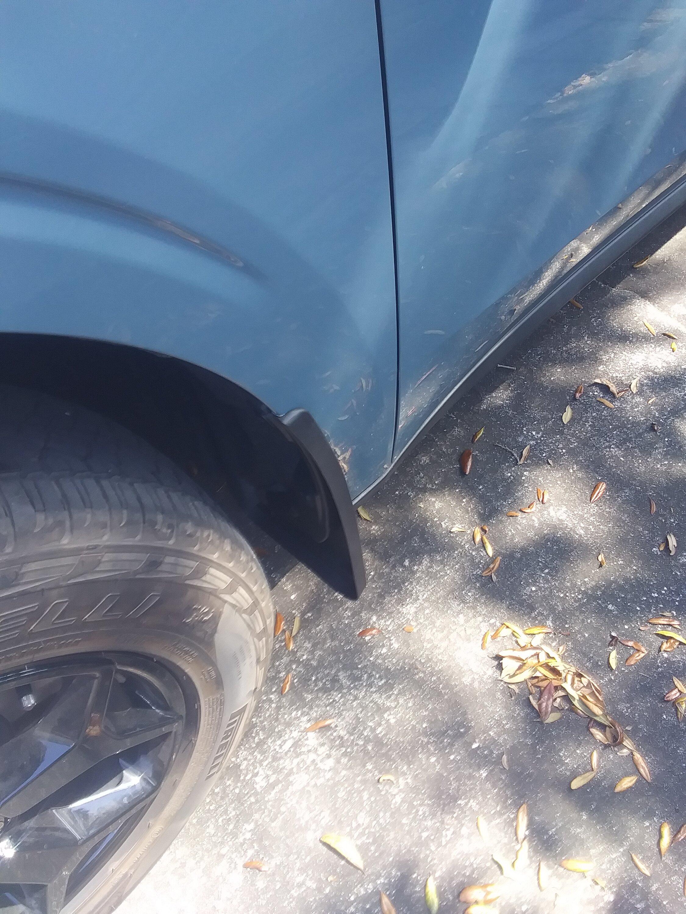

Received Ezcarso mudflaps today . four mudflaps and grommets included . inside of mudflaps marked with position of fit . checked fit and seemed ok. Used black gorilla tape on corner edges to protect the paint and mounted . Used all the original grommets to mount . all holes lined up . so far so good . good value . it doesn't cover the area on left rear of truck by muffler . tools used : 7 mms socket , small socket wrench ( back mudflaps ) , small blade straight screwdriver to pry out grommets front and back mudflaps and flashlight . grommets have small recessed are to pry under center insert .

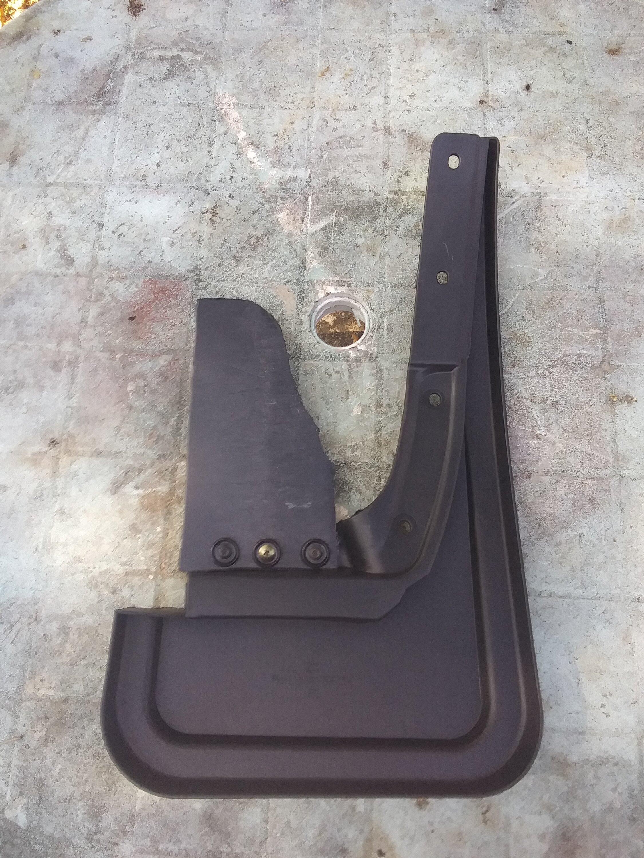

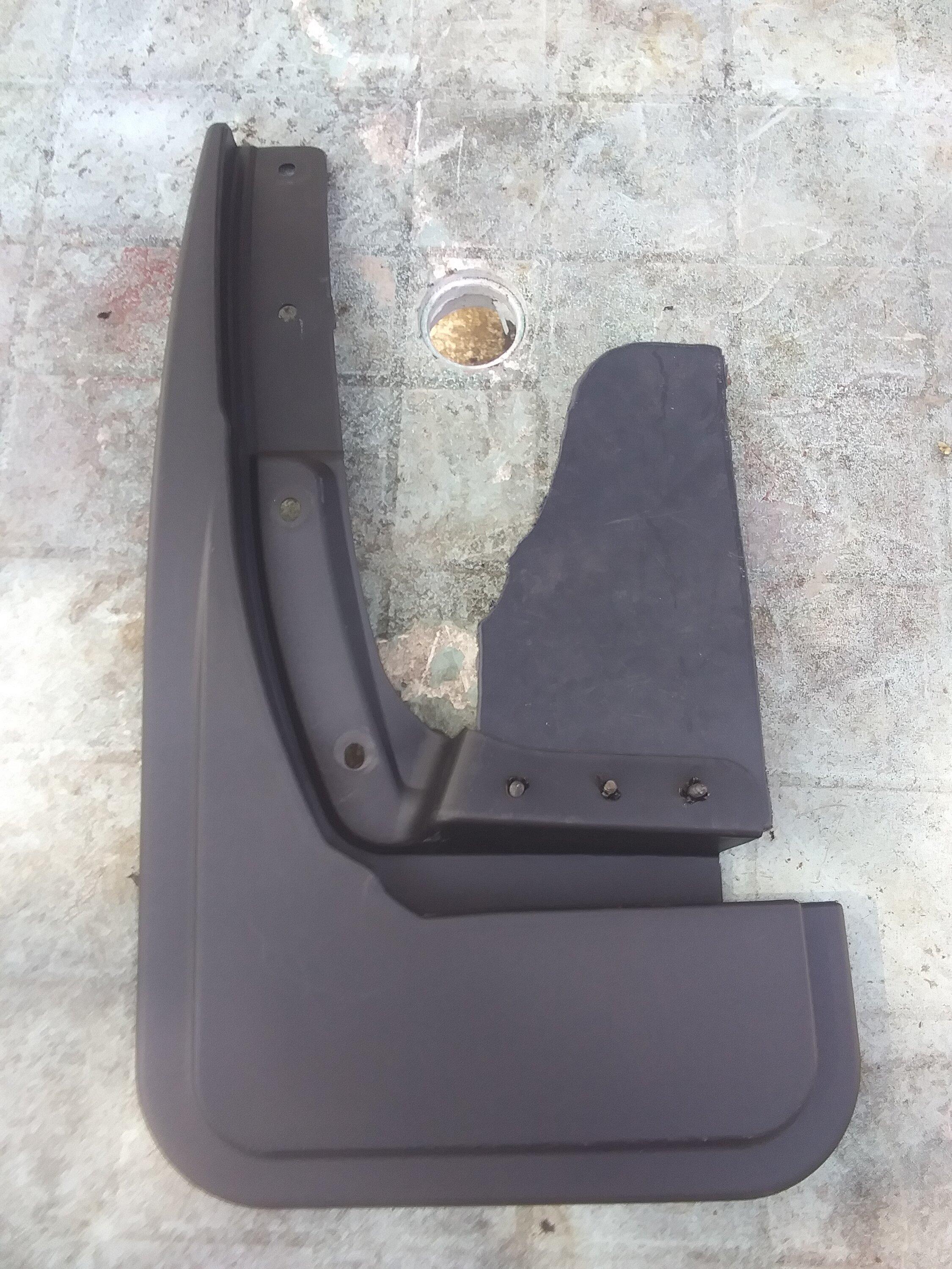

Escarso mudflaps installed couple of days ago and modified left rear mudflap to fill gap to protect tire from kicking up dirt into fender and taillight . measurements 4 inches wide by 8 inches long material . I used black plastic scrap similar to mudflaps , but could use metal . attached it to mudflap (3 holes and 3 screws ) . cut curve to fit inside curve of fender liner . Used a jigsaw to cut material . attached pictures show both sides of mudflaps . leaves plenty of distance from muffler .
