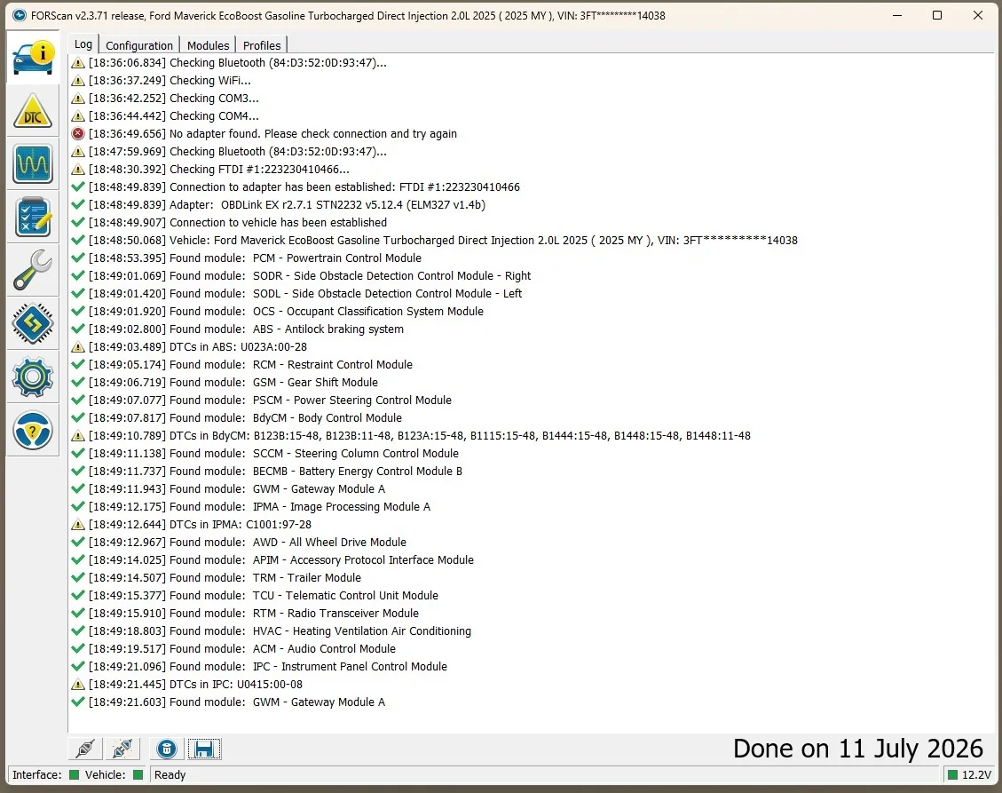

Received the OBDLinkEX and hooked up to the Maverick.
Ford Maverick FORSCAN first time connecting ERRORcodes
Looks like FORScan found a few yellow triangles.
How do I clear these or do I have to take to the dealer to have cleared?
Would like to change a few things in FORScan that have become annoying.
>Hyperflash on turn signal since I have LEDs installed.
>Turn the AirCondition OFF when starting the Maverick.
..... Every time the Maverick is started, the A/C comes on.
..... Do not need the A/C to come on when weather is warm & windows are down.
..... The fan is on all the time blowing air toward the floor.
>Would like to turn the chime off when the engine is running & door is opened.
And to be able to change other things as they are found out about.
Any help will be appreciated.

You can clear the DTCs in the DTC section on the left (DTC in yellow triangle).
I can't help you right now with the configurations you want because I don't have the 2025+ reference, but if you don't get help with that from other members, I can try to help you. There are plenty of FORScan guides out there for you to refer to on how to operate the software. Also, one of the first things you need to do is find the 2025+ configurations spreadsheet and see which items on your list can be altered.

You can clear the codes by clicking the yellow triangle that says DTC on the left, but keep in mind that codes are not problems......only problems are problems. When the codes end with a 8 in the status byte, it means it is a stored code and not an active fault. See example below from my truck:
Ford Maverick FORSCAN first time connecting 1784143236710-kk
As far as the things you want to do: Not sure if there is a way to not have the a/c turn on automatically. You'd have to dig through the HVAC module spreadsheet to see if something stands out that corrolates with that effect.
