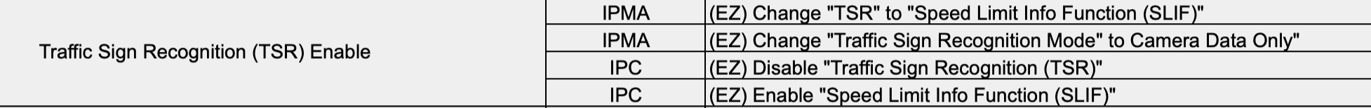

Has anyone gotten the TRS to work on the 24 MY Mavericks? iv used Forscan and tried multiple times to get it to work but to no avail. i also noticed that there's an option for launch control on the mavericks has anyone been able to get that to function?

so there are two launch control settings for the cluster (one to enable a launch control option in the driver assist menus) (the other enables the launch control display for the ford performance MYVIEW screen) but I don't believe they actually change the way the engine and trans behave. The maverick will let you rev to about 3k while holding the brake regardless of the launch control setting in forscan. I know tuners have implemented actual launch control for the Maverick. but I would be afraid of the transmissions/drivetrains health.

also I am not sure was TRS means
