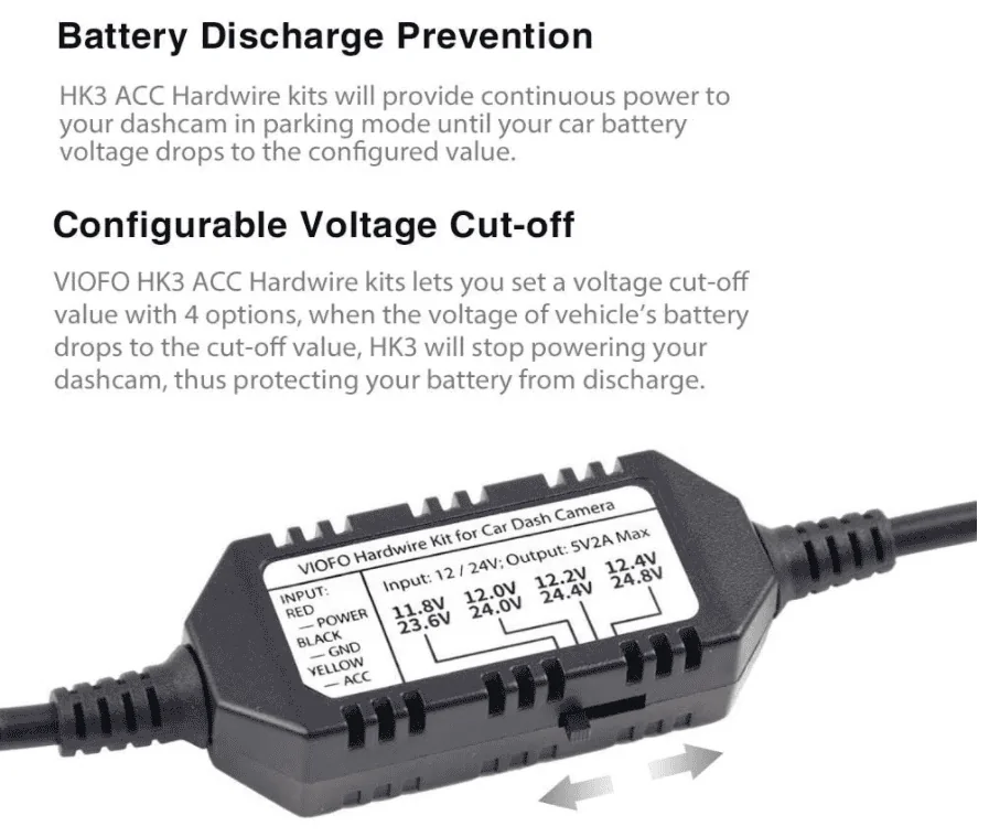

These hardwire dashcam kits usually come with a step-down converter (12v DC to 5v DC) that contains some circuitry to shut off if it detects a voltage below a specific value, or it has a toggle switch with a few minimal voltage options. Mine has options for 12.4, 12.2, 12.0, 11.8 Volts I think, and I believe I have mine set on 12.0 volts, because my parking mode recording was only making it through about 30 minutes before the low voltage detection turned off the cameras when set for 12.2 or 12.4v.
I believe the regular voltage on my Maverick Hybrid when turned off with no extraneous devices is ~12.4v.
What's weird is that some days, it doesn't go into deep sleep mode. I'm convinced the Maverick has both a relatively conservative point at which is goes into deep sleep mode, and an inexplicable randomness to how it decides to "top off" the 12v battery or not when you have the vehicle running. But I can't pretend to actually understand a lot about these systems in detail, I just looked at some YouTube videos and plugged some stuff together.

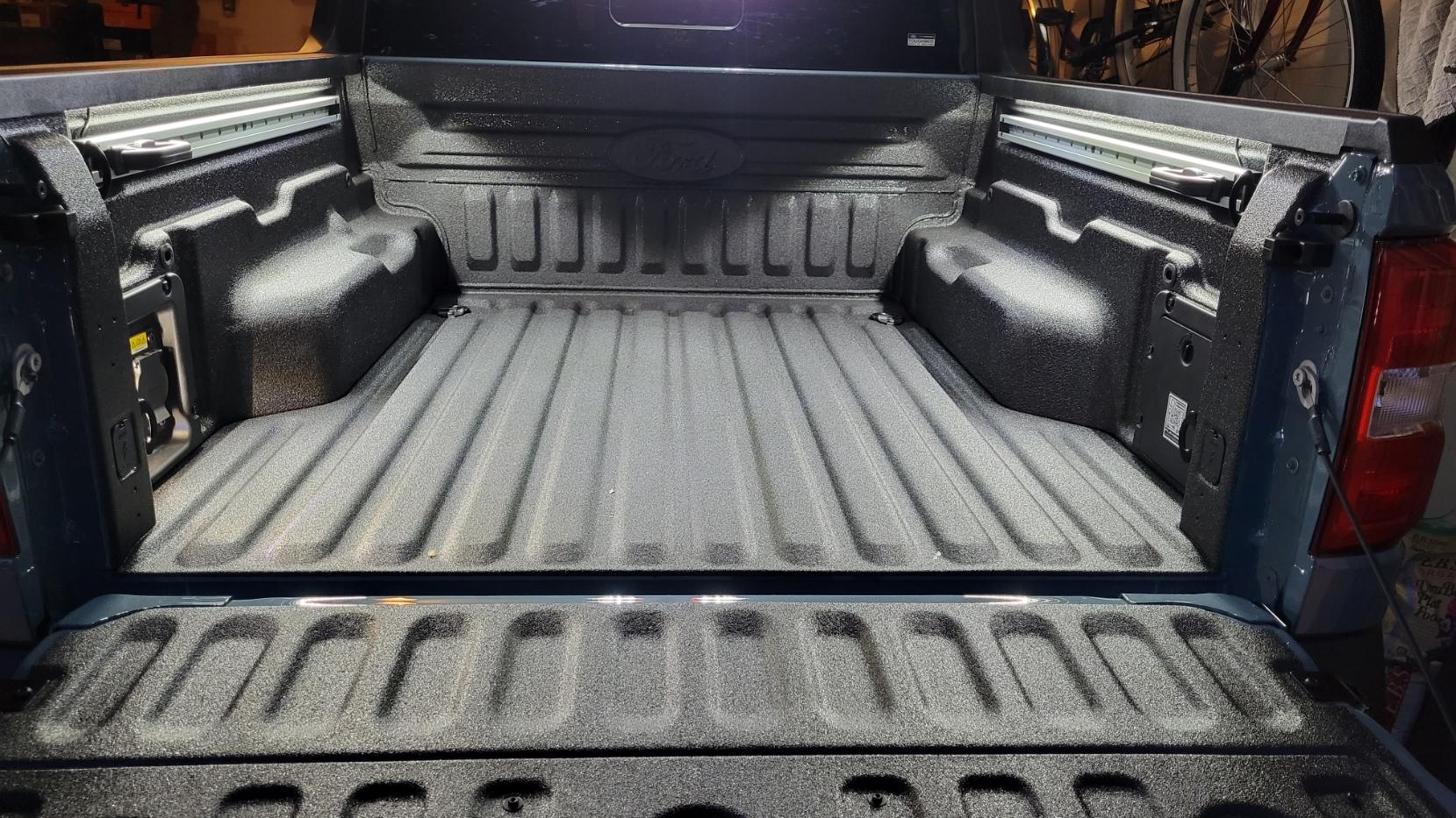

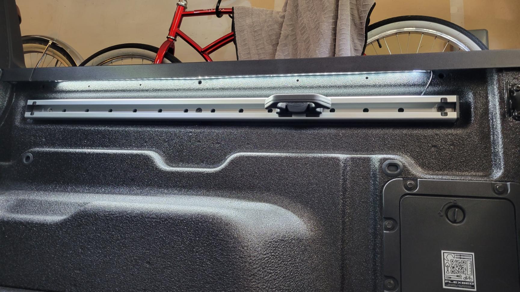

This happened to me once after I tapped LED strip lights into the existing bedlight. I chalked it up to me constantly going out and admiring my work by opening the door or manually turning on the light switch. I haven't done it as often ever since.
