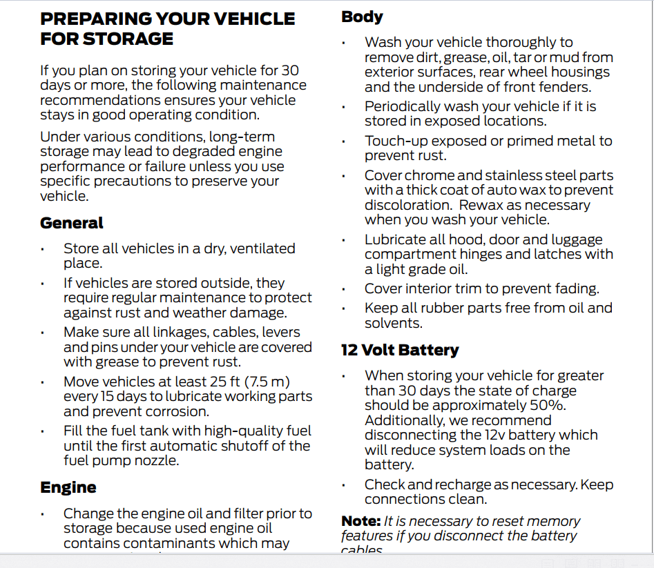

We'll see. I am 11 months into the first truck. If it lasts 36 months doing what it does, I'll be content. My C-Max instructed that if the car was left unstarted over 30 days, same as the Maverick instruction. The truck should not require a trickle charge in normal use....but I would not be without the jump box, just to be safe.
Ford Maverick Deep Sleep Maverick Hybrid Question 1707682602867
