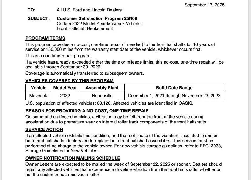

I had them both replaced on my hybrid almost 2 years ago. The drivers side has issues now. The replacement ones had 12 month 12000 mile warranty. Truck has 78000 miles on it.
Since you have exceed the original 5 year 60,000 mile warranty - IF your truck was built in the stated date ranges you have an additional ONE Time additional free replacement left for up to 10 years or 150,000 miles
Ford Maverick Ford CSP 25N09 - 2022 MY Front Half Shaft Replacements 1758606940948-dy

I'm having this done right now with 57k on the truck and the service advisor told me yesterday afternoon that it would be covered under the CSP. I pushed back and said that should be under factory 60k powertrain warranty and then I'll have the CSP replacement for later. That's the whole point of it being 10 years / 150k miles!
... I haven't heard back from them yet. They were expecting the parts today, so I'll call them shortly.

They probably want to see if the exact same supplier with the exact same design and QC checks magically provided better versions that will avoid a recall.
Seems they would have some stats showing that is a hopeless desire.
Or they've done the math and so far the 23/24MY owners seem to be less high mileage, and many more may just make it past the warranty periods.
what I find strange is that the build date range starts in Dec ‘21 but if I remember correctly, Mav production started in Sep ‘21 (My build date was Oct ‘21 ). Why would they not start the range at beginning of production ? That’s only represents another ~ 15k vehicles.
I'm replying to myself, I know.
But I just got confirmation that my work is being done under factory powertrain warranty and not this CSP. And, it's expected to be done today, having gone in yesterday, so they got the parts in one day. I have no idea if it was overnight shipped (doubt it), local depot, or they already had some axles inbound anticipating needing them.
same. my build date was the week of oct 5 2021. no CSP notification in my ford pass app.
Were hybrids started later than EB's perhaps - and main focus here is on hybrids?
Would be interesting if very early production runs had a different axle, that hasn't shown any / as many issues?
the main focus isn't on hybrids as both hybrid and ecoboost are covered, and have had issues.
...and his question is a good one IMHO.
presumably Ford thinks they know of an issue affecting certain batches of production. I would be pretty annoyed if I had an early production vehicle that was excluded, because I don't think it's a production issue. I think it's a design flaw, a combination of a bad joint design and a flimsy boot.
