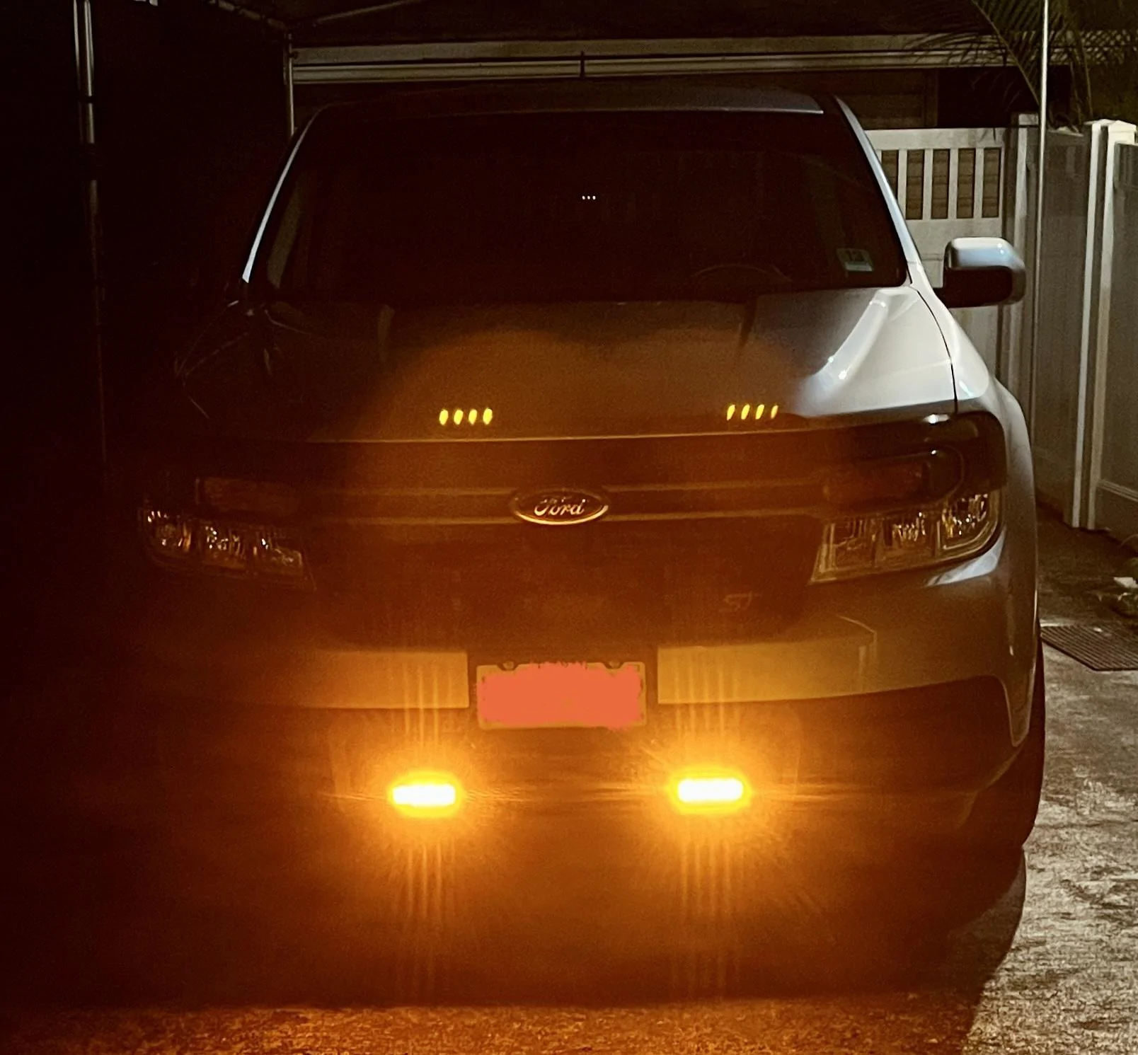

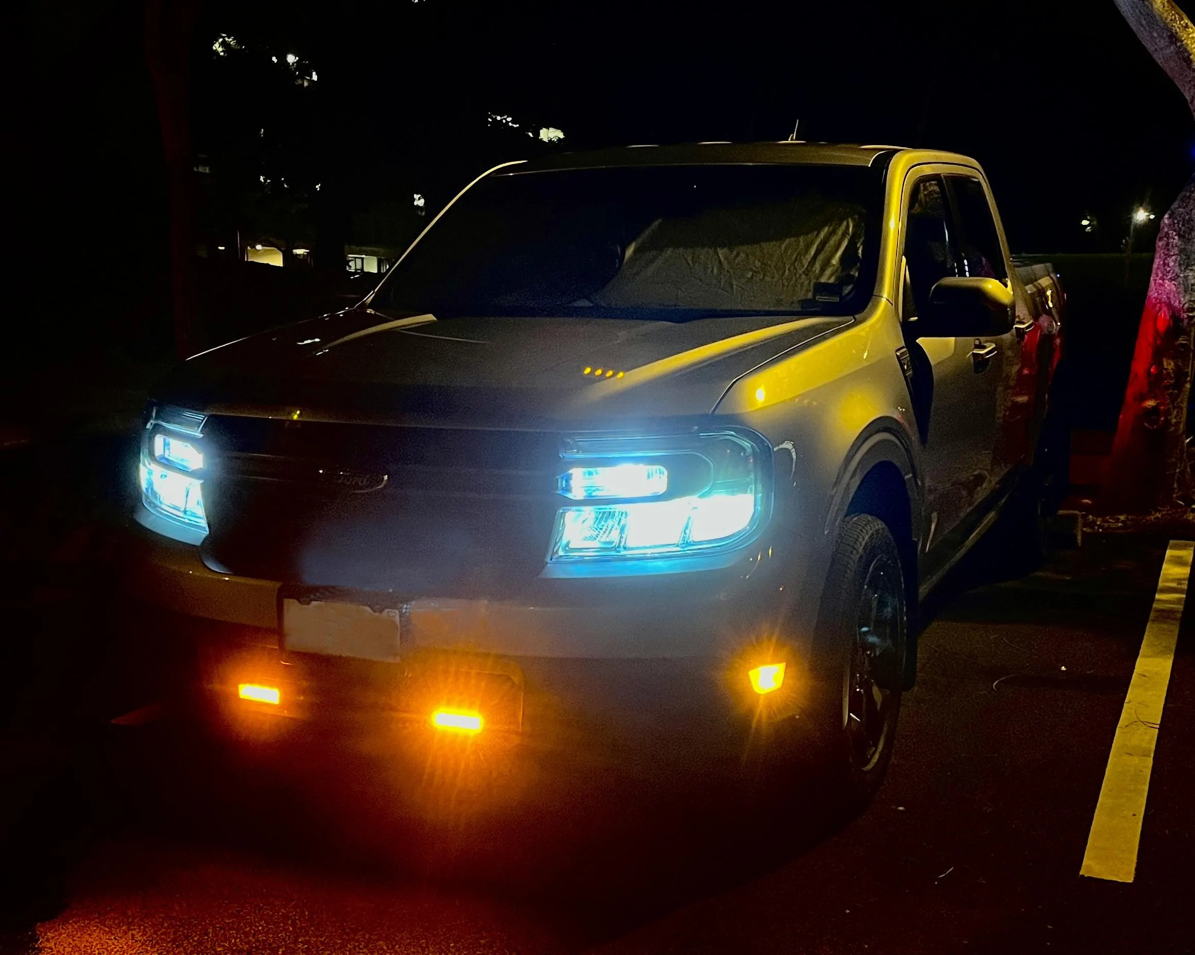

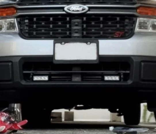

Now that looks great nice and clean not a big over bearing light tucked in very nice . With respect I may copy your idea but put both clear and amber on my Maverick. . May I ask how you mounted the light s ?? Again very nice 👍😊👻
dddinstructor
Hiram
Sep 23, 2021
77
Honolulu, Hawaii
XLT FWD, 2.0L Ecoboost Engine, 8-spd Automatic
Believe it or not, these lights are the perfect sized to mount onto the vertical rods that support the lower grill. They were essentially "zip tied" tightly to a vertical rod at each end of the light.
The wires were fed through the lower bumper and up into the engine bay. You have to drill a 3/8" diameter hole at either end of the grill frame, which was easy. I power tapped fuse number 3 in the under the passenger dash board. I'll try to take some close ups of the install.
