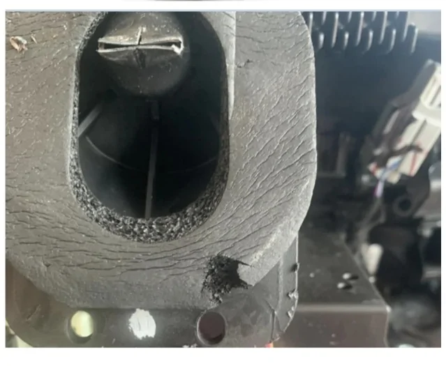

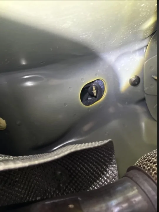

The condensation drain tube may be in the same location on the EcoBoost I do not know.
On the hybrid the condensation drain tube is still behind the main Splash Shield and the heat shields this is what I found from another forum.
👇This is the text from the other site.👇
You will find it middle top under the heat shield. Directly between the seats. You will have to take your front cover off and the two side covers will have to have a few bolts loosened. Then remove all the 10 mm bolts holding the heat shield in place bend that sucker and slide it down. You will then have access to this disgusting hole.
Good luck and keep us updated.
