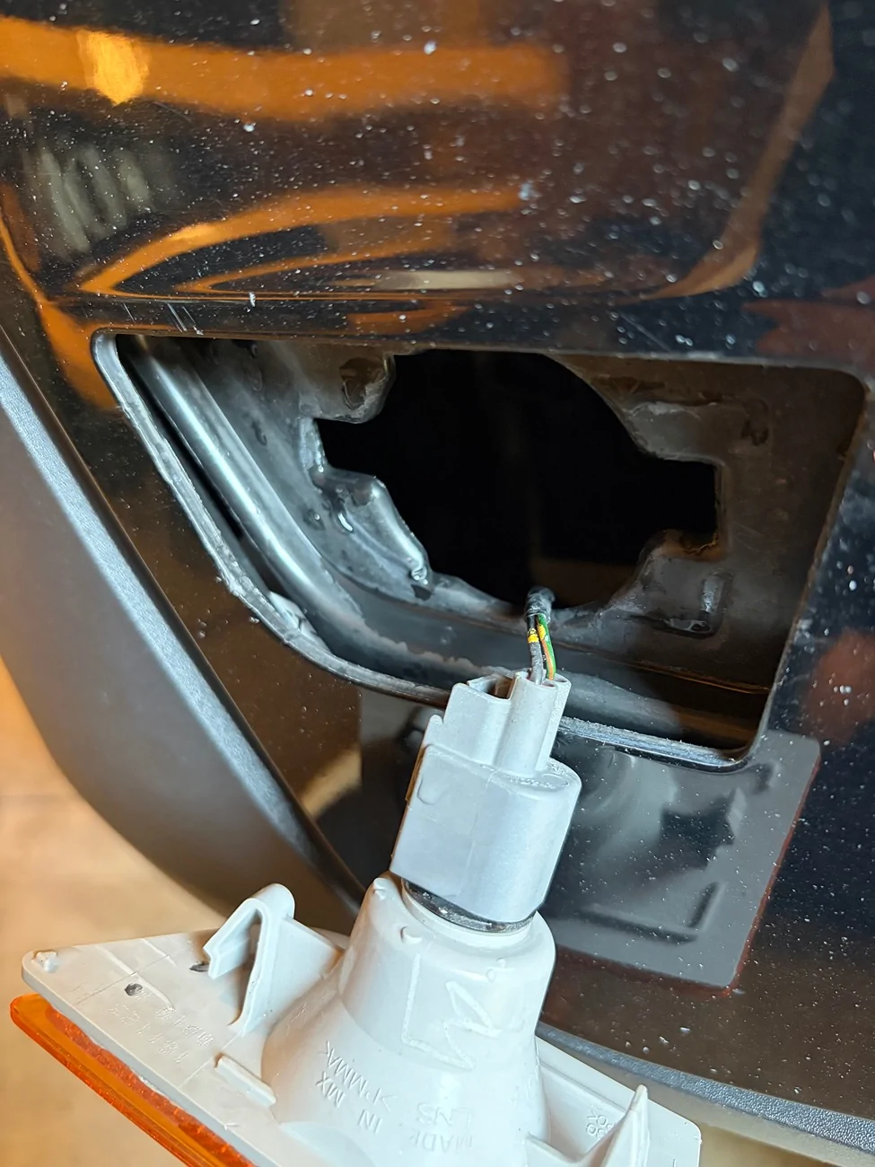

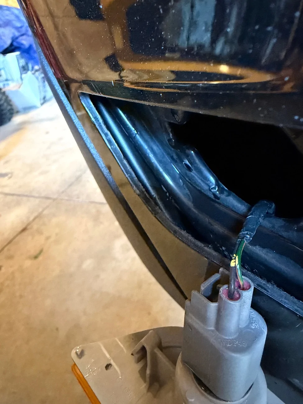

Here is the inside view, it seems like the right side is attached normally and the left side is not. I can pull it to the edge put it almost feels like something is forcing it in but I can’t find what.

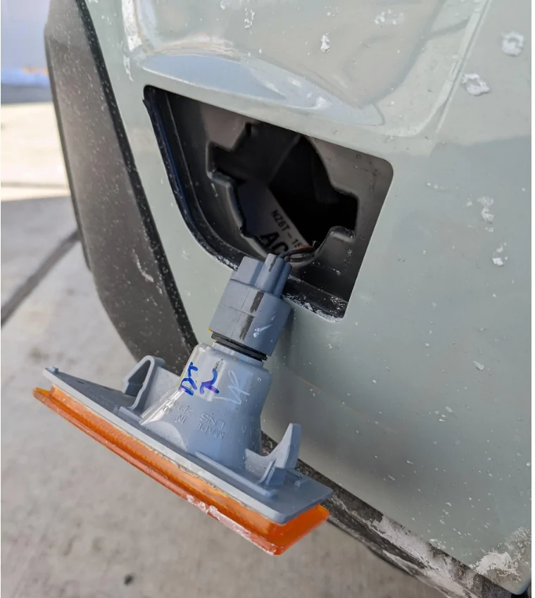

here is what it looks like from inside the fascia cover

Thank you for the photo, yes, my front marker assembly looks just like that with the clips intact, but, the mounting socket is pushed back and i can move it back and forth to an extent, almost as though one of the mounting brackets of the socket is broken and not the other. I am having trouble finding what the actual part number for that.
You can take the light out and use 3m panel bonding adhesive and set it back in place you'll just have to give it time to dry. Way better than epoxy on soft plastic
