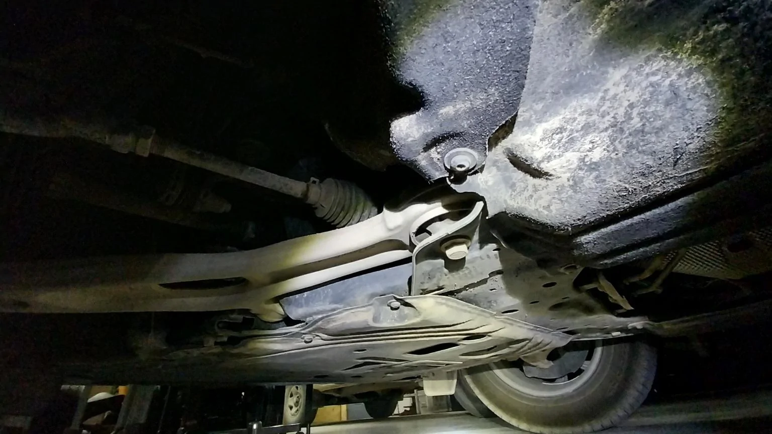

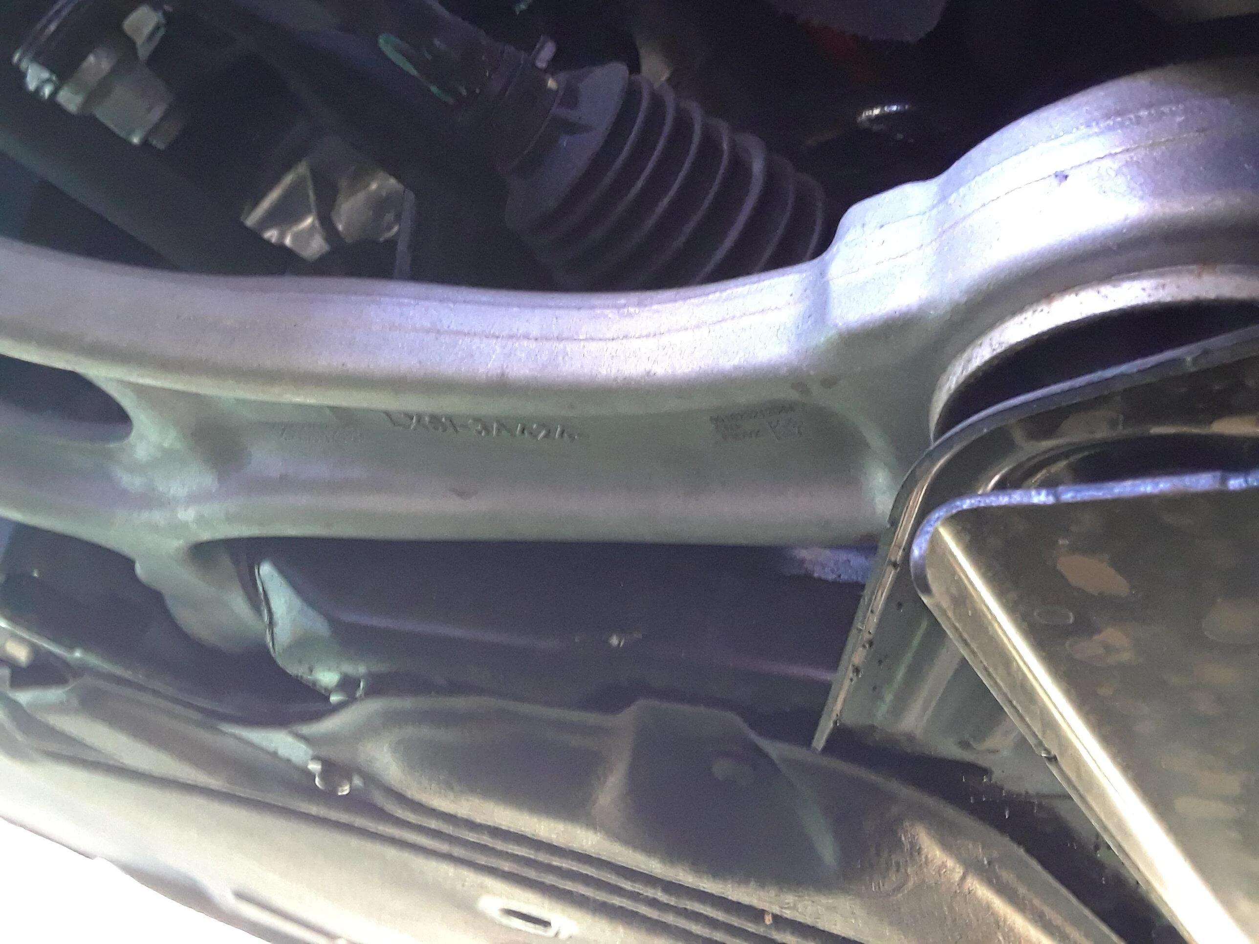

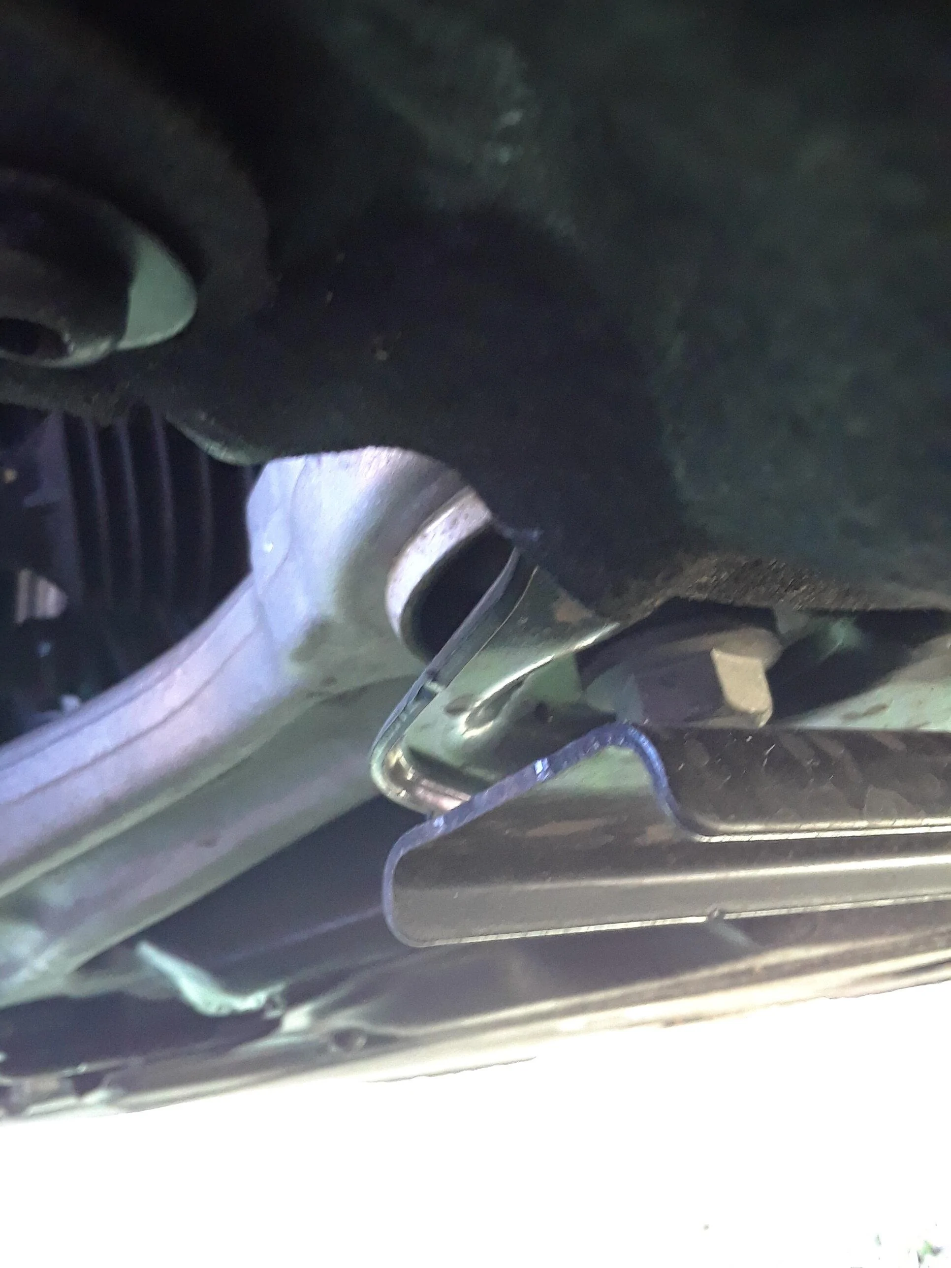

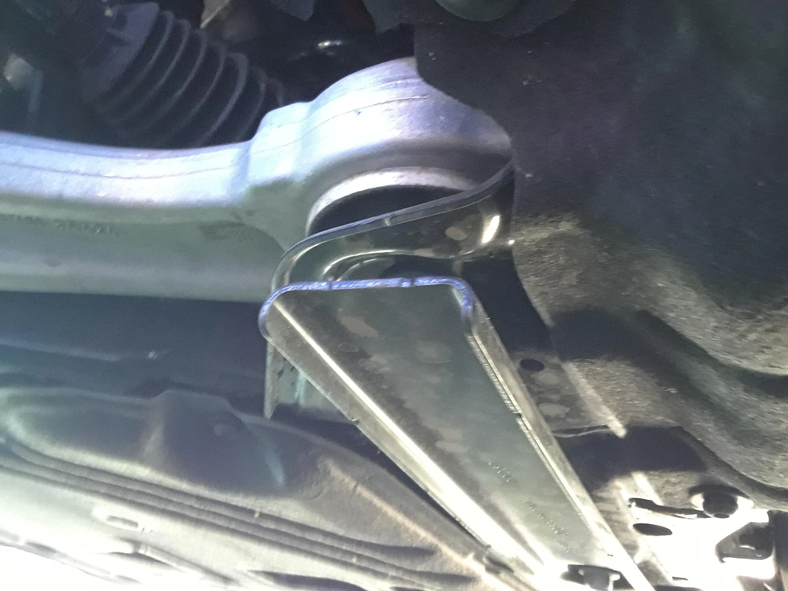

I jacked mine up at the rear of the front suspension cradle. I made a thread on it with a bunch of pics. Here:
https://www.mavericktruckclub.com/f...nch-weld-protectors-jack-point-musings.42422/
I have hybrid. Do you? Maybe you said you did already. If so that would explain maybe why you don't have the horizontal bar I am describing.
My pictures show a horizontal metal structure that goes across the truck and find its
end points below the bolt that attaches to the control arm that your jack puck appears to
be under.
I can't tell but does your truck have the same horizontal metal structure ? If so is your jack puck under that metal beam/structure that is just below the big bolt attached to the control arm? I didn't know the metal structure described would be bent by jack it up.
I guess alternative would be to jack not at the bolt location on the control arm but maybe 3 inches away from where your jack. It just dont know if that area would be flat enough.
I'm all ears. I hope I described it well enough
be under.

Looks like your hybrid has different underwear than my Ecoboost. Poop.

ok you have ecoboost that's why you don't have the horizontal rail.
Too bad I have one. not sure if i would damage my rail by jacking up on it.
I use to do that I my van, jacked it exactly where you did.
thanks.

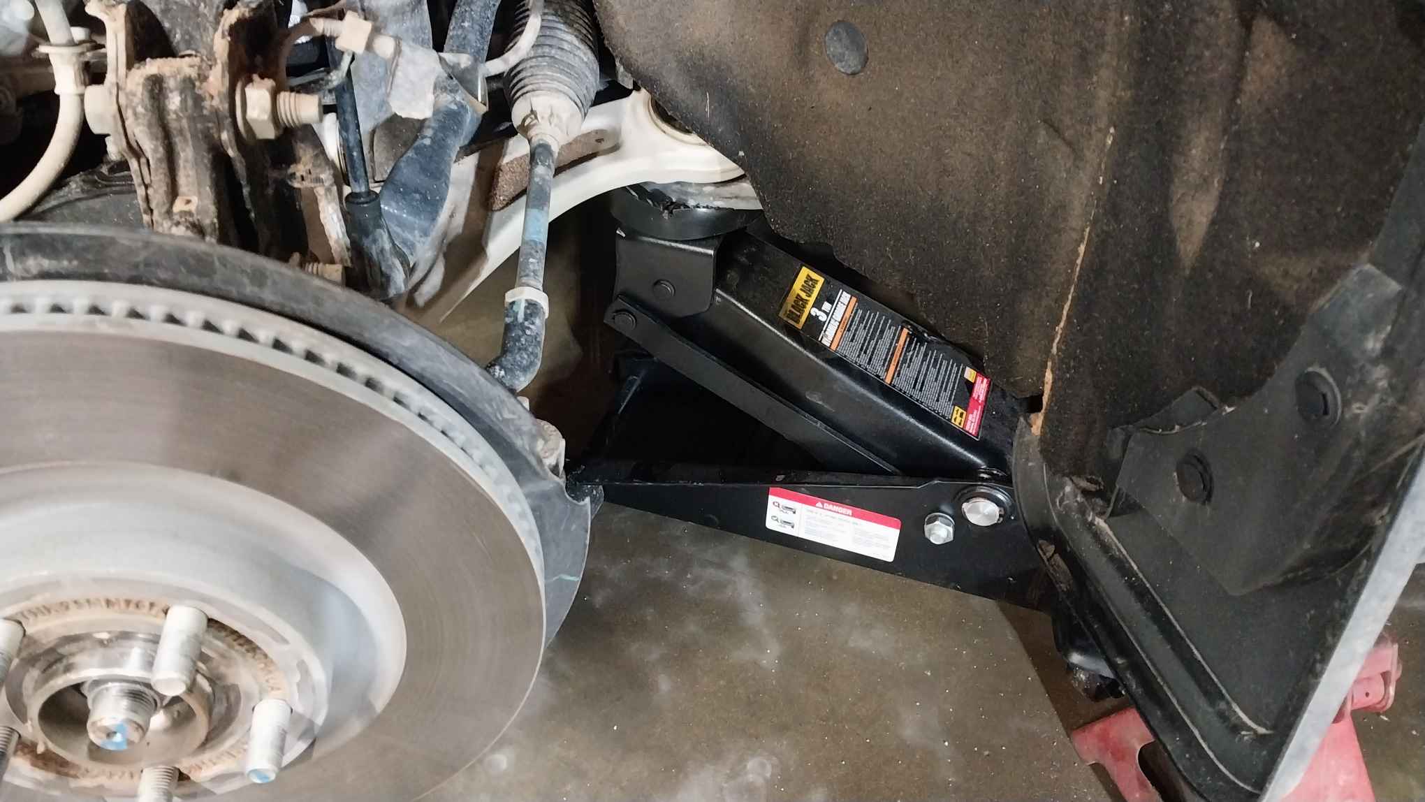

First time jacking up Maverick to put on the Summer wheels and it went well. I used the floor jack on the inside and Craftsman jack stand right next to it on the wheel side. Both on the pinch welds. I bought these protectors. Some protection is mandatory.
