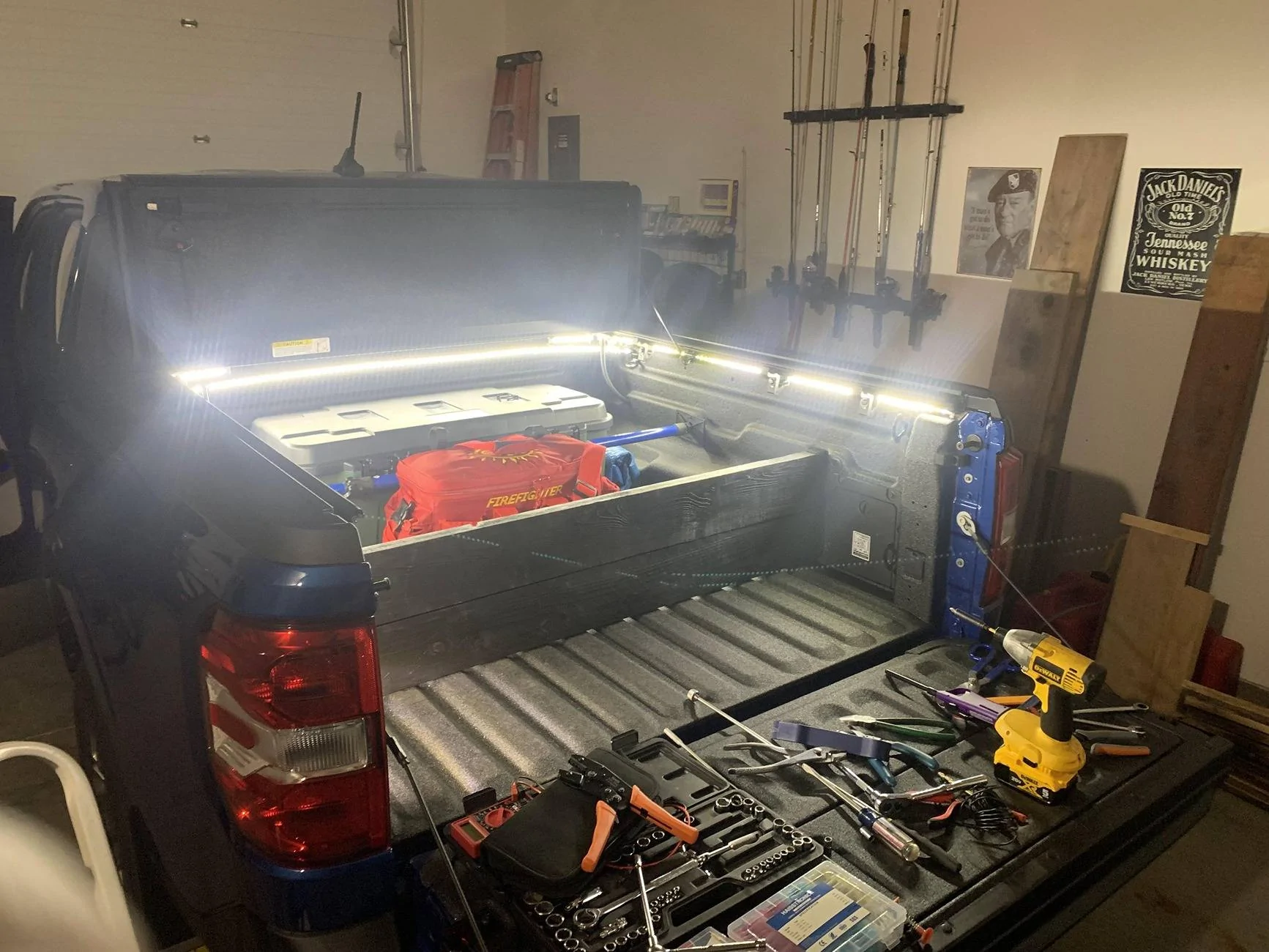

Ford Maverick Truck Bed Lights With spray in bed liner 2023_12_15_12_30_IMG_4157

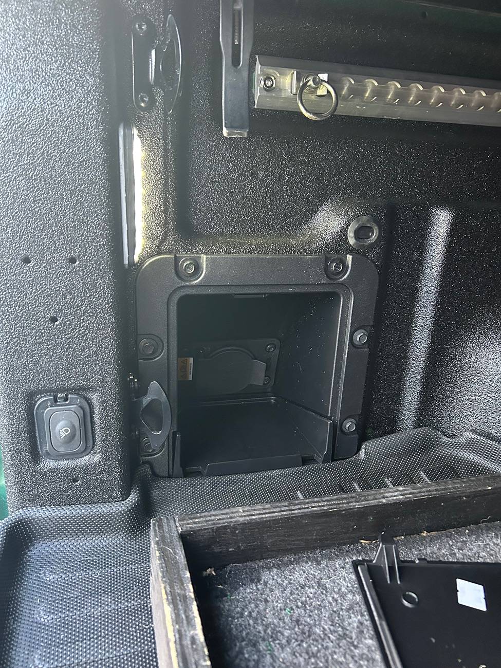

Chris Helfrick
Nov 20, 2021
46
Hanover
2024 Maverick XLT 2.0
Don806
Don
Oct 3, 2022
1,211
1,181
SE Ohio
Is that an OEM switch or just mounted in the existing cover?
the oem switch, just moved it into the 12v outlet cover. cutting out the cover wasn't real easy, and have to take the switch apart to get it in the opening, then re-assemble and install but it's possible. I didn't "splice" into anything factory, just bought a plug that attached to the OEM light wiring and then attached the lights to that wiring.
