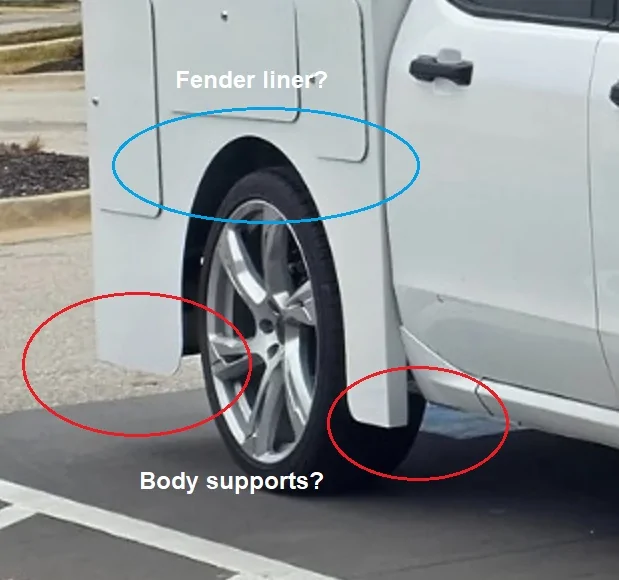

**Photo is a screen capture, from a "Redneck Garage" video.. #2 I believe.**
Was a good change to see the inner workings. So, Couldn't pass up the chance to examine...
It would make more sense (but more work) to utilize any existing mounting points..
If you look at the forward sheet metal, there are no supports.
Ford Maverick First service bed Maverick... my custom build {filename}
Don't get my wrong.. Great idea.
Can it be mass-produced.. :unsure:
Jerry
Incorrect. They use factory mounting points. They are just not visible in what you see..I built it i should know

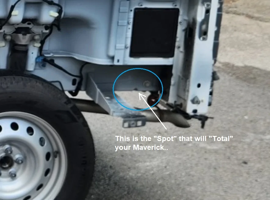

And since, we are in this "Area" of the Maverick's structure...
This is the "spot", that "WILL Total" your Maverick.. 😭
Ford Maverick First service bed Maverick... my custom build This-is-the-spot-total-Maverick

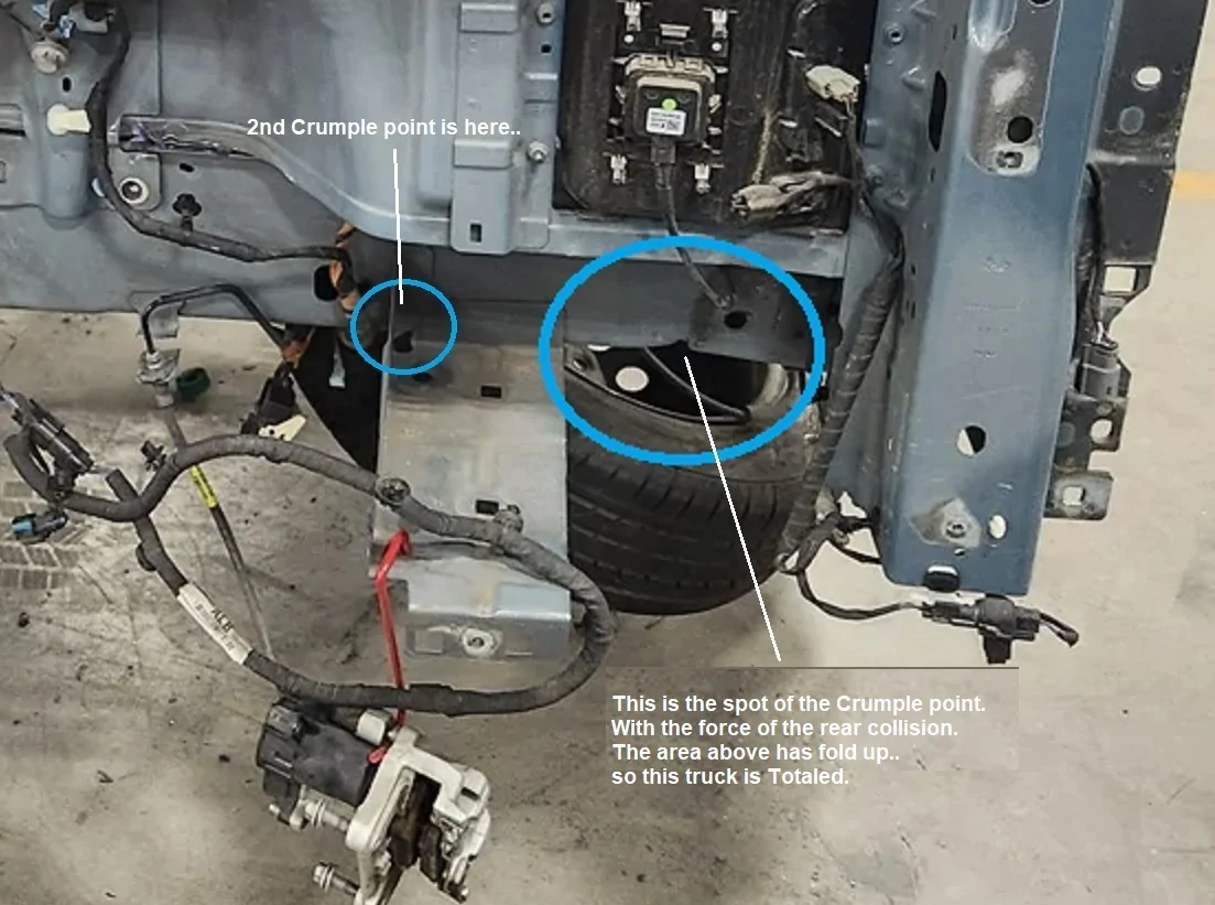

Not to hijack this thread - but what does this mean? Please elaborate. If there is a rear impact and damage up to that point, it won't be repaired and it will be considered totalled? Is that what you mean?

My Original post...
YES! There's actually TWO locations. The "REAR-MOST" one is shown in the photo above.
With enough force.. The integrity of the box frame will fail and the whole section MAY collapse.
And as posted in this... Thread.
https://www.mavericktruckclub.com/f...hop-unable-to-drill-out-all-spot-welds.77088/
Ford Maverick First service bed Maverick... my custom build spot-of-doom
It's like this...
Take a soda can and put a slight "Dent' into one side. Then, press down on the can, with one hand. it may NOT crush.
BUT, if you take your other hand and "pound" down on your first hand. There is enough force to crush the can...
So, The frame will take "Just enough" force before it fails... 🤔
