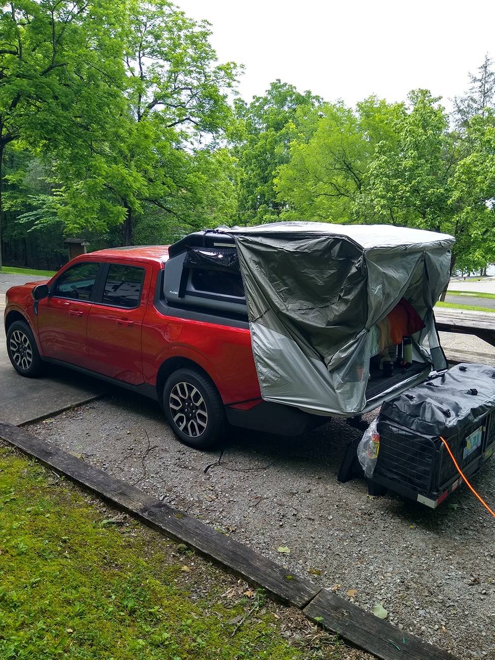

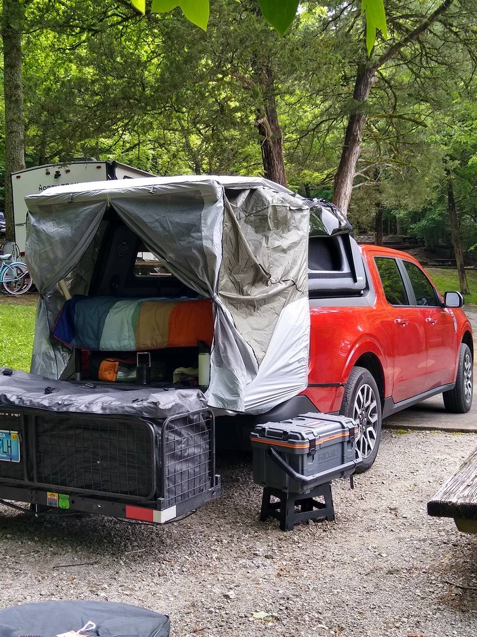

I just used an Amazon cheap tailgate tent,think it was like 25 bucks.Had to install 3/4 " PVC and pool noodles to support where SUV hatch normally holds up roof area.I also have the Napar SUV tent which is nice For staying on same site for several days.
Ford Maverick Custom built truck bed cap for my Maverick IMG_20240524_151449394_HDR
Ford Maverick Custom built truck bed cap for my Maverick IMG_20240524_151553876_HDR
