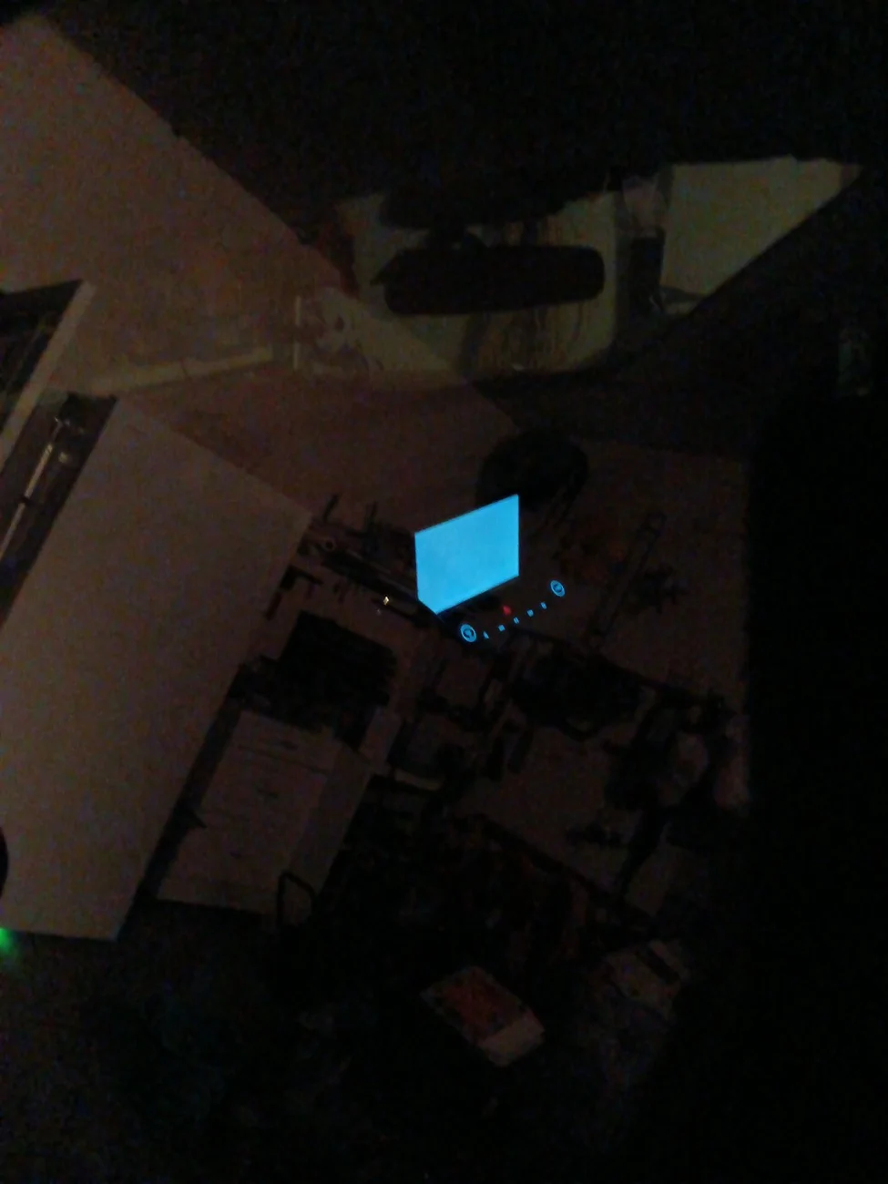

Hey Darryl, yesterday my 22 lariat with 14 month old BXT99RT4A MAX series warranty replaced did this on shut down. Double lock did not finish radio turn off just snow on screen. Should I have remote service come out to read any error codes or can I drive it in to have them read? Took 7-10 minutes for screen to go dark and some additional time for lights below screen to darken. Pictures taken through driver's door window.
I'd take it in. It's safe to drive.
