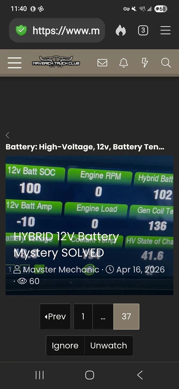

Good day @adjayhawk
If you haven't done a search yet here on MTC, about 12 volt topics...lots to see!
Begin with this very long thread (read the beginning and skim for pertinent 12 volt questions and answers).
Long story short, till you read up on it, turn your headlights or park lights on when driving...day AND night...somehow tells the truck to charge the battery more fully.
Lots of contributors (including myself) and the OP who found this help for our batteries and have been trying to help others.
