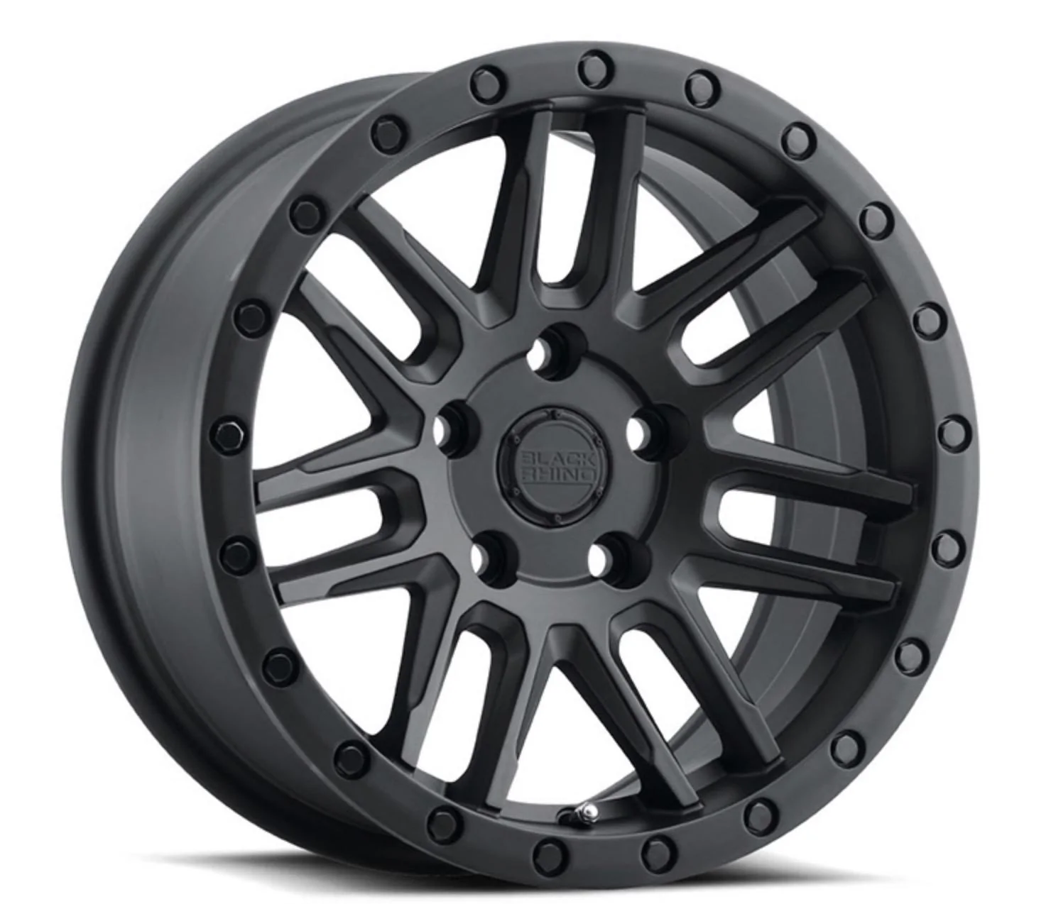

Also, I am considering the Black Rhino Arches wheel but it only comes in a 17x8. I want to put 245/65/R17 Falcon Wildpeaks on it. Is 8 inches too wide for that size tire? I was looking a chart that suggested 245's needed to be married to a 7" wide wheel. Any thoughts?
No issues when Discount Tire put 245/65s on my 17x8 Reikas

I ordered the Nitto Nomad Grappler since they were 34 lbs each. Gonna pair them up with Black Rhino Arches Wheels in 17x8 which is a 25 lb wheel. (Part # 1780ACH305108B76)

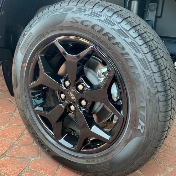

Does anyone know the weight of the FX4 wheel with no tire mounted?
Wondering this as well. Guess I'll have to break out the scale.
To be clear, this is the gloss black one here:
Ford Maverick Factory Tires Sizes & Wheels Specs For 2022 Maverick: Width, Offset, Bolt Pattern, Center Bore, Thread Size, Weight 2022 Maverick XLT FX4 Black Wheels
I'll grab a wheel from storage tomorrow and check.
