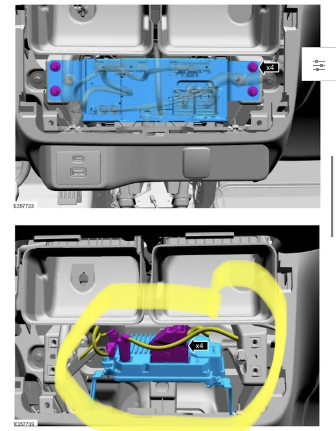

I am going to have to partially walk back the APIM being in the XL and XLT models. The parts catalogs all say that regardless of trim there is an APIM module in the Maverick, same one as on 2020 - 2023 Mustangs for example. The difference they claim is whether SYNC is enabled by what head unit is installed on the Mavericks.
The As built data for XL and XLT Mavericks (I ran about 10 different VINs in multiple config packages) all come back the same showing no programmable registers in the 7D0-xx-xx range which is reserved for APIM modules.
So next I started pulling out my audio head unit on an XL and there is no APIM connected to the back of it. Just a wire going to maybe a non programmable or needs to be programmed differently for connected touch radio software type of APIM or some new as of yet undisclosed module for connected touch radio setups that forscan doesn't have functionality to access as of yet. I didn't want to rip apart the center console any further to find out.
I do know this much when I pulled the plug from the head unit the radio turned on to the last station I had on the head unit with the key out of the ignition. It has some sort of tuner independent of the head unit, just what it is I don't know.
I need to get a wiring diagram from a shop manual and/or the Ford IDS software to query the system to see what is there and if there is programming access to it.

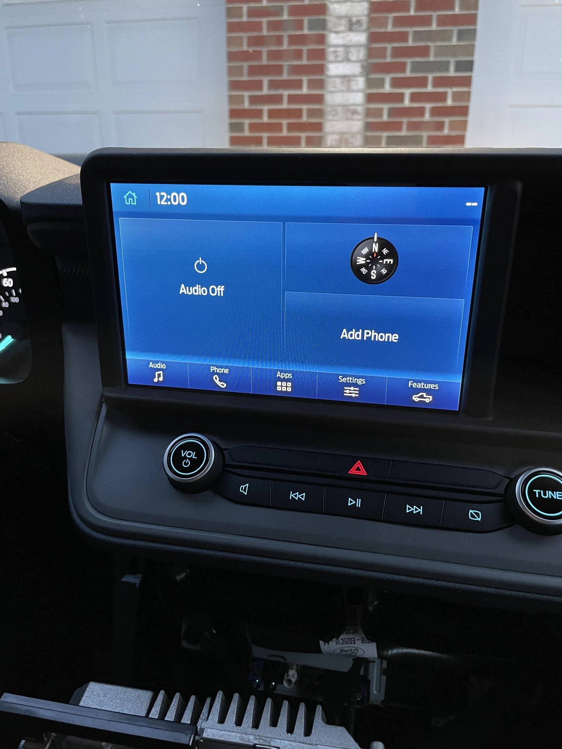

So just a little tease of what @propp2531 and I have been working on….
Ford Maverick No APIM  in XLT and below (Unable to upgrade Sync) 21A7F213-0F38-4621-B8CD-125814EF51BF
Yes that is Sync 4.
Yes that is a Maverick XL that it is installed in.
No it is not fully functional, yet…. This was just the first boot/proof of concept. Next up is working on the As Built data to get everything functional.
Yes that is Sync 4.
I love it. Great news...keep up the great work! :cool:
Yes that is Sync 4.
did you get this to work???
