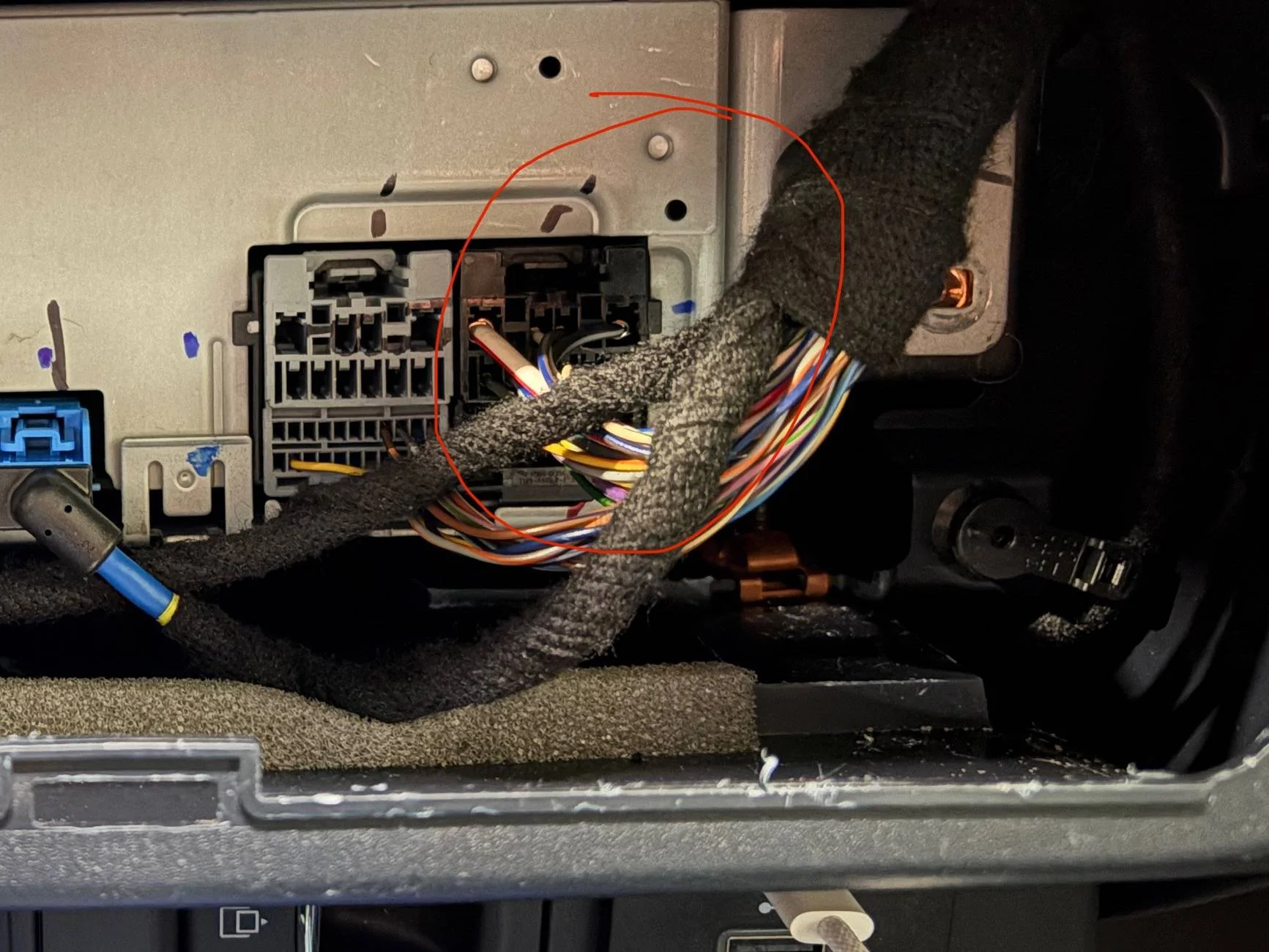

Out of curiosity, what is the brown/copper antenna for?
That should be the GPS antenna connection I think, but someone else please confirm/dispute. Appreciate all the info on your install thus far!!

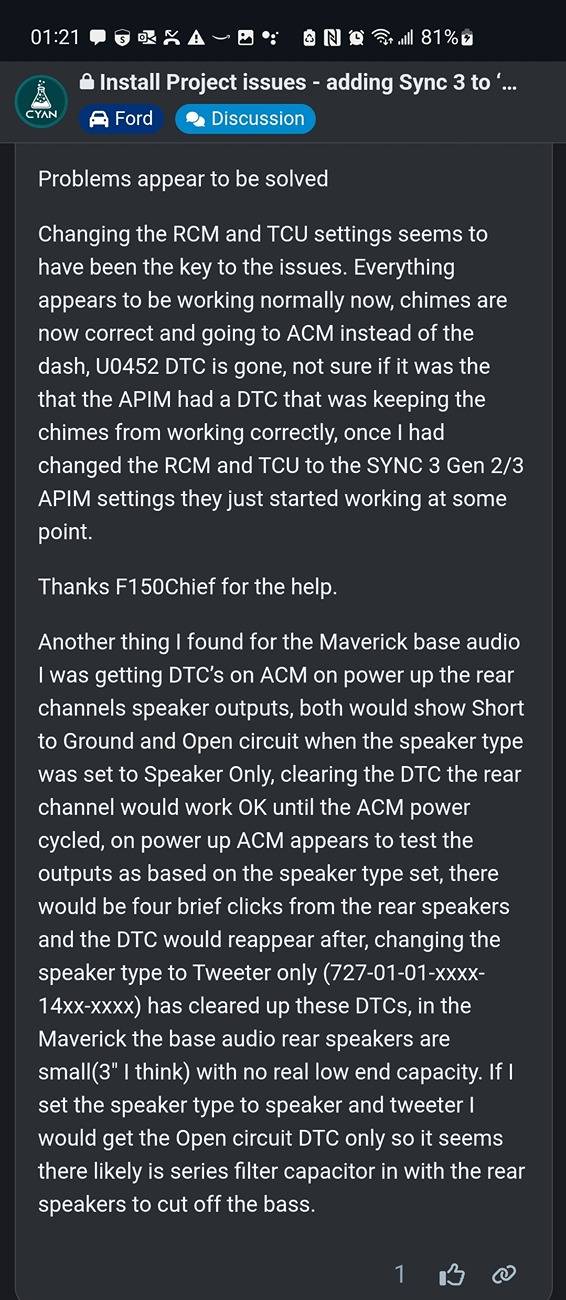

I wonder if this would apply to the B&O system as well. I noticed when I checked Forscan yesterday that two channels (I believe 7&8) are showing open circuit DTCs.
Very odd that the APIM would cause this particular issue.
Sounds like it's worth a shot to me.
I was considering checking these actual amp for the B&O that’s hidden behind the rear passenger seat and seeing if there was a way to reset it or tinker there to see if it would fix my issue.
It seems impossible that I messed up any writing related to the speakers. Two different harness’s with the same issue and the only other cable is the black speaker cable that’s plugged into the ACM which was only removed and plugged back in and looks perfectly fine to me?
also the fact that audio works fine with the old APIM.

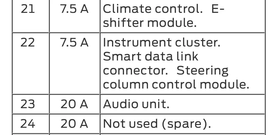

Alternatively, I could remove and reset the fuse for the sound system and see if a hard reboot helps? I’m assuming it’s fuse 23 (This is from the 2024 Maverick Owners Manual).

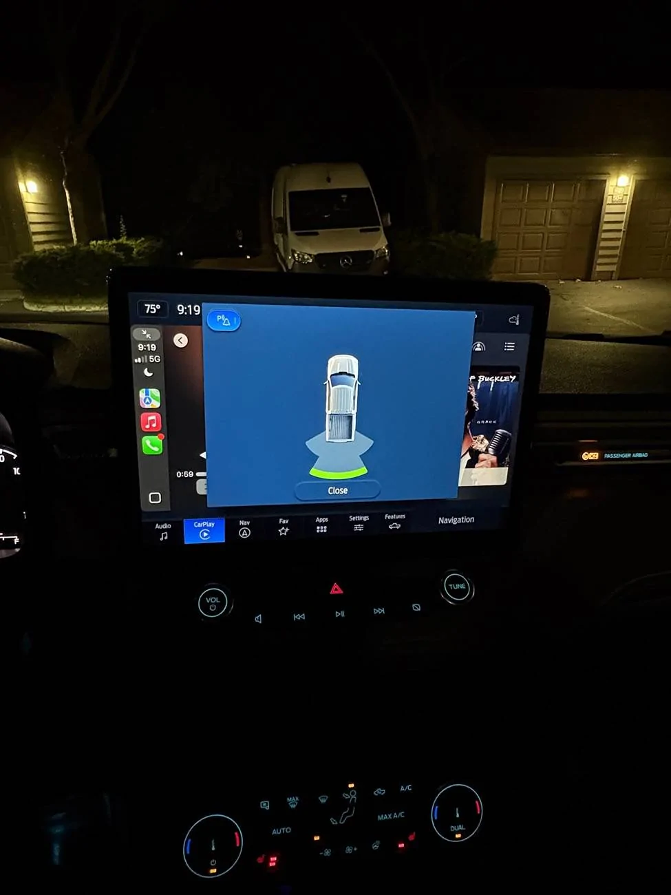

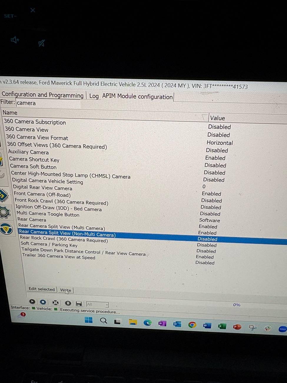

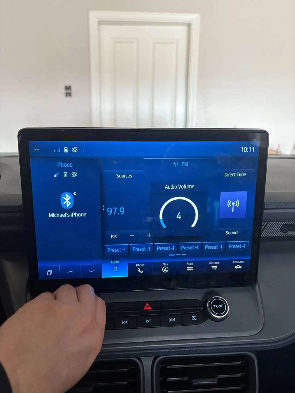

Update #2
After using an as built for a 2024 F150 Lariat I found it to be a surprisingly good starting ground. It solved problems 1 & 3 listed above for me right away. After enabling some features like ambient lighting and disabling features that didn’t apply we are in pretty good shape.
The one thing still not working is the rear view camera. With the previous as build on this APIM it turned on when the truck was put into reverse, but was dark and buggy. After switching to this as build, even with rear view camera enabled in Forscan, putting the truck into reverse only brings up the parking sensor screen. The camera does not turn on. Below is a photo of what I’m referring to as well as my Forscan settings.
At the moment, I am unable to find a fix. Any ideas?
I have the exact same problem., the APIM is from a 23 F150 Lighting. When I installed the SYNC 4 APIM, the rear camera worked perfect, but them I made some other changes in Forscan and the camera stopped working and I get the same parking sensor screen. Did you find a solution to the rear camera not working? I have tried several setting, but no luck. Please help.
