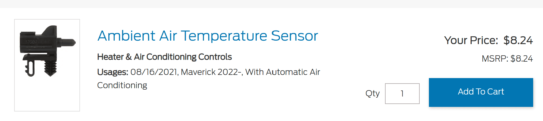

$290 parts and labor.
We had same issue for same reason in San Diego. Dealer estimate was $700, came in at about $500 because "we didn't have to take bumper apart all the way" they said. Where are you located? Could you share picture of charges?
