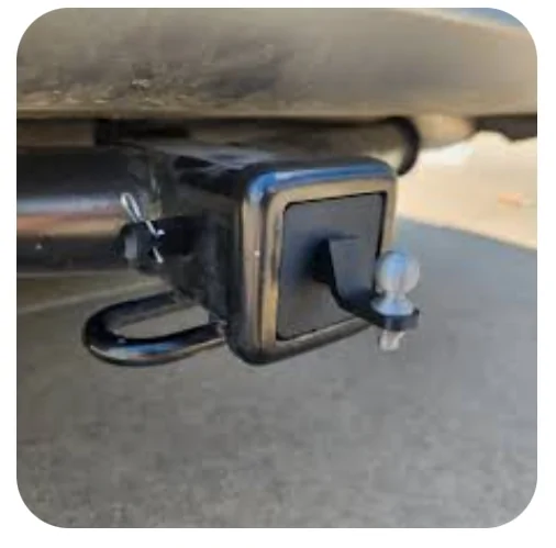

This goes right along with the, 'What kind of hitch ball should I get for my little Maverick?'

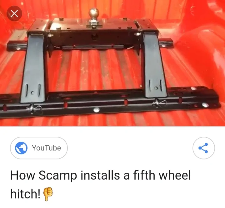

I'm waiting to see the fifth wheel in the back of a Mav with 4K tow package! Haha.
Possibly for one of these? I know you were joking but I came across one of these on FB a few days ago and intrigued me. The hitch weight exceeds the 400 lb limit but it wouldn't be using the factory hitch receiver. Wonder what the rating for a 5th wheel hitch would be? I kind of like this option if I were to buy a RV.

Unfortunately, when contacted in 2024 Scamp confirmed, that their fifth wheel hitch is not compatible with the Ford Maverick's unibody Construction.
