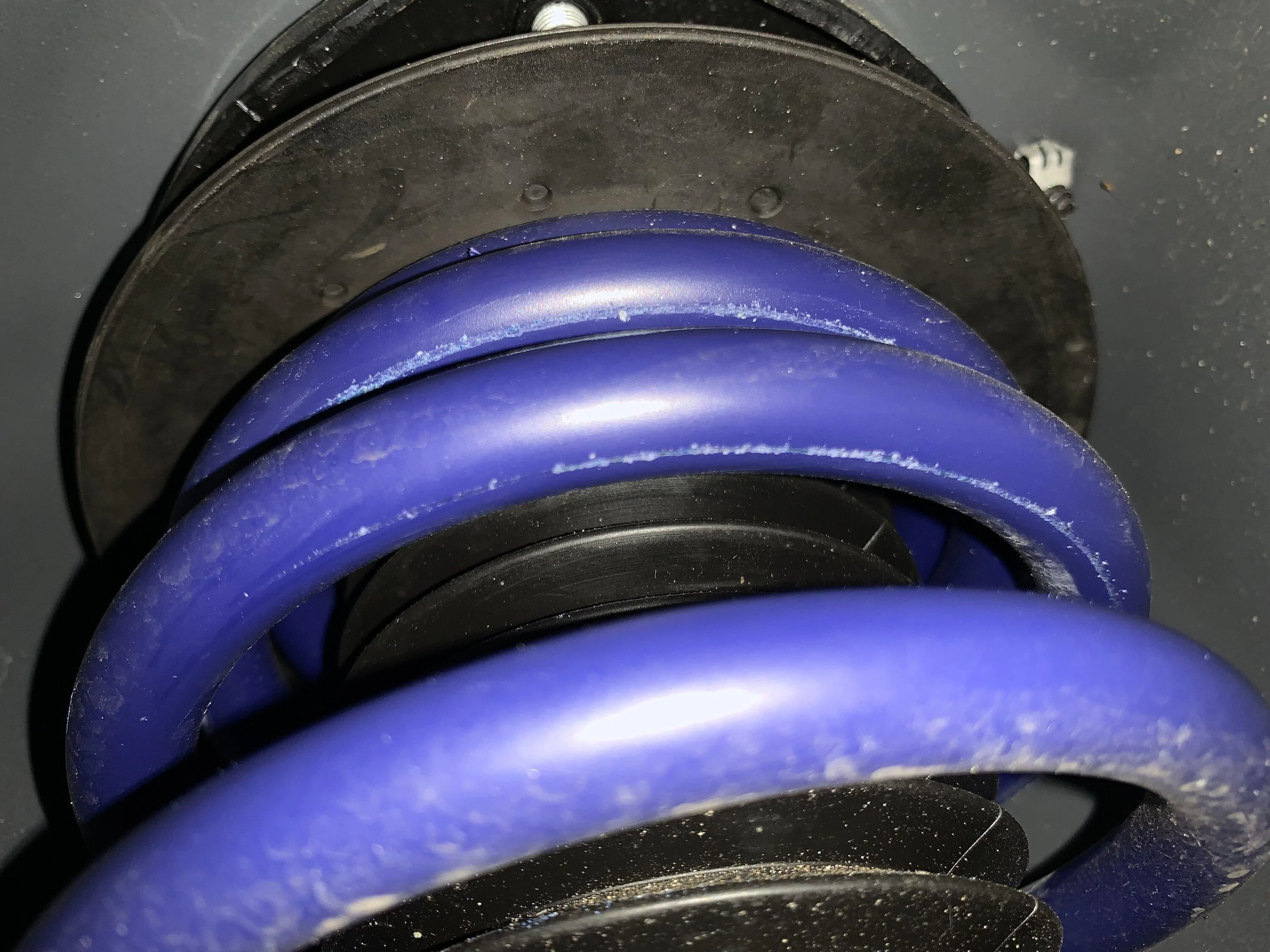

This is my front passenger spring with the front end jacked up and wheel off. There’s definitely contact. Couldn’t get it in the pic but on the very top coil there were a few small flakes of paint that actually chipped off the spring. I have a gopro and plan on putting it under there, Hopefully this weekend. It will require removing the fender liner though as I don’t see any way to mount it without doing so.

Have you checked your struts? If the internals are broken somehow, the rod can shift side to side in the shock body and cause a "clunk". Had it happen to a Bilstein strut on my old car. Car drove fine but would clunk when turning into a parking lot. Just throwing it out there, haven't seen any new ideas come up and I've been watching this thread.

I haven't checked mine as of yet, but they only had 500 miles on them when mine first got installed. Not saying it can't be that, but it's unlikely.
