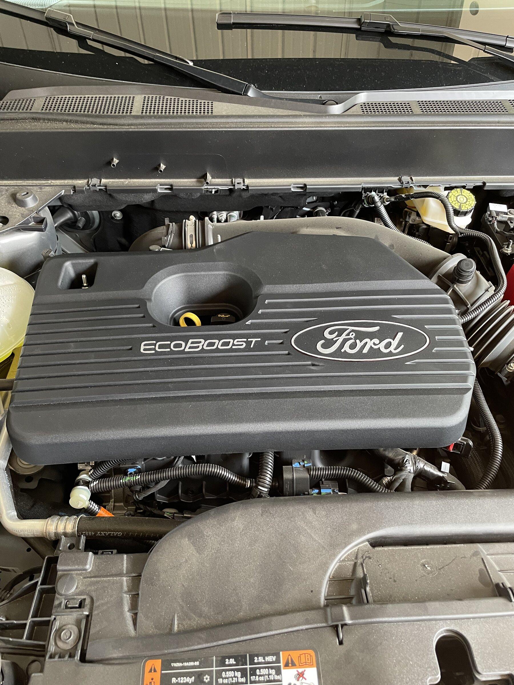

Had a guy tell mme that the engine cover would void the warranty due to holding to much heat. He claimed to be a Ford Engineer. Anyone heard of this before

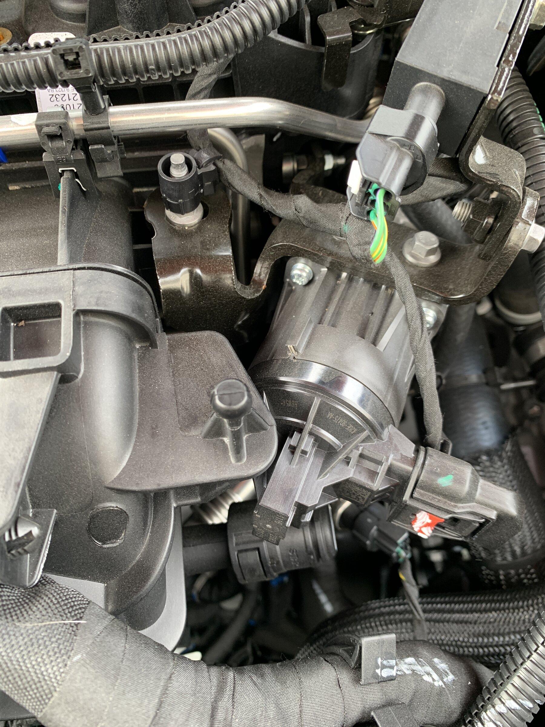

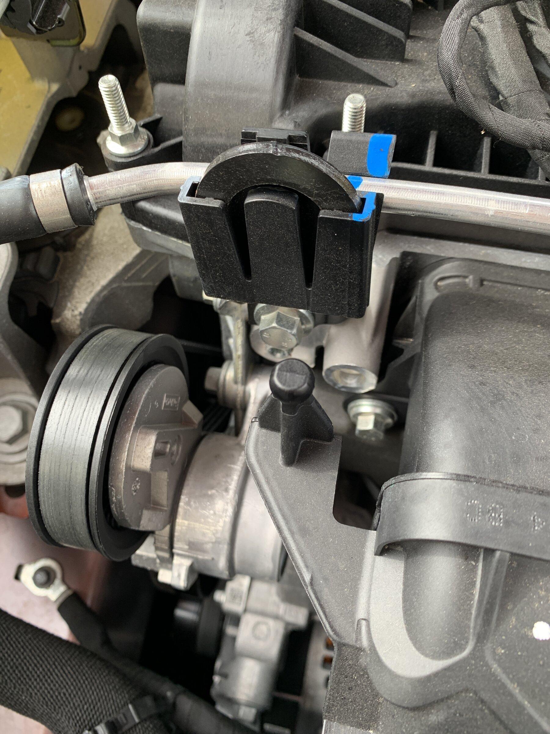

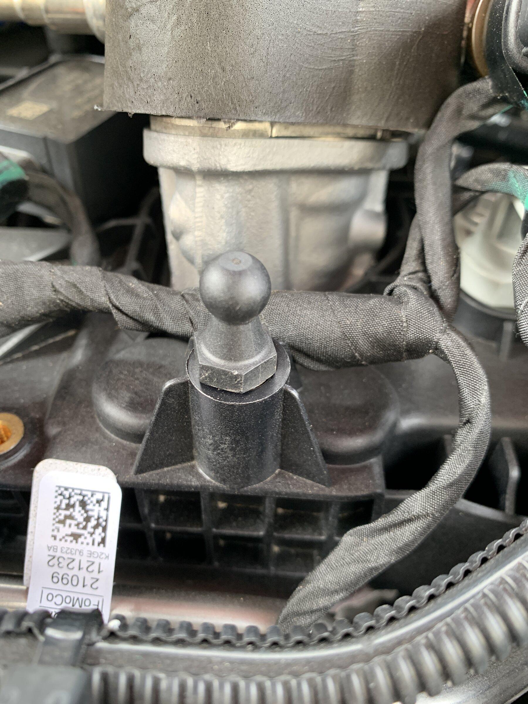

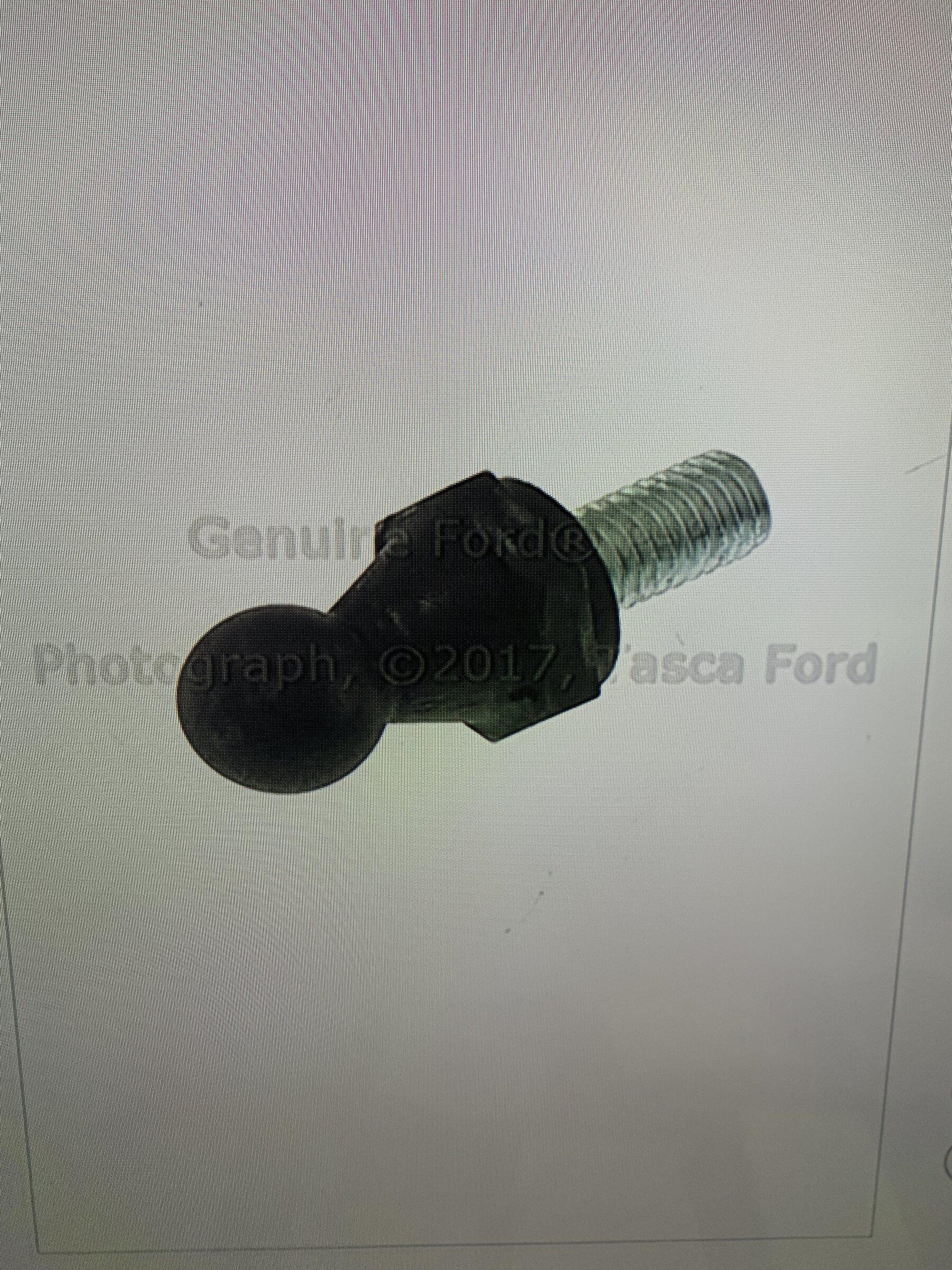

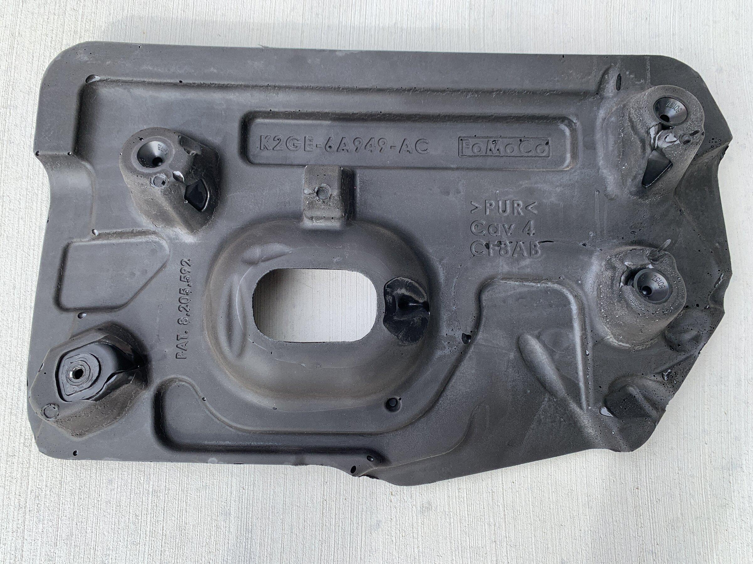

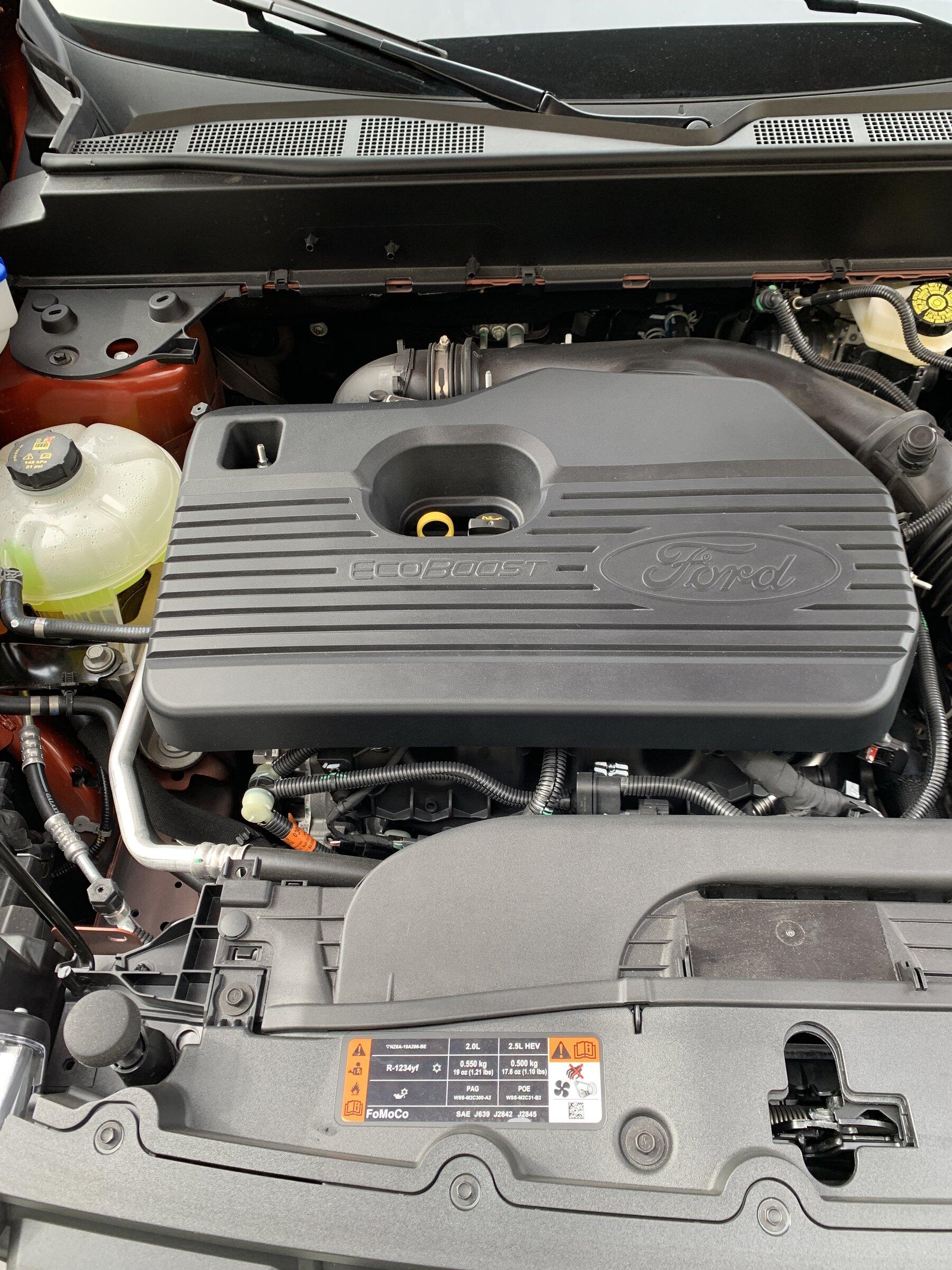

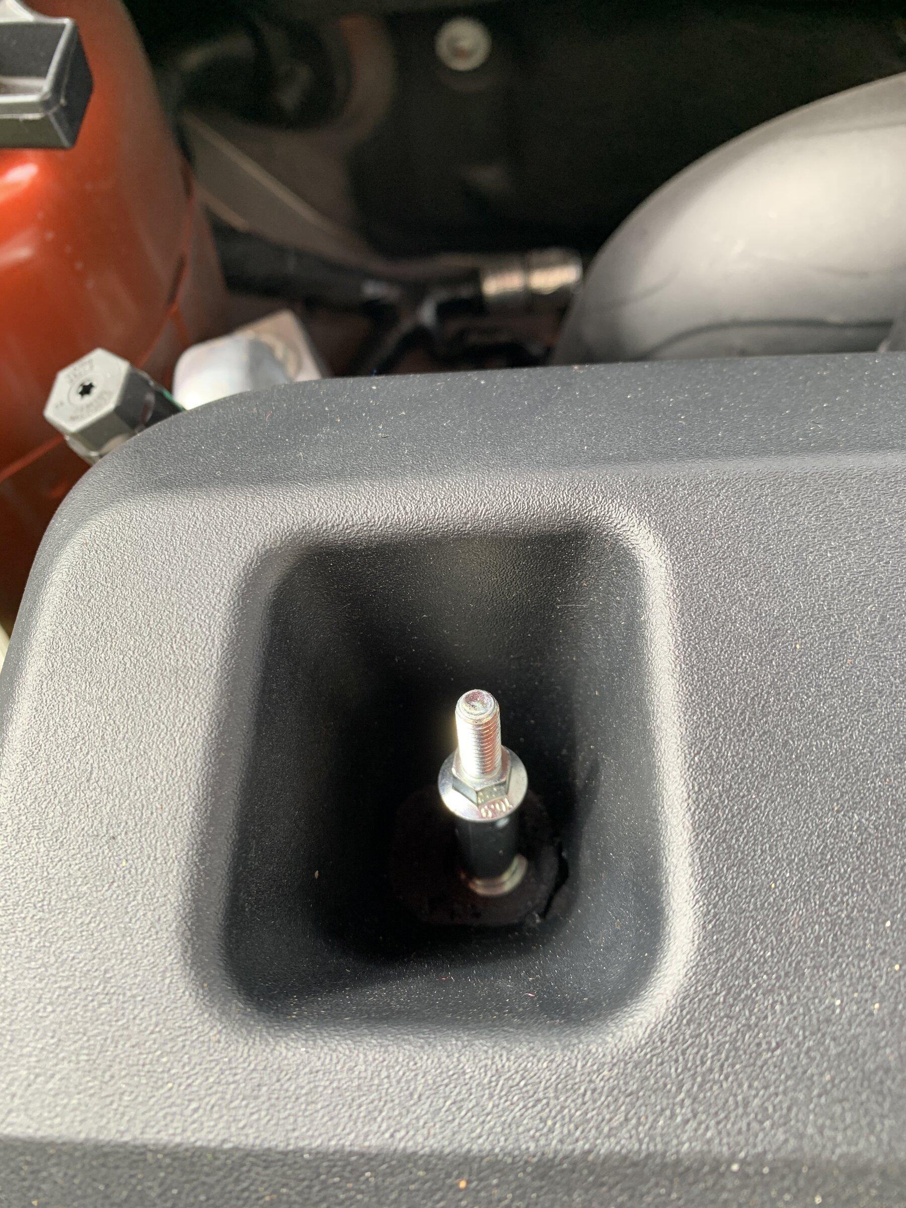

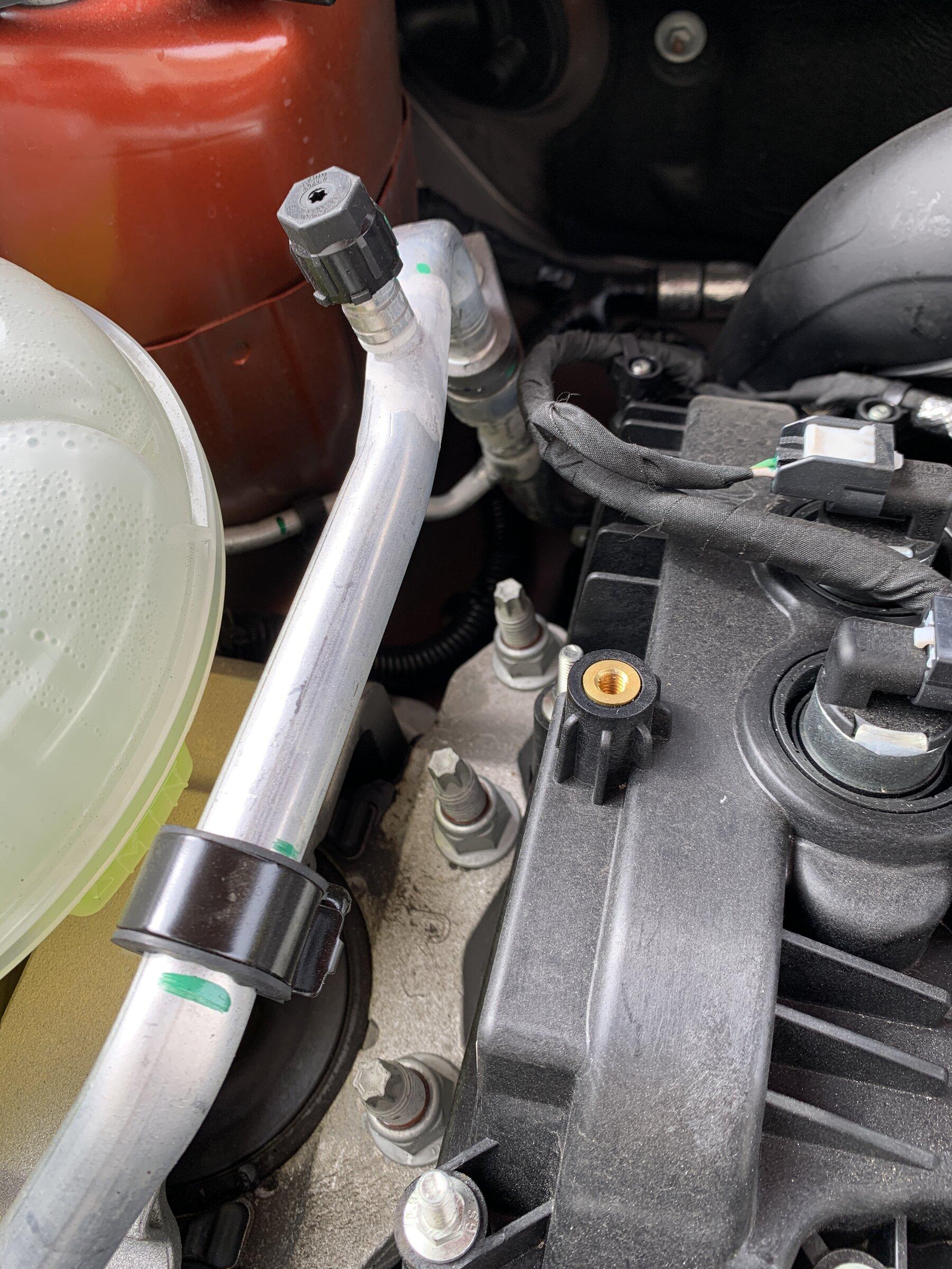

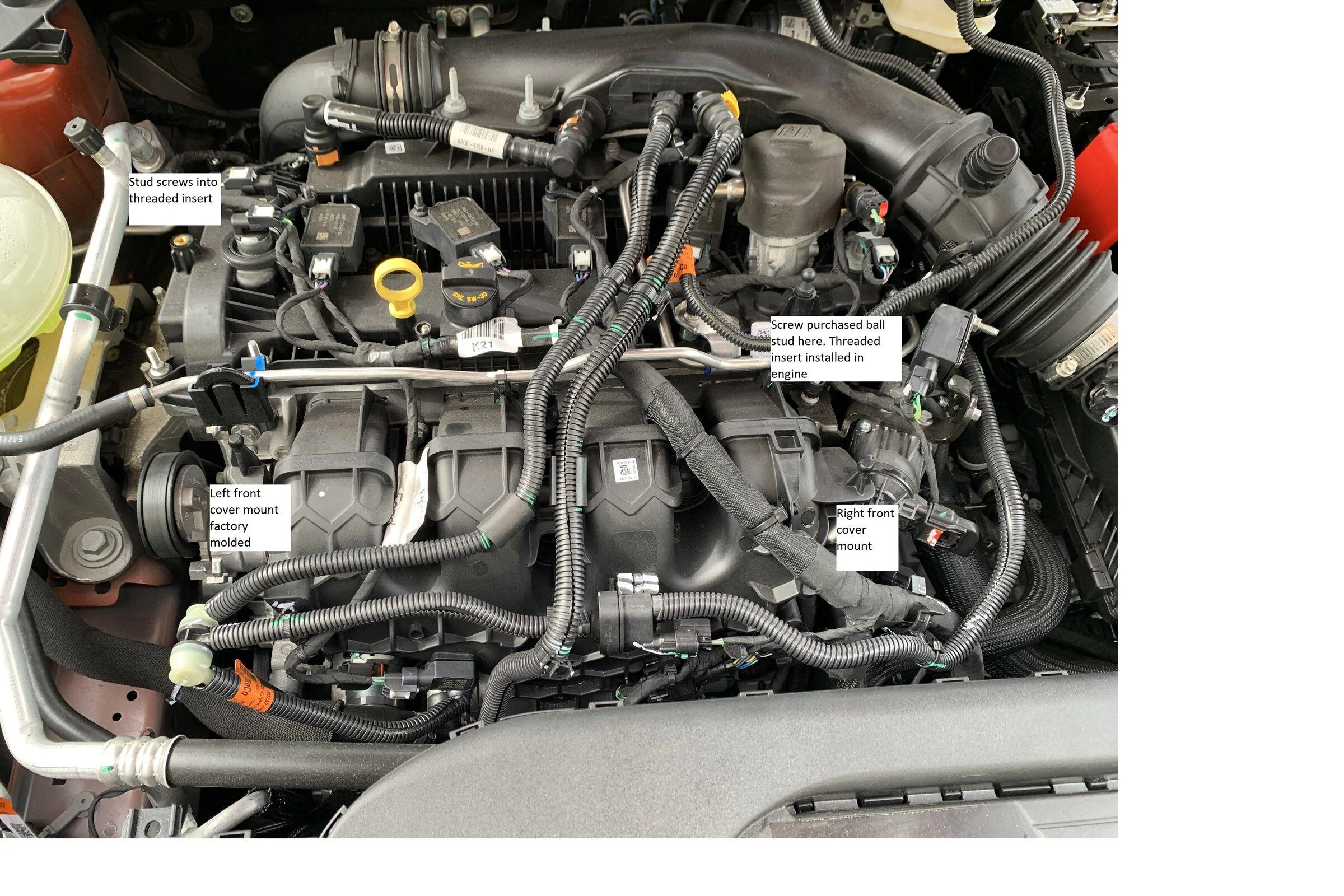

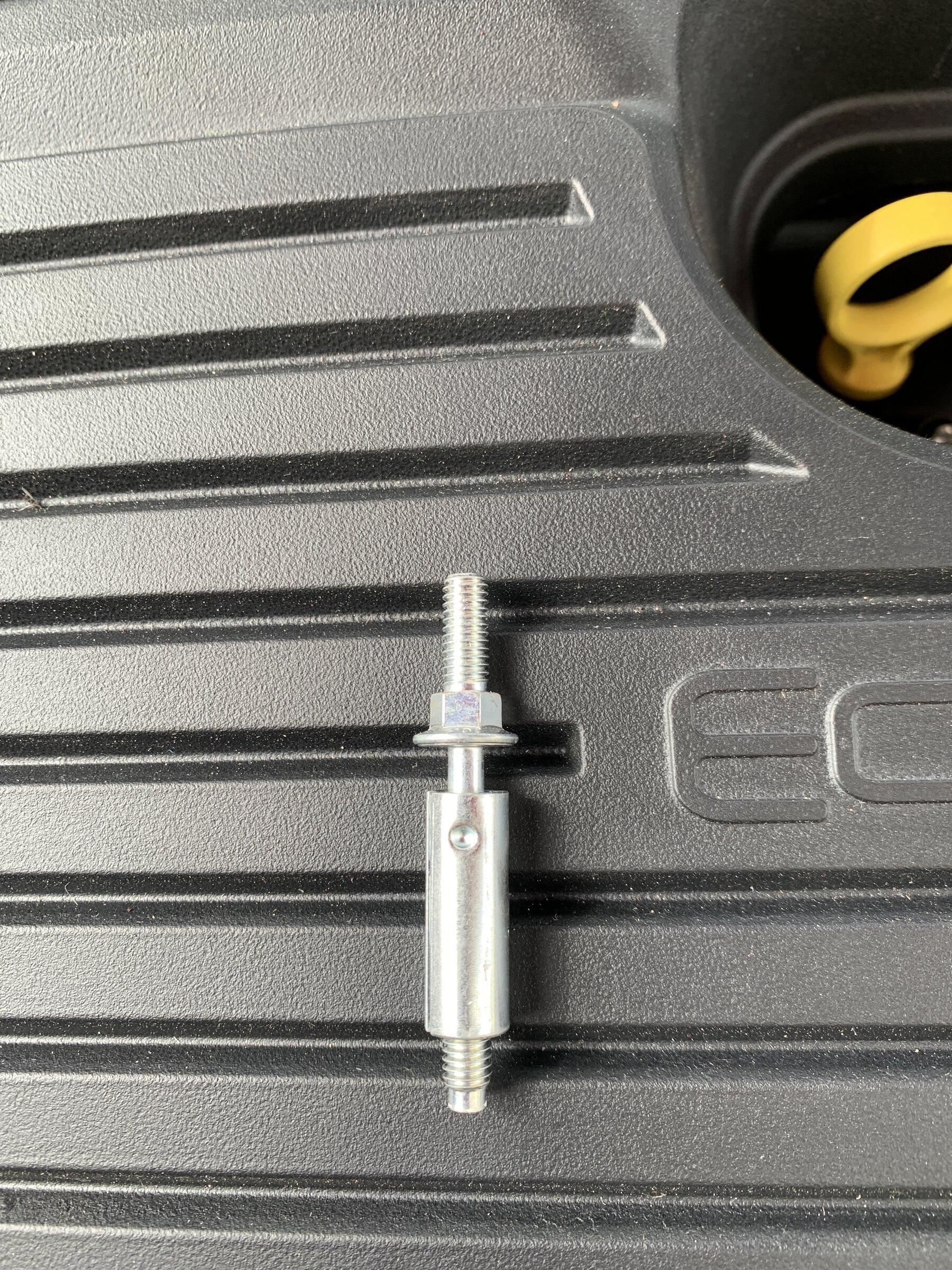

As I am a newbie I hope my post turns out okay. I have read about some confusion as to the parts required for the Ecoboost engine cover. My pic of the ball stud looks a little sketchy but hopefully it will suffice. The part that seems to give the most trouble is the driver rear ball stud. Use part #AA5Z-6N958-A for a perfectly flat fit of the cover.
Cover #K2GZ-6A949-A
Pass rear stud #AG9Z-00812-D
Driver ball stud #AA5Z-6N958-A
I have included a pic of the ball stud. The other stud is listed and shown when you search for the engine cover.

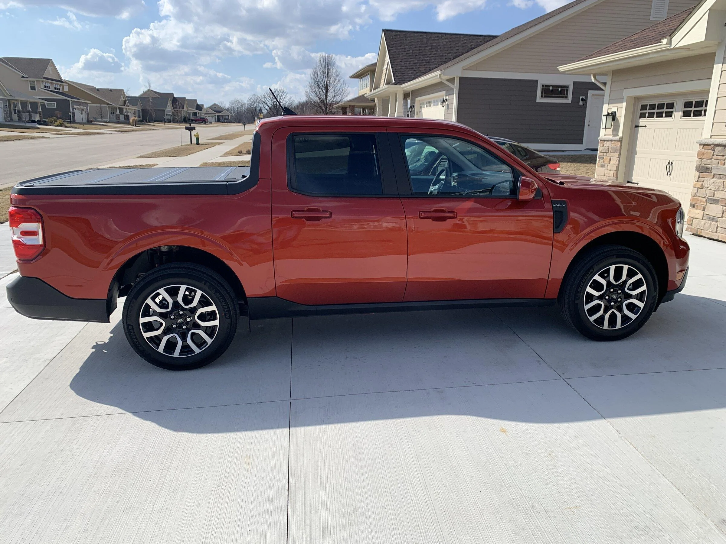

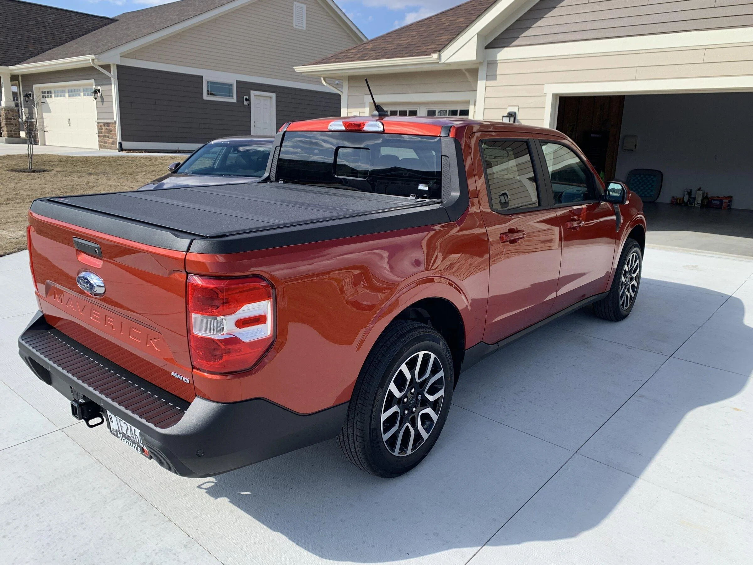

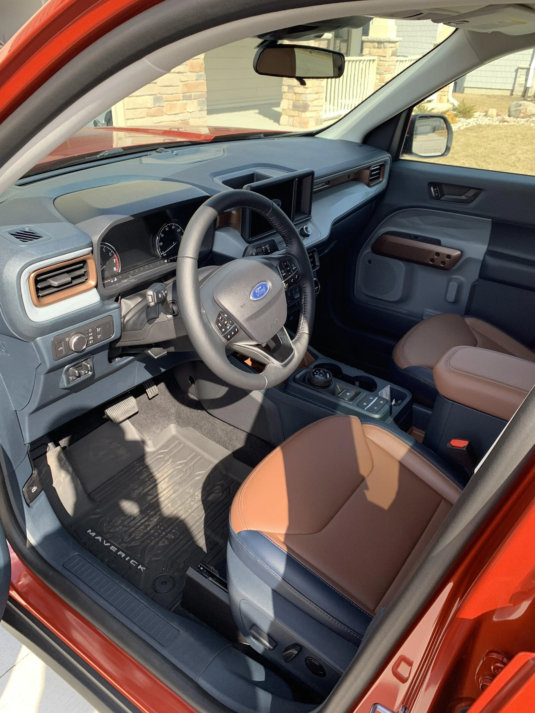

Also a few pics of my fully loaded Lariat, ordered July 15th, built October 8th, delivered January 22nd. only have 250 miles but so far I love it. It is as I had hoped, a perfect replacement for my sedan as it is the ultimate utility vehicle. More practical than a similar sized suv for me.
When I ordered mine they sent 2 (different part #’s of the passenger side stud. Did a little more digging and found the ball stud for the drivers side. Got it overnight and it was perfect.

Lol, no. That engine isn't specific to the Maverick, nor is it going to overheat the truck. The only thing that might happen is the fans upfront might spin 1 RPM faster for something. 😂

Yeah I know, everybody is an engineer. Not sure where he came from but he didn’t appreciate me calling him out on it.

That insulator you have a link to is for the 1.5L ecoboost. If you enlage picture you see it for the 1.5L cover.
https://www.oemfordpartscheap.com/a...ransaxle-Engine-appearance-cover/BS21260.html
Doesn't look like the 2.0L ecoboost cover uses an insulator
https://www.oemfordpartscheap.com/a...ransaxle-Engine-appearance-cover/BS21295.html
The insulator that they are talking about on the Bronco forums is the under hood insulator, not the under engine cover insulator.
Also you need the following size wrenches/sockets:
Pass rear stud #AG9Z-00812-D (8 mm)
Driver ball stud #AA5Z-6N958-A (13mm)

Thanks for the post. My Lariat is the same stud no problem. I have the all wheel drive and looking at this engine bay I am happy I sprung for the extended warranty because I just see a lot of labor hours to do anything on this truck. I am glad I looked now.
