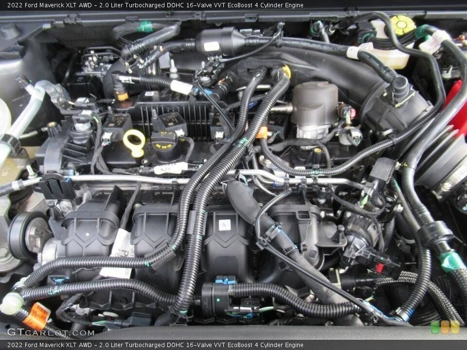

There is something shown on most engine photos and instructions on coldair intake instructions my truck does not have.
A tube on the firewall side that runs from the intake plenum just behind the air box through a bulb looking thing back to the area just before the down tube to the turbo. I don't know what it is for but my 23 Lariat did not have it.

It's for the vacuum brake booster, Lariats with adaptive cruise control have an electronic brake booster and do not have that hose.
Thanks. That is why I don't have that. I have acc.
