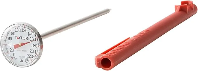

I'm your neighbor from Gilbert, AZ. It's all about "Delta T", the difference between the air temp inside the cabin and the air temp the system is able to put out from the registers. Delta T for a good system is 15-20°. But humidity also matters. More humid=more difficult to cool.
I have a small thermometer like this: Amazon LINK. You can buy them at AutoZone, too, etc. Which takes the guesswork out. It will slip right into the register. I keep mine in place there always.
Ford Maverick Does the A/C in the 2024 Mav Lariat actually get cold? 61MD5Ti1ocL._AC_SX679_
My 2 month old '25 Hybrid in Arizona will output ~50°F cold air (after a while) set on "LO" when it is >100°F outside after work at 4pm. That is cold, but not ice cold because the cabin air is probably around the high 70's after like 5-10 min. It takes a while to output 50° air because it is about 130° inside when I first open the door. And it won't ever get down to 60° inside because it's hotter than Hades outside. I'd guess on the afternoon drive home it never gets below 70° inside even at the lowest temp setting with Recirc on.
When I start driving to work at 6:30am in the morning and it's about 75° these days it will output 40°F cold air, which is frigid so I turn the temp setting up to about 68-70. Then it will output around 50°. You just cannot expect the AC to always output 40° no matter how hot it is outside.
So if you are really concerned, get a thermometer like this and if you are getting 40°-50° air output from your ducts, you are good.

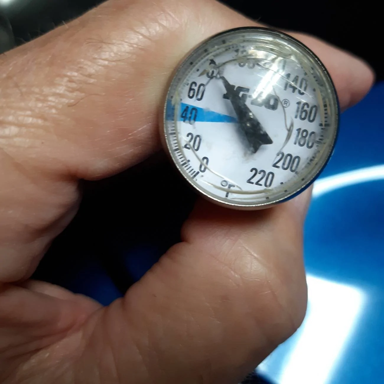

Here's my AC thermometer back from the days of R12 recommended temperature range was the Shaded area below 50° coming out of the vent. I bought this thermometer
at an auto parts store in the 70's
Ford Maverick Does the A/C in the 2024 Mav Lariat actually get cold? 20250607_171509
AC vent thermometer from the R-12 age
