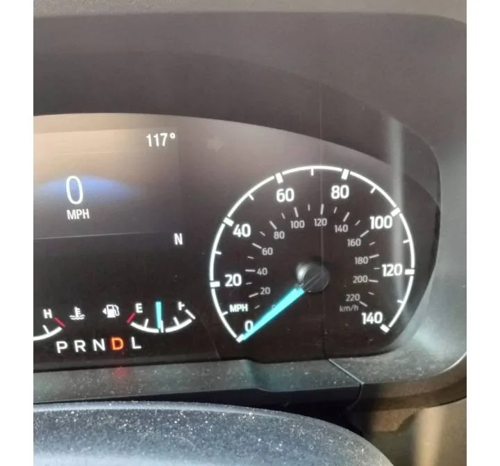

Nothing gets Ice cold since they got rid of R12 in cars and trucks.
That said, I live in the Mojave Desert not far from Death Valley and I have never had a problem with the air conditioner 23 hybrid keeping the interior cold.
Even at 117°+ that's at single digit humidity which makes a difference. The hybrid which I have has a different style of compressor than a traditional automotive compressor.
If it's humid and it doesn't seem like the interior is getting cold. You may want to check and make sure that your drain line is draining condensation. Unfortunately you have a splash shield underneath where the condensation would be dripping from. It's a little hard to verify that everything is draining properly. Without removing that splash shield.

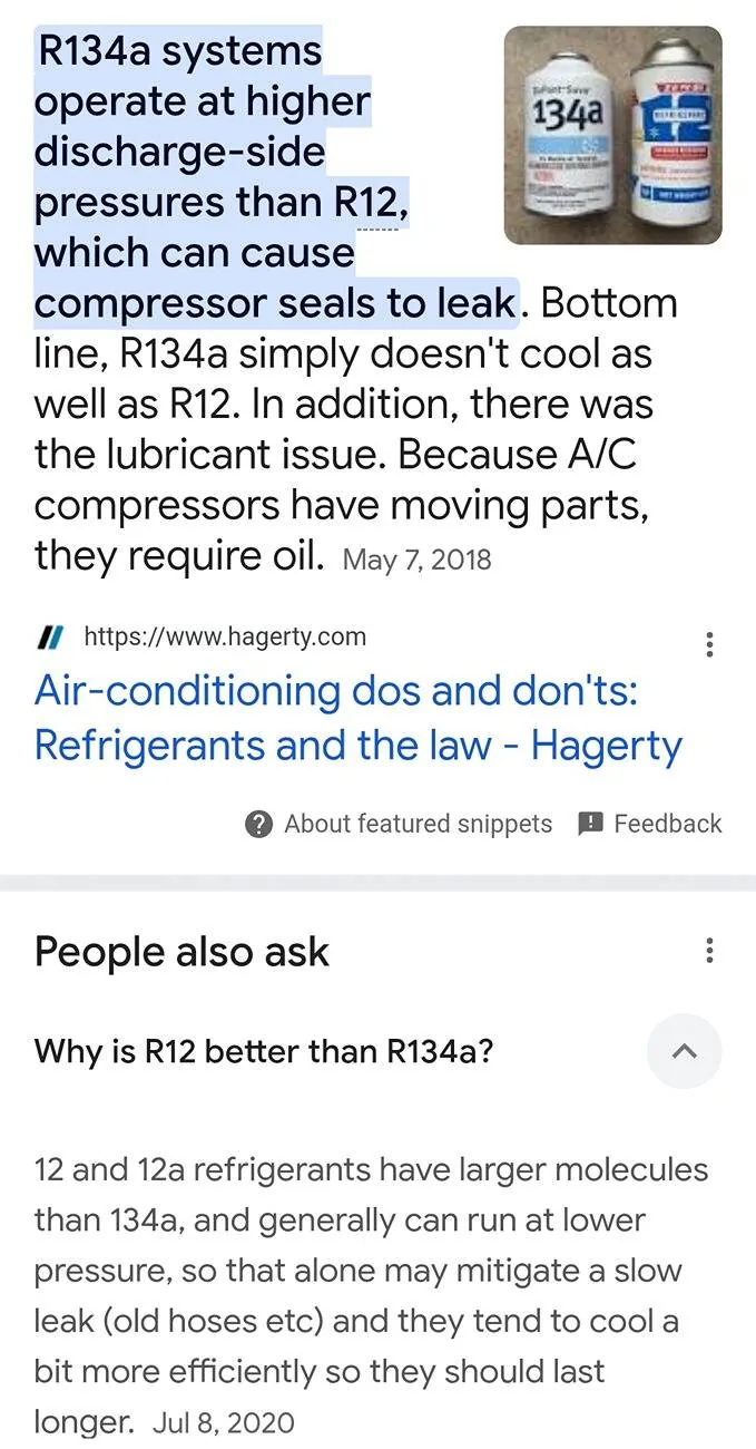

the early R134A ac units were atrocious.
But then they actually redesigned the heat exchangers, and a unit the same size can do a good job.
R134A has, what, 2/3 the heat transfer of R12? As I understand the solution, it was to have the coolant go through multiple paths (or a longer convoluted one?) instead of a single pass.
You can now even get retrofit exchangers for classic cars that "look right", but internally does the multi-path thing! [and as I understand it, all you have to do is swap that and thoroughly get the R12 out.]

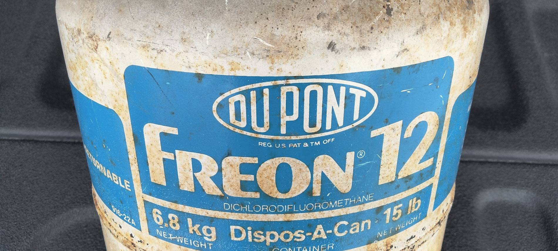

If I get a classic again.
Screw retrofitting the a/c to please some tree hugging nut as long as I have 14 lbs of R-12 left.

Just as I said, even in the 100's
