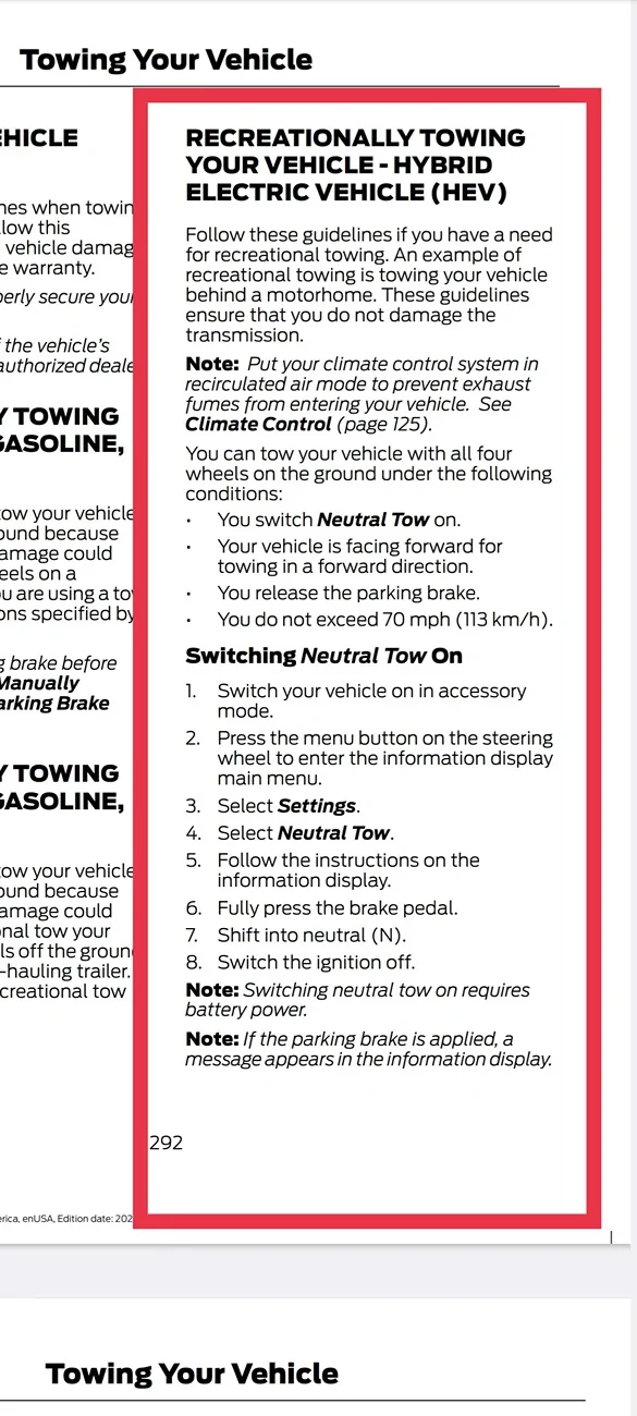

If your Maverick is a '23, it is NOT flat towable. There was a transmission change beginning in '25 that allows flat towing. Check your owners manual before spending any money to prep for flat towing. I'll be hooking up my '25 behind the RV to head out in two weeks or so.

Hybrid IS flat towable. I flat tow my 23 often.

Cool! I know there was a tranny change to -28 for '25. I'da got one earlier knowing this.

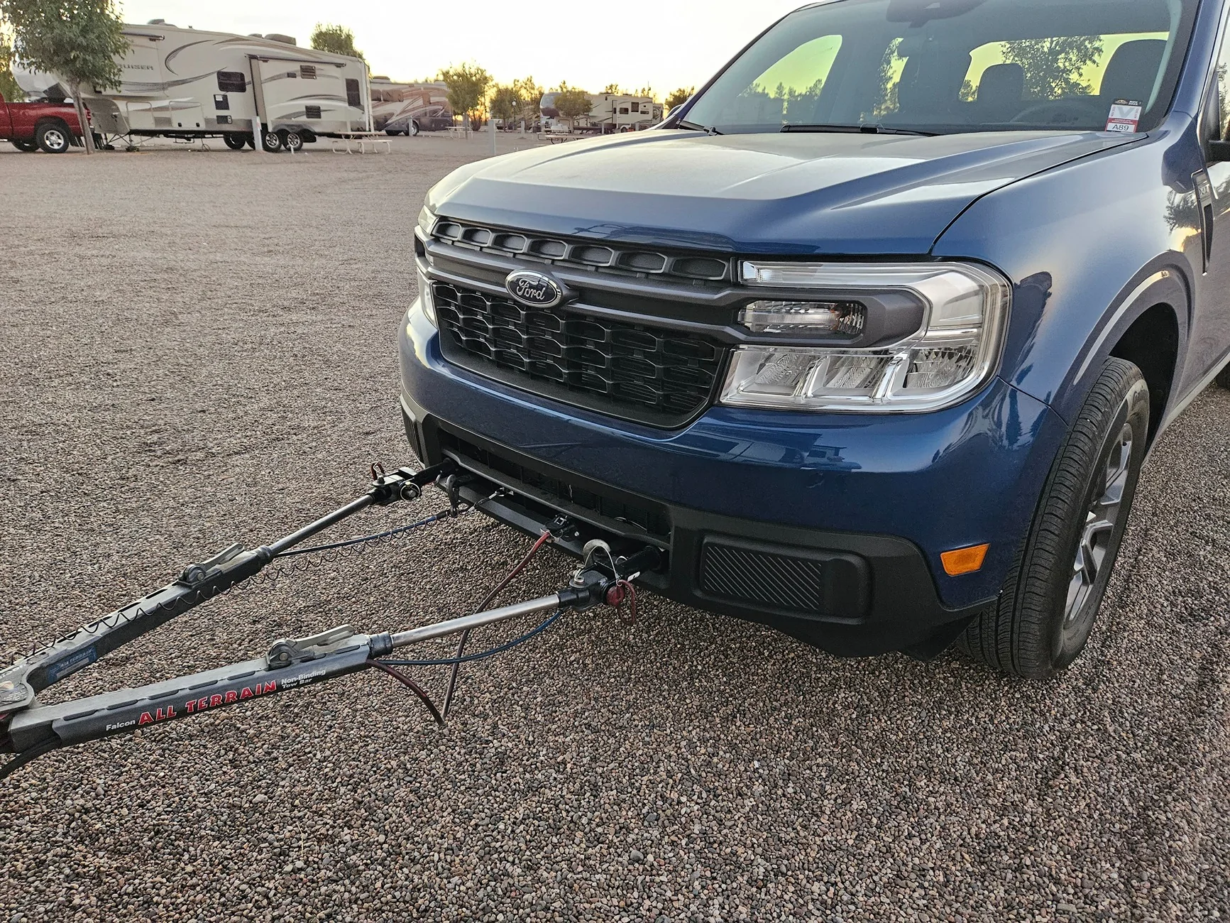

Ford Maverick Does flat towing add miles to the odometer? Maverick hooked up 01

No
