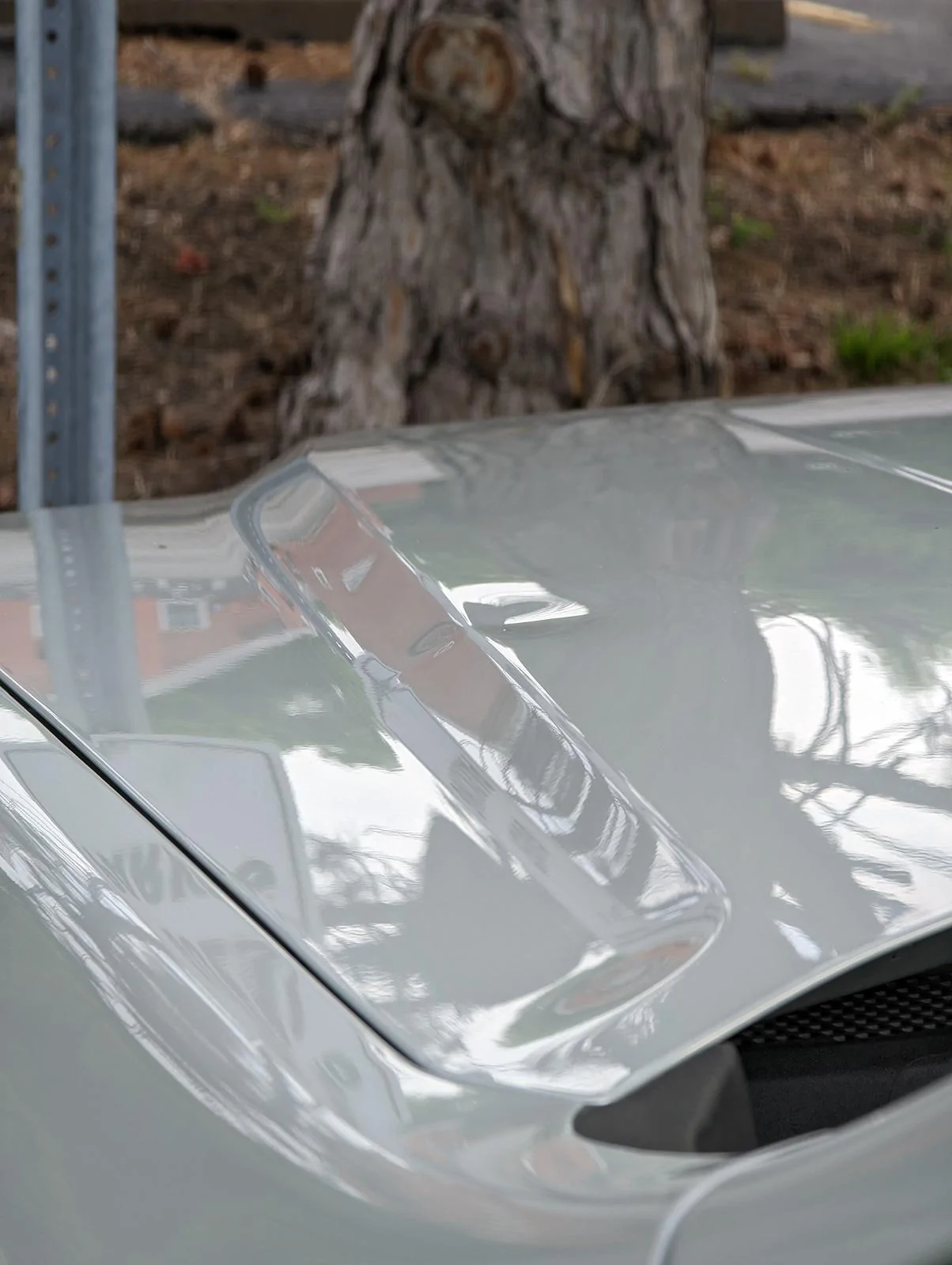

Let's see a pic of the dent. The Maverick hood isn't nearly flat, so if the dent is on or near any of the ridges it may not be repairable at all, and even if it is you want a pro to do it.
Ford dealership tech dented my hood a year ago leaning on it to look at a chip in the windshield. They tried PDR, it failed, they had to replace the whole hood.
