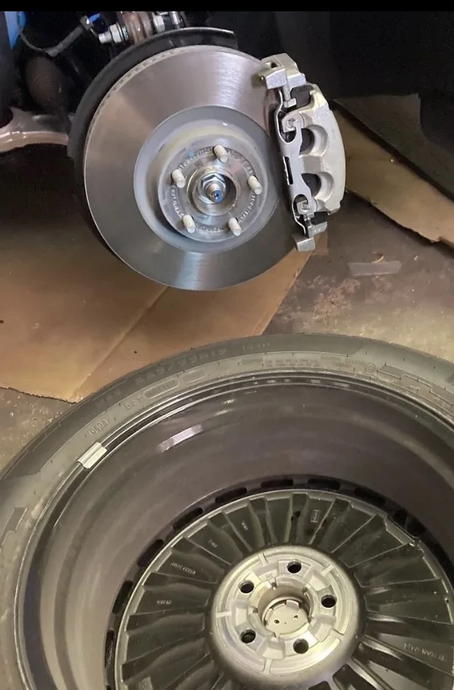

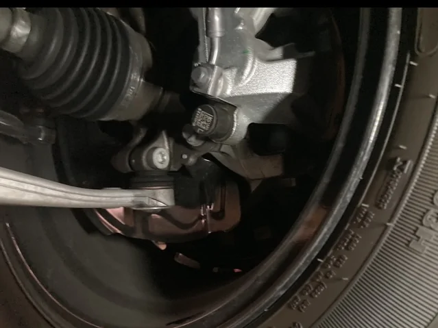

Had a loaner 26 Bronco Sport Outer Banks with puny brakes while my Lobo was in the shop last week. The BS stopped quicker. Caught me by surprise the first time I braked…
Thought I “bedded” in my brakes properly when new - now I’m not so sure!
edit…pics
Ford Maverick Do dual piston calipers made a difference? IMG_0602
Ford Maverick Do dual piston calipers made a difference? IMG_0603
