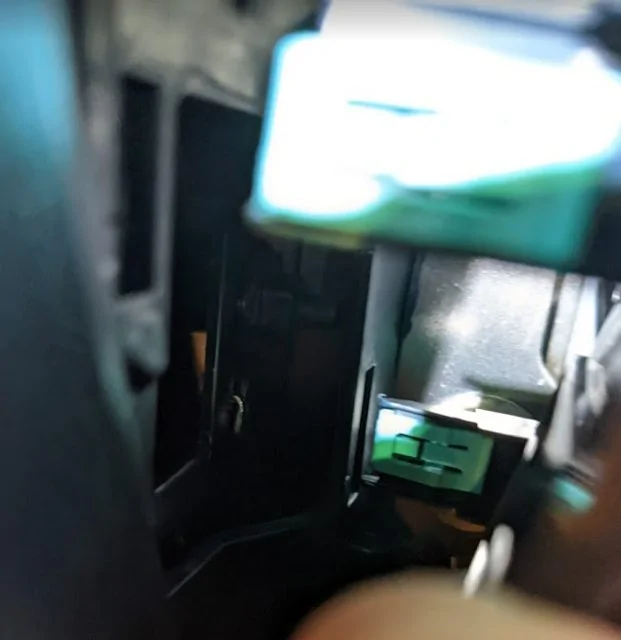

Panel in question:
Ford Maverick DIY writeup: Radar Detector / Dash Cam, etc install using BCM Fuse Box (Passenger Side Panel Replacement Tips) 7V7tMCpl

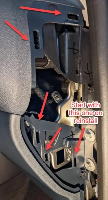

Here's all the mounting clip locations.
Ford Maverick DIY writeup: Radar Detector / Dash Cam, etc install using BCM Fuse Box (Passenger Side Panel Replacement Tips) eseIjzpl

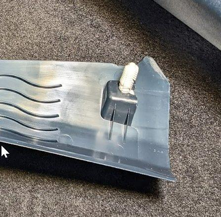

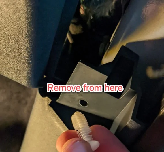

Plus one plug at the very bottom shown here:
Ford Maverick DIY writeup: Radar Detector / Dash Cam, etc install using BCM Fuse Box (Passenger Side Panel Replacement Tips) IhiqyIUl

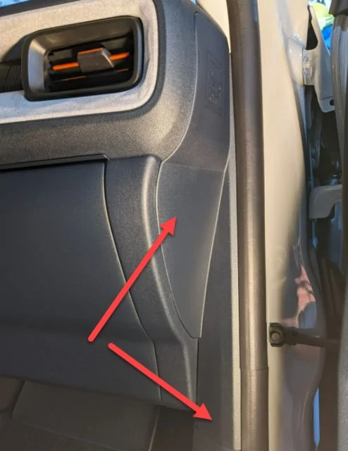

Here's the panel with the trim off with mouting locations noted:
Ford Maverick DIY writeup: Radar Detector / Dash Cam, etc install using BCM Fuse Box (Passenger Side Panel Replacement Tips) 3SF1j8zl

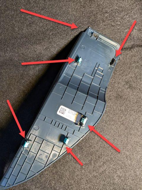

Note: this white plug will likely stay on the kickpanel mounting location on removal, remove it from the kick panel and slide it into it's slot for install later as shown here:
Ford Maverick DIY writeup: Radar Detector / Dash Cam, etc install using BCM Fuse Box (Passenger Side Panel Replacement Tips) 7j9h8gGl
The pronged end of the panel tools helps preserve the white fastener best you can.

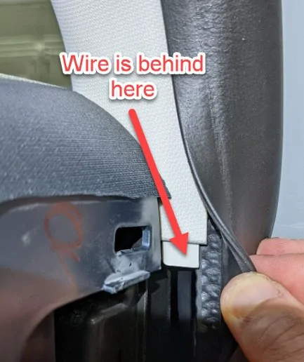

Make sure your wire(s) are behind the white panel here for proper fitment.
Ford Maverick DIY writeup: Radar Detector / Dash Cam, etc install using BCM Fuse Box (Passenger Side Panel Replacement Tips) fcUA3AIl

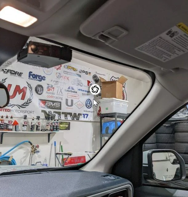

I didn't try, I have it running from passenger A-pillar along headliner edge. I need to buy the same little black clip I use in my Golf R to hold up the wire when the V1 isn't in the mav but had one laying around from a house audio install. Not a lot of room to hold the cable on newer headliners. My vette I can basically shove my hand under headliner.
