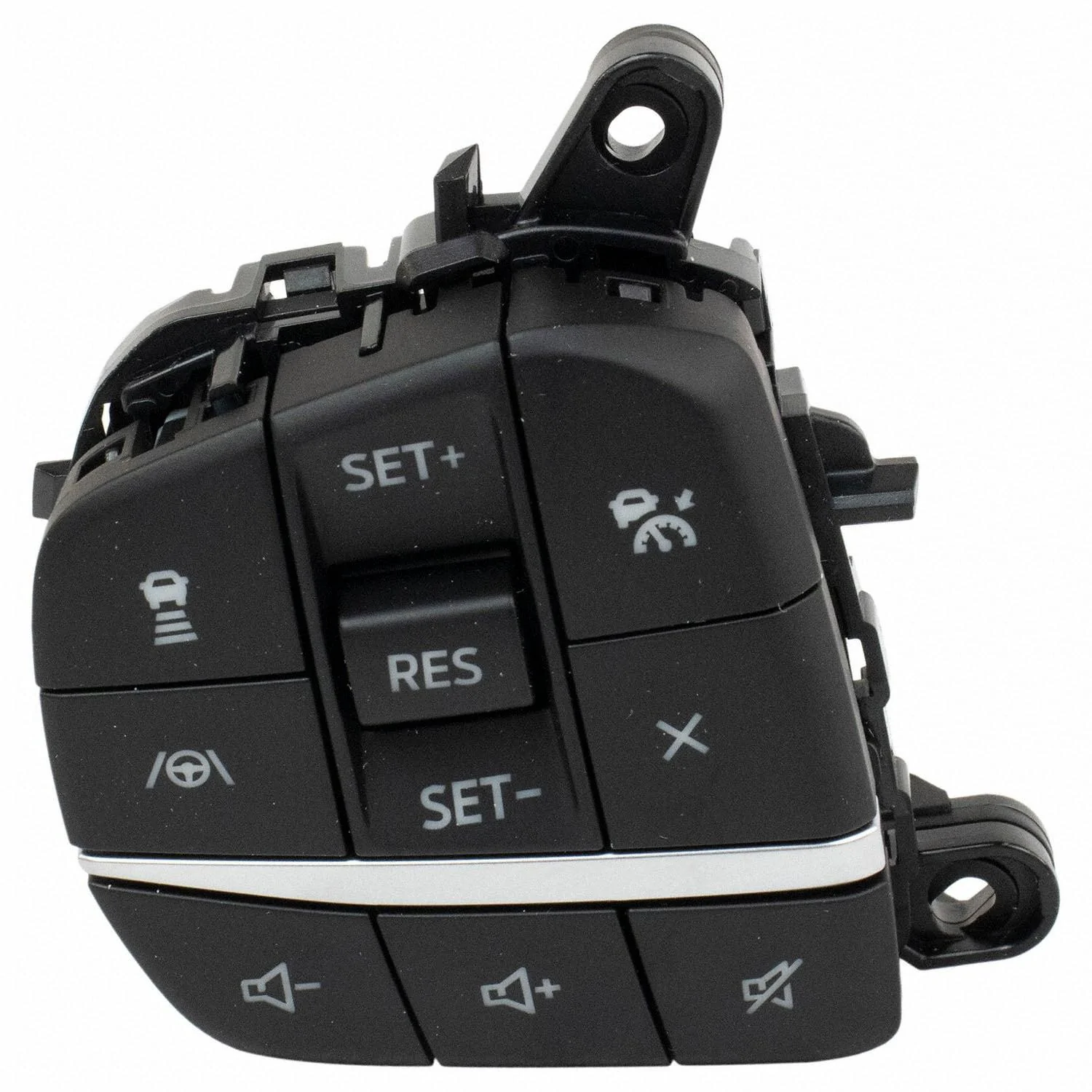

For adaptive cruise control this is what I know is needed so far.
For the steering wheel switches the LH and RH switches needed are
SW8585 for the LH switch for ACC
SW8576 for the RH switch
The SCCM code for the SW8585 / SW8576 combo should be
724-02-01 1290 6820 3088
That left hand switch should also work for regular cruise control with the adaptive and lane center buttons being disabled if you don't also put in the speed sensor in the front grille. If you haven't already done the CC upgrade this switch will cost more $30ish vs. $90ish dollars but will future proof you if you want to add in the speed sensor assembly later on to get ACC, Lane Center, evasive steering and the front intersection warning.
The picture is of SW8585 and the upper right button is the standard CC button, the adaptive and lane center buttons are on the left.

I wonder what the buttons look like with co-pilot 360 on an XL? Didn't CP-360 include lane correction?
Or is that different that lane centering?

On the left you mean. I wonder what the buttons look like with co-pilot 360 on an XL? Didn't CP-360 include lane correction?
Lane Keep is different from Lane Centering.
https://www.mavericktruckclub.com/forum/threads/how-good-is-the-copilot-360-is-it-worth-it.275/
Take a look at the dealer literature for Copilot posted by Granger Ford there.
The Lane Keep button is on the left steering wheel stalk with your turn signals.
