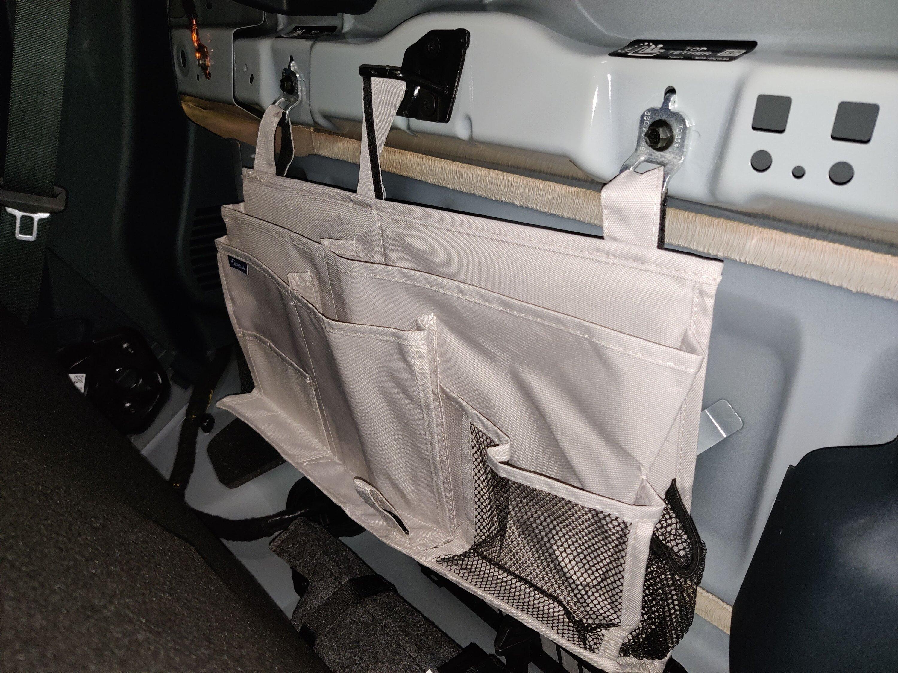

Thanks for the inspiration, Randy H. Here is mine:

So it doesn't get crushed whatever you put back there? Also, what sort of stuffs can you put back there using the pouch?

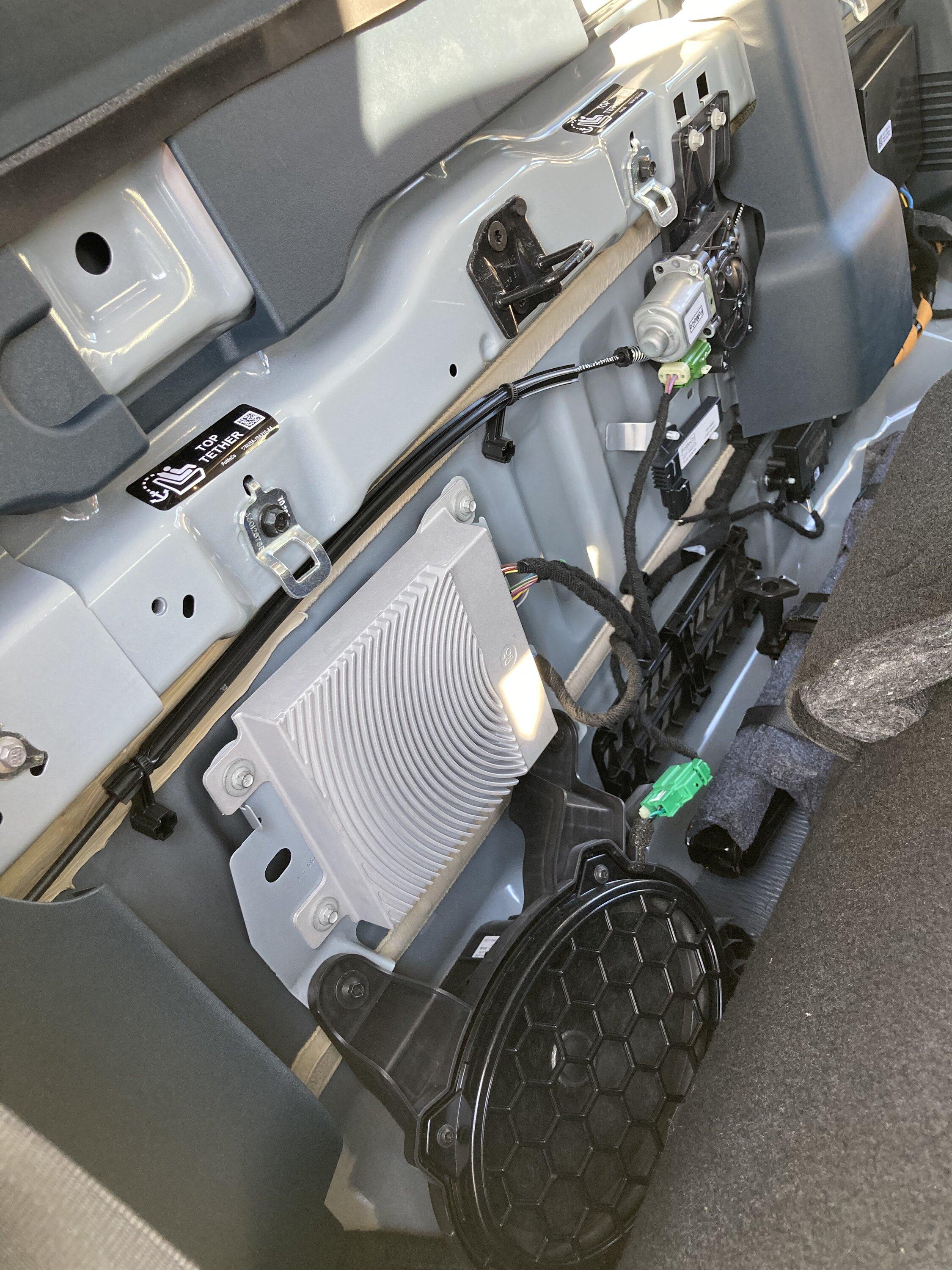

In another thread, imboden013 posted this image of the stock equipment behind his back seat (looks like he has the B&O sound system with the amp and subwoofer along with the motor for the sliding rear glass window). As long as the items are no deeper than the blue plastic cover to the right of that motor, it should be fine.
Not OP but using a similar setup (going to upgrade to what he posted.) Towels, Gloves, Tools, Emergency Parka's, Emergency TP Roll, Cables stowed in the corner, & Safety glasses to name a few things.
