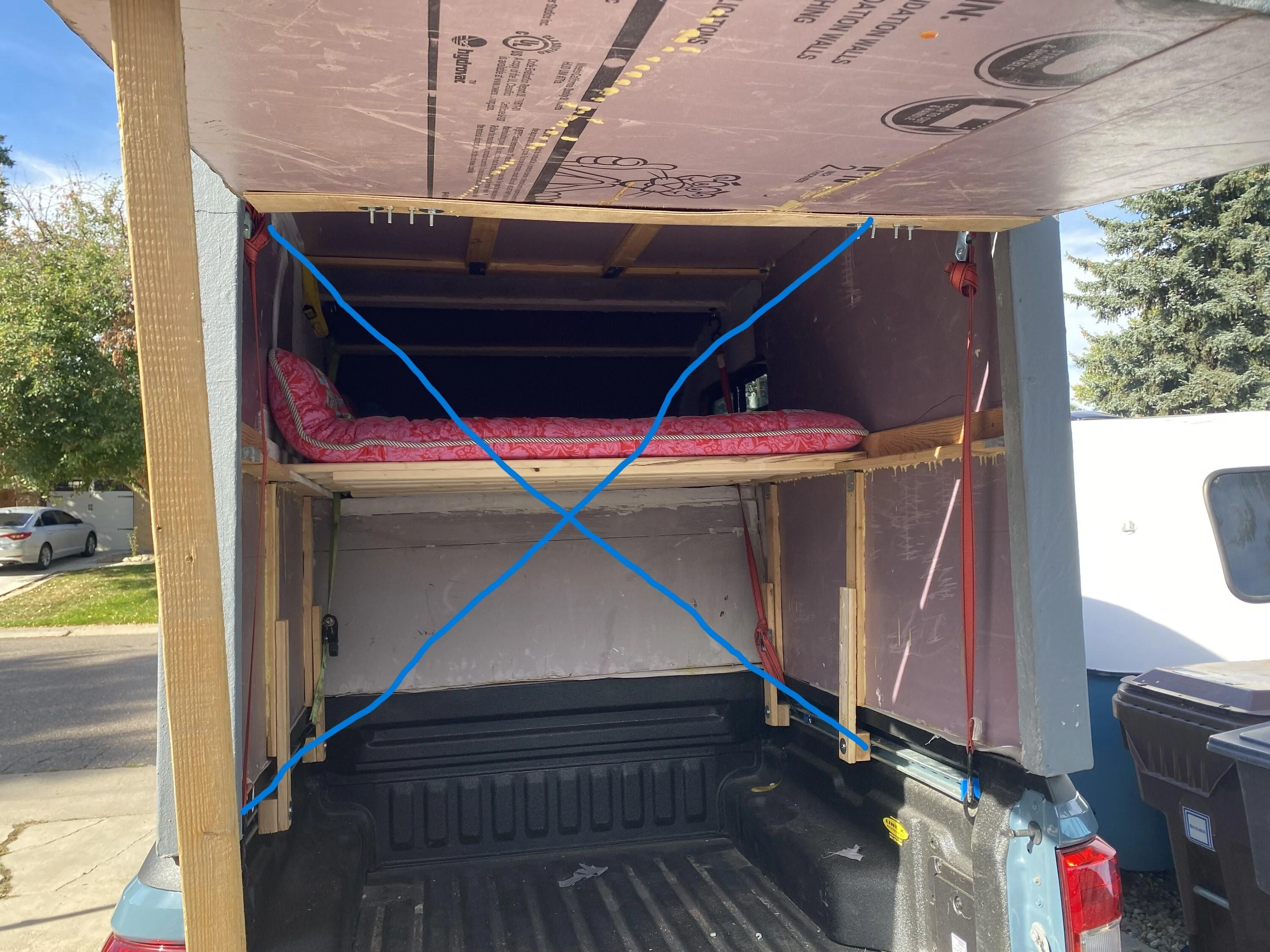

Team Maverick! Wanted to share my recent DIY camper build. Its 2” rigid foam insulation, wrapped in canvas and coated with Tightbond II (sometimes called Poor Man’s Fiberglass or PMF), then painted with rubberized roofing paint.
First time building with these materials. Learned a lot and a few things will do differently next time. I consider this a prototype and will likely build something different in the future, but for now, I’m satisfied. Took about 3 weeks, weighs around 150 pounds, cost around $300, gas mileage went down to 33 mpg (Hybrid) with mixed driving.
Full size bed, room for me, my bike and a few supplies. Not really meant for long camping trips, just quick overnights, and occasional solo bike trips.
2400 mile trip coming up in two weeks.
NOTE: Interior is unfinished for now. If I love it, and it works for me, I'll finish the interior with an automotive carpet.

I like it, but before I give it my unofficial stamp of DIY approval, I want some removable cross strapping/tie downs for crosswind resistance. Either that or a signed document that you will never ever drive on windy days. HAHA
haha! That's actually not a bad idea.
I do have 4 tie downs on each corner, plus 4 lower attachments to the bed rails.
