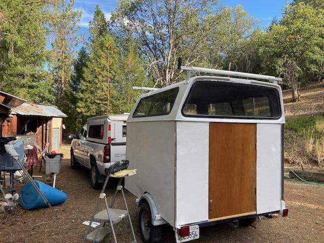

Love it! Thanks for the great post. After much thought, I went the trailer option for our Maverick. I used quarter ply, 2x3 framing, and EVERYTHING glued for added shear strength, with FRP (fiberglass reinforced plastic, 4x8 sheets from Home D.) laminated to the ply. I have a similar construction on our Silverado with a pop up roof from a solid toneu. Has held up well (after paint for UV) six years of trips to Baja. Foil backed foam inside our Maverick trailer, and made it so we can just stand, putting a (Silverado) shell on top of the 4' ply sides. I just couldn't see how to make the truck mounted unit sleepable without going cab over. Very interested to see how you handle the height in wind. Above mentioned just to give options to those considering similar. Again, great post, much appreciated.

Gfowkes, The frp take weather well (used for bathroom walls), need paint for UV protection, and add shear strength to the plywood. On our Silverado build, one sheet did both 2' sides, cheap, and easier than fiberglass. Easy to laminate to ply with trowel on adhesive.
Looks great! Smart idea.
