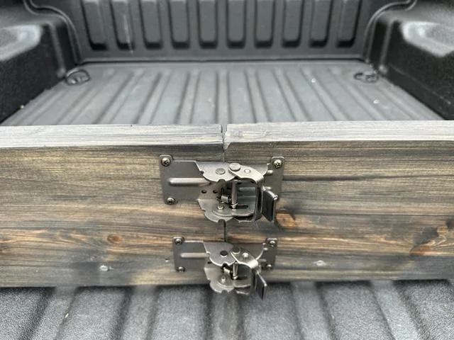

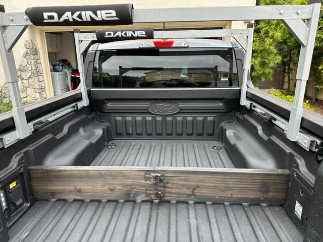

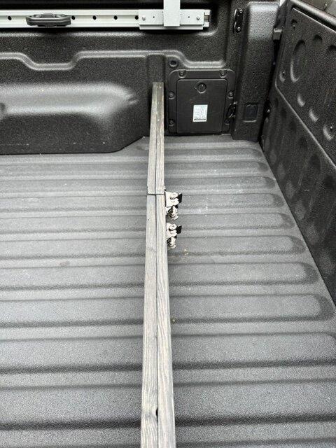

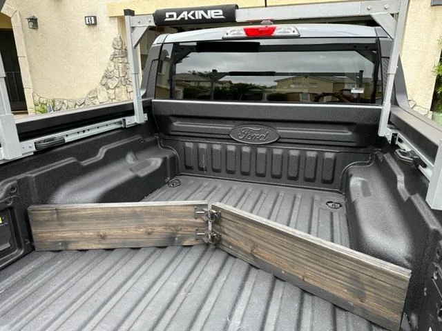

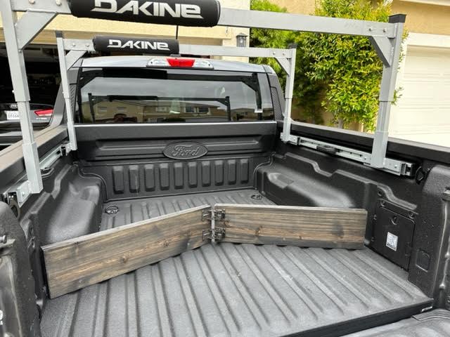

Since I installed my roof rack on the side rails, I can't slide up the divider. DIY bed divider with lockable hinges. I used a lighter weight 1x8 pine wood x2 cut to 54 1/4, lightly stained black. Cut in half and install lockable hinges for easy removal. Cheap hinge a pair for $12
Amazon link for the 180 degrees
https://www.amazon.com/Skelang-0°-90°-180°-Foldable-Extension-Workbench/dp/B0BN7YJT1V/ref=sr_1_1?crid=11FSI5AH5V52Z&keywords=Skelang+2+Pcs+Folding+Brakcet+0°-90°-180°&qid=1687957527&sprefix=skelang+2+pcs+folding+brakcet+0+-90+-180+,aps,111&sr=8-1
Does it fold flat to zero degrees like the hinge description says?

it’s nearly impossible to install/remove without being hinged.
🤓 I cut my straight divider a little short, it fits easily into slotted space, but is just a little difficult to get in place above slotted area. Just a little difficult. I have not heard a rattle but sometimes stuff small foam pieces on ends. Just in case.
