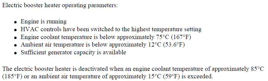

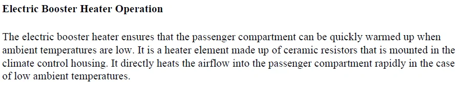

A Ford technician posted quotes from the Maverick Hybrid's service manual when this topic came up on the Maverick truck Reddit page, there very much is an electric heater. It works until the engine reaches operating temperature.
As for not feeling heat, even electric heater coils take time to warm up.
I'm thinking the "electric heater" mentioned might be something for the High Voltage battery... Not cabin heat.

It's for the cabin heat.
Well, it ain't-a-workin'.
At least mine isn't. This truck starts blowing warm air from the vents in about the same amount of driving time it took for my Subaru, which did not have supplemental resistance heat.
My Maverick is parked in an un-conditioned garage, so I don't want or need defrost, and can't stand it blowing in my face. Is MAX Defrost mode required for this electric heater to energize? Or will simply setting the thermostat & blower on HI turn on the resistance heat?

It says maximum heat, not max defrost. Just turn the temp dial to max.
Correct. ☝
Turn the thermostat to fully clockwise and it displays "HI" in the middle of a white circle on the infotainment screen. But no heat until I get at least a couple miles down the road, and about the same time/distance it took my Subaru to start blowing warm air from its heater vents. If my Mav has supplemental heat, it's not helping deliver heat any faster than my previous vehicle. And in the mean time, it's blasting COLD air out the floor vents. I seem to get heat faster if I just leave the HVAC completely off until the coolant temp gauge moves a little bit off the dead cold reading.

It's not fast, no doubt about that. I find hybrids (this is not my first) very slow to heat up compared to a conventional ICE vehicle. I think part of it comes down to how modern vehicles warm up, vs older ones. Newer vehicles use heat from exhaust to warm the engine and catalytic converter first, to get to an efficient operating temperature fast, then heat goes to the cabin. Now with the Maverick that is multiplied because it uses the heat exchanger to warm the coolant for the battery as well. I suspect that first blast of heat is from the electric heater as a result of how this truck works.
