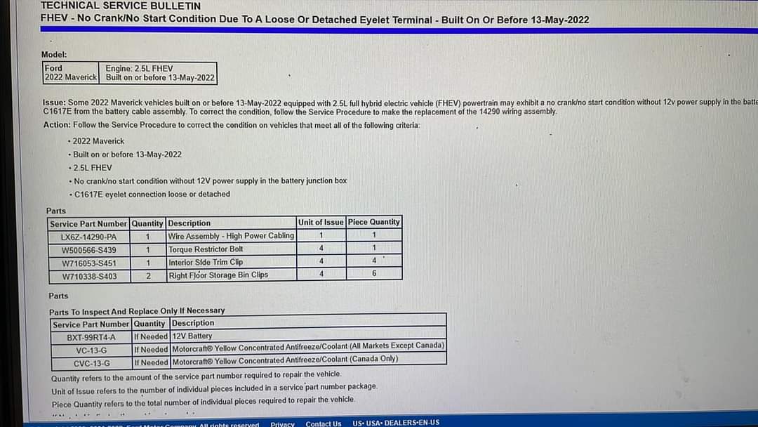

Glad they worked on yours even tho you haven’t had the problem. I’m not so fortunate.
I experienced one no-start episode that left me stranded in a parking lot for 2 hours. When the tow truck arrived, we tried to start my Mav hybrid one last time and it started and drove normally. Months later Ford issued tsb 22-2340 and also csp 22B39 for the no-start issue but they only covered build dates up to 13 May 22 and mine was built on 23 May 22 so Ford wouldn’t authorize the work on my truck. Although the problem hasn’t reoccurred, I worry when & where it will happen again. Ford customer service will not authorize the service for me because I fall outside the build date range.
Am I the only one with a no-start outside the approved dates?

Tried to take my truck in for the CSP on the wiring harness and it's been a month now, I can barely get the dealer to communicate. Scheduled the appointment, took my truck in a week later, they didn't order the part till 3 days after that. Didn't hear from them for 2 weeks called and neither the service department or parts department can tell me if they've ordered the part or find the ticket from my service.
